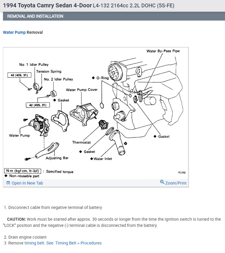

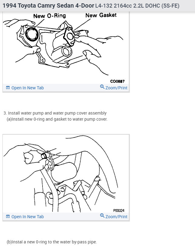

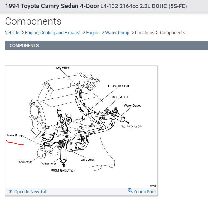

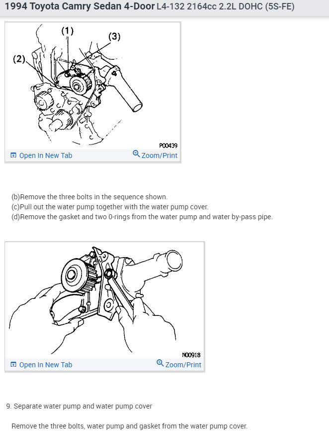

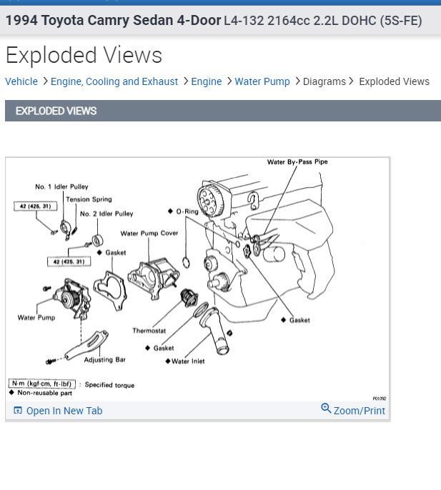

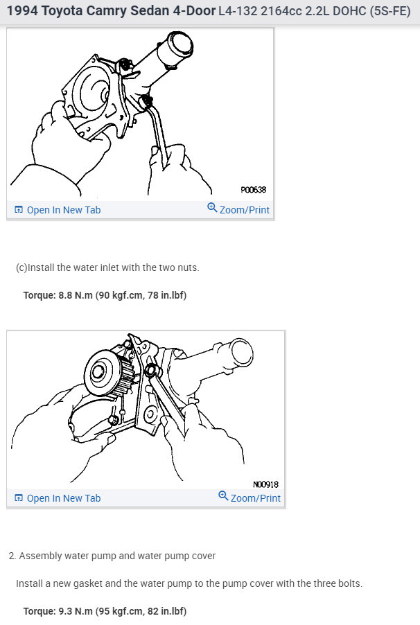

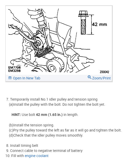

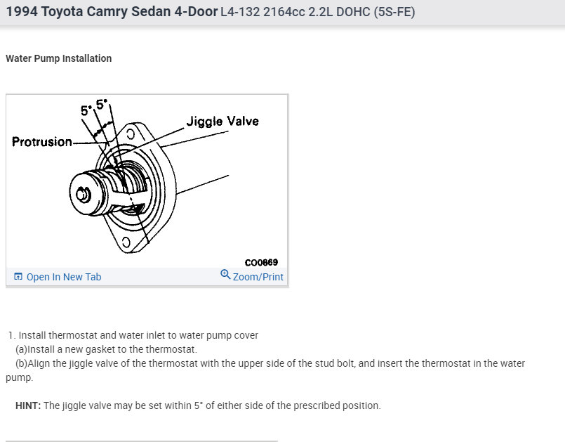

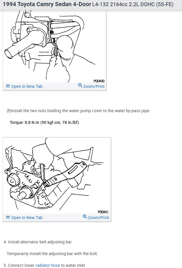

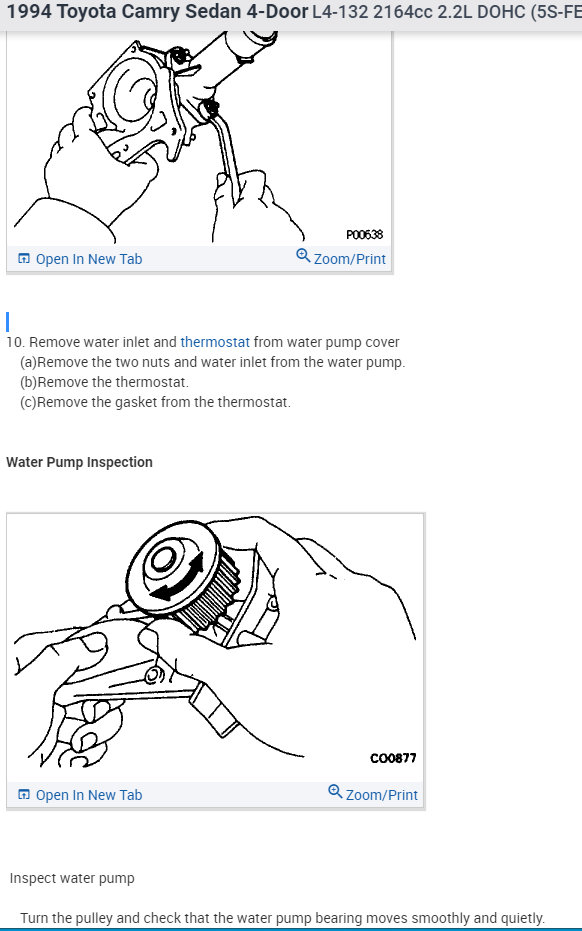

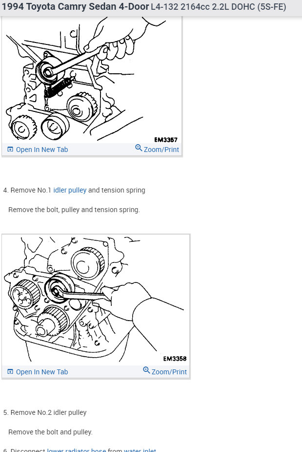

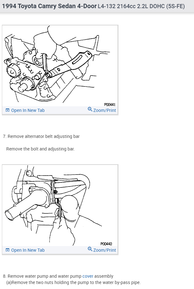

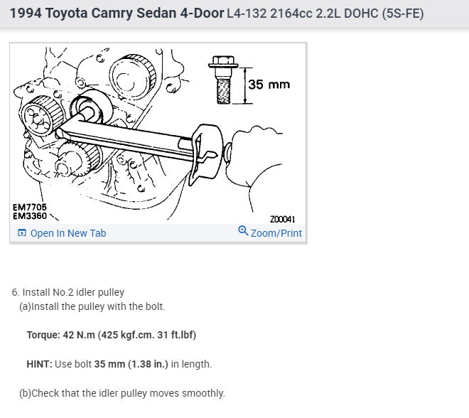

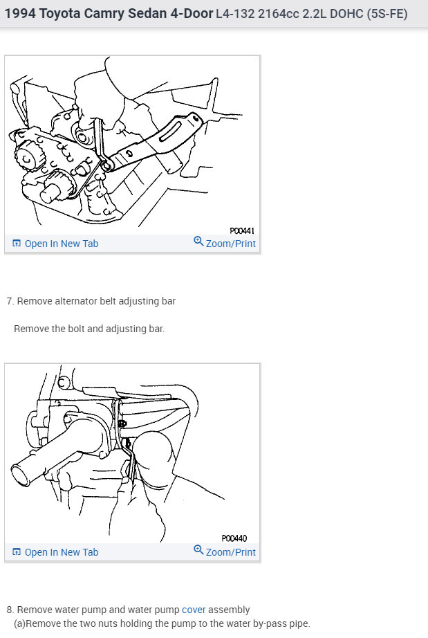

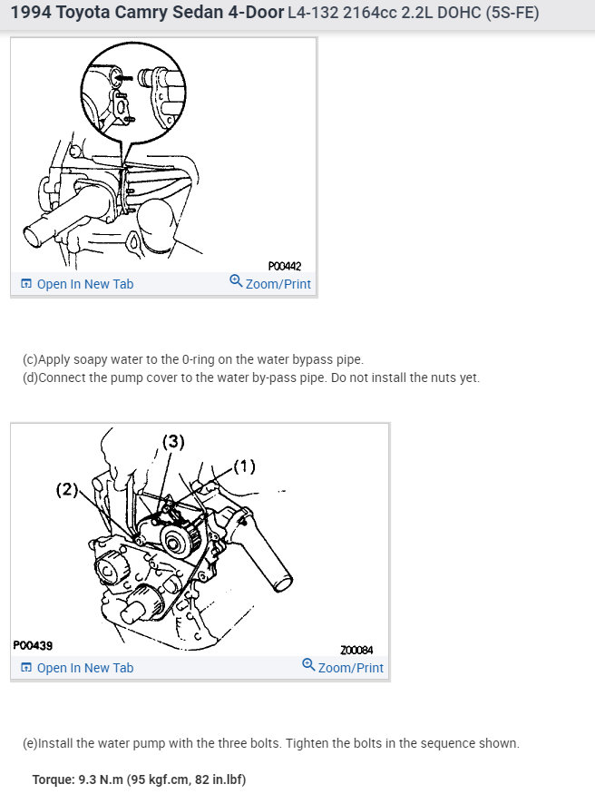

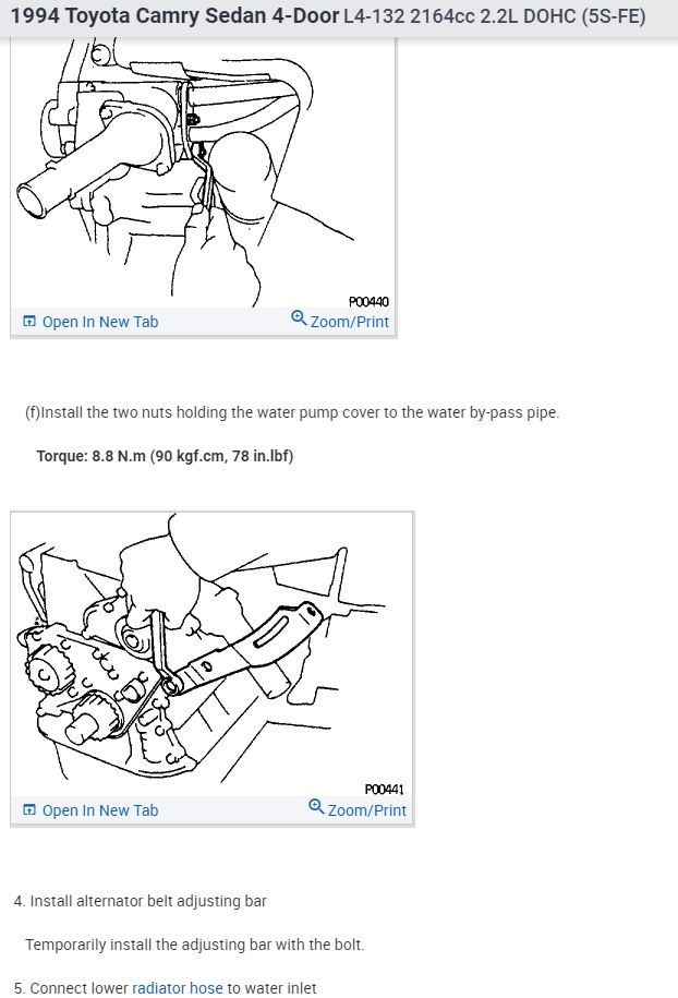

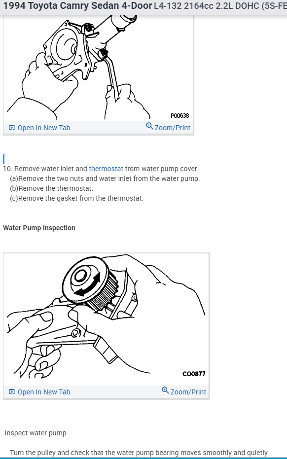

I need instructions on how to change the water pump on the car listed above.
Friday, January 7th, 2022 AT 9:28 AM
SQM
MECHANIC
6,383 POSTS
Always work on the cooling system when the engine is cool and be sure to drain the coolant before getting started.
I have attached the complete water pump replacement procedure below.
https://www.2carpros.com/articles/water-pump-replacement
Images (Click to make bigger)
