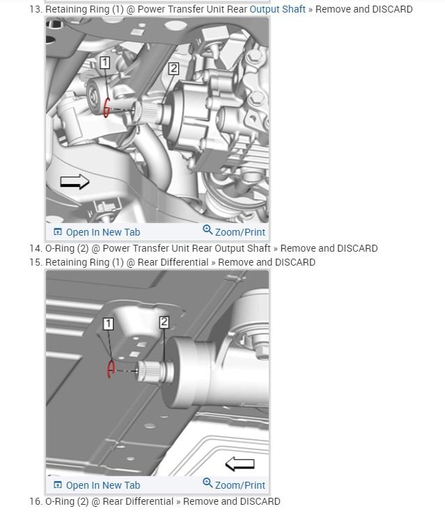

I need to replace the center support bearing on my vehicel, but I cannot seem to find a solid part number for it.

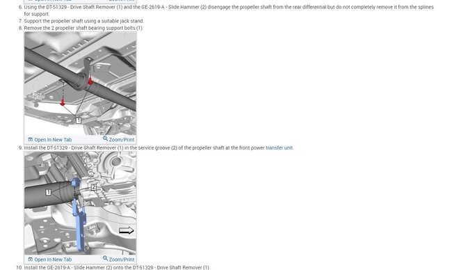

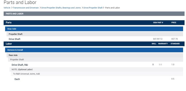

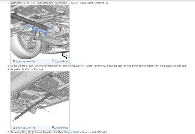

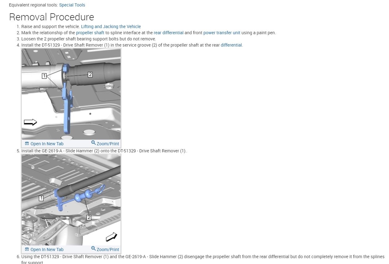

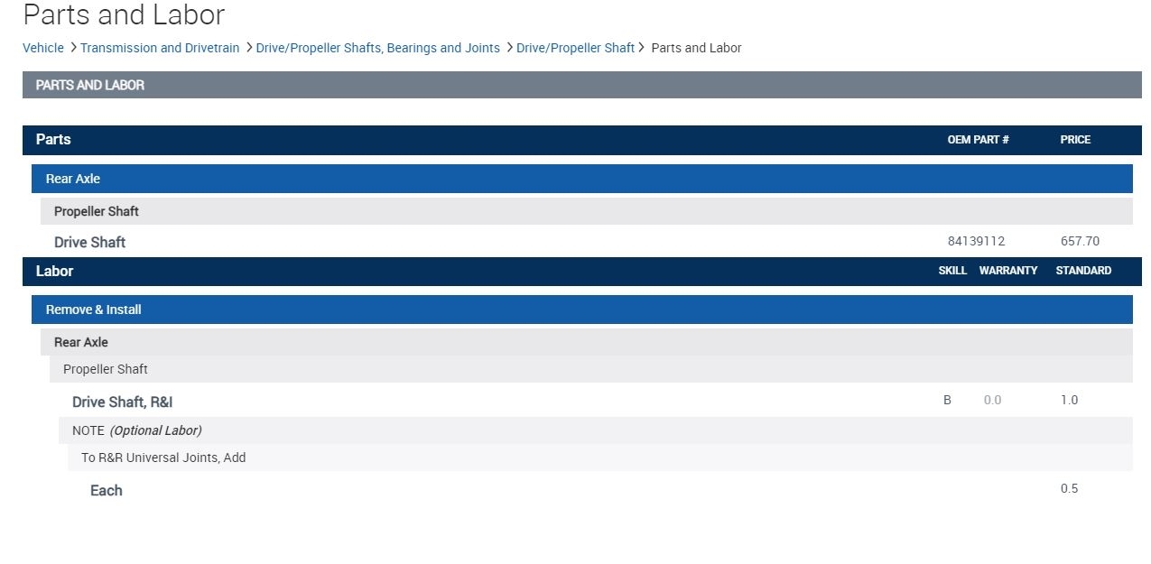

Good morning,
The center support is not available by itself. If the center support is bad, the driveshaft must be replaced as an assembly.
https://www.2carpros.com/articles/how-to-remove-a-drive-shaft
I attached the procedure below for you to view. Rock auto had the driveshaft but is out of stock for $670.00.
