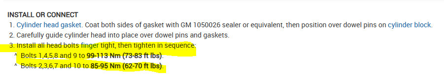

Long bolts 73 to 83 short bolts 62 to 70. If so, what increments should I use?

Tightening in Increments:
Long bolts (73 to 83 ft-lbs): Tighten in 3 stages.
First stage: 25 ft-lbs
Second stage: 50 ft-lbs
Final stage: 73 to 83 ft-lbs (to spec)
Short bolts (62 to 70 ft-lbs): Tighten in 3 stages.
First stage: 20 ft-lbs
Second stage: 40 ft-lbs
Final stage: 62 to 70 ft-lbs (to spec)
Let us know if you need anything else.

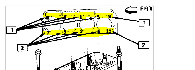

In this pattern, right?

That is correct.

I torqued my head bolts to these specs and afterwards I got ahold of the Haynes manual for my cavalier it says 43 and 46 and an extra 90 degrees. Will my head gasket be ok at 65 and 75 or should I loosen and retorque?
Sunday, December 8th, 2024 AT 7:13 PM
KEN L
  • MASTER CERTIFIED MECHANIC
  • 54,272 POSTS
I would leave it because this is how they did the head bolts when the engine was built. Did they all tighten okay?

Do I remove head bolts in same pattern to remove as installed?
Tuesday, April 29th, 2025 AT 12:09 PM (Merged)
STEVE W.
  • 15,314 POSTS
It's not a requirement for removal. The pattern is devised so that the gasket is compressed evenly during the installation. By starting in the middle and working outwards the materials will settle in evenly. If you were to randomly tighten the bolts it's possible that the gasket could create a small "wrinkle" where two areas of pressure converge and possibly leak or cause a failure point. However during removal that isn't really an issue.

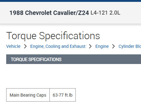

I need crank bolt torque specs and head bolt tightening sequence.
  • 110,176 POSTS
I was able to find only one picture with the head bolt sequence. I attached it. I also attached its torque specifications because there are two different specs for different bolts.
The last picture is the main crankshaft bearing torque. I believe that is what you were looking for. If it is wrong, let me know.
