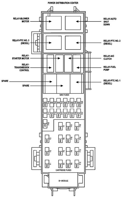

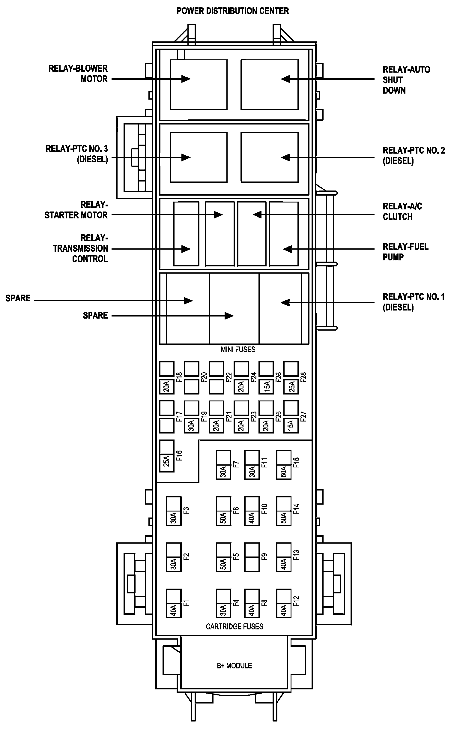

Now keep in mind im not a jeep guy but I just remembered this jeep thing from years ago Ive seen this before was wondering if jeep was still using the auto shut down relay ?
And sure enough they still are id definatly check that ..its the classic sign this could be failing on jeeps .. so at least check it ..
Click the diagram below good luck
Aug 26, 2025 at 10:14 AM
