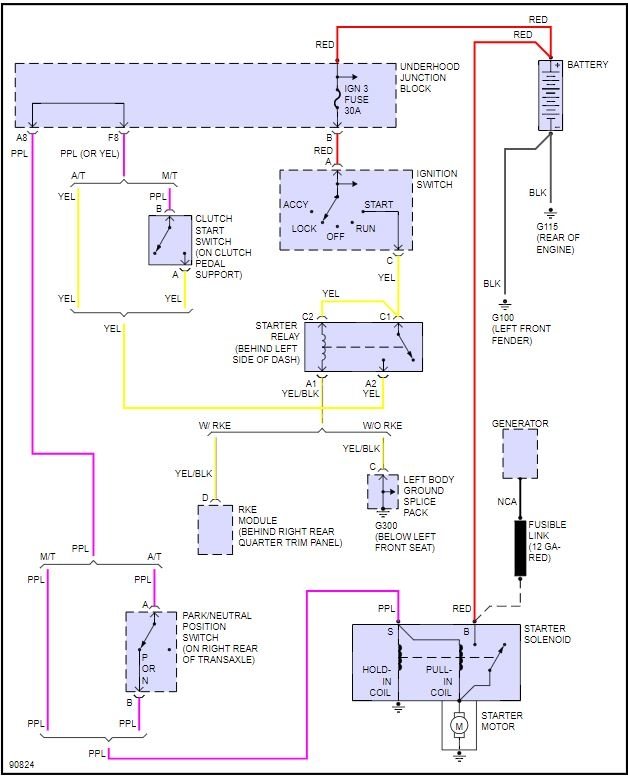

Car will not start. No sound when I turn the ignition over. No power.
Tuesday, February 13th, 2018 AT 9:07 PM
PATENTED_REPAIR_PRO
MECHANIC
1,853 POSTS
To begin with, check the IGN 3 fuse in the underhood junction box. This guide can help with the fuse location in the diagrams below.
