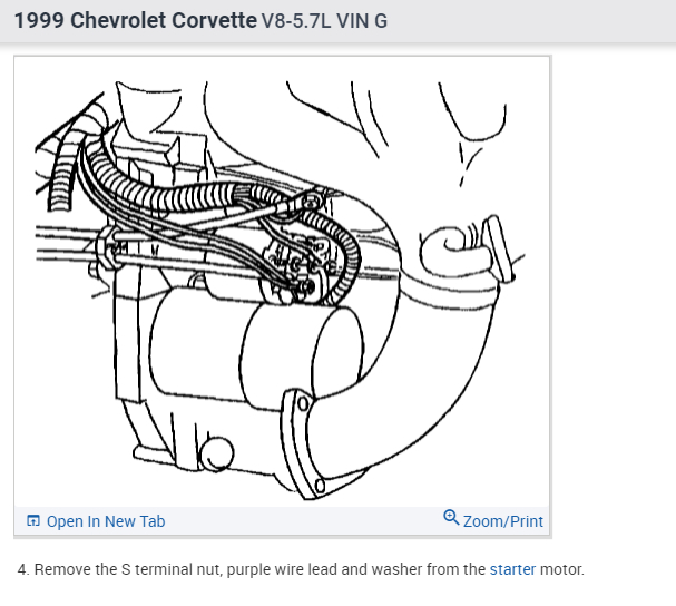

Hello, have you checked that you're getting power down to the starter motor? Theres 2 wires to the starter motor, You should get battery voltage (12volts) on both. The Red wire will have power all the time because its a direct feed from the battery and the Purple wire is the Ignition Switch power.
If you are getting 12volts on both of those wires while cranking then you just have a bad starter. The starter motors are just remanufactured starters. Sometimes we just get new parts that are bad. Its been happening alot more lately.

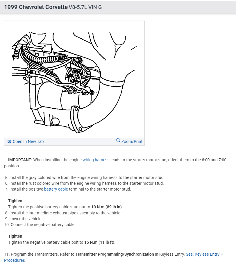

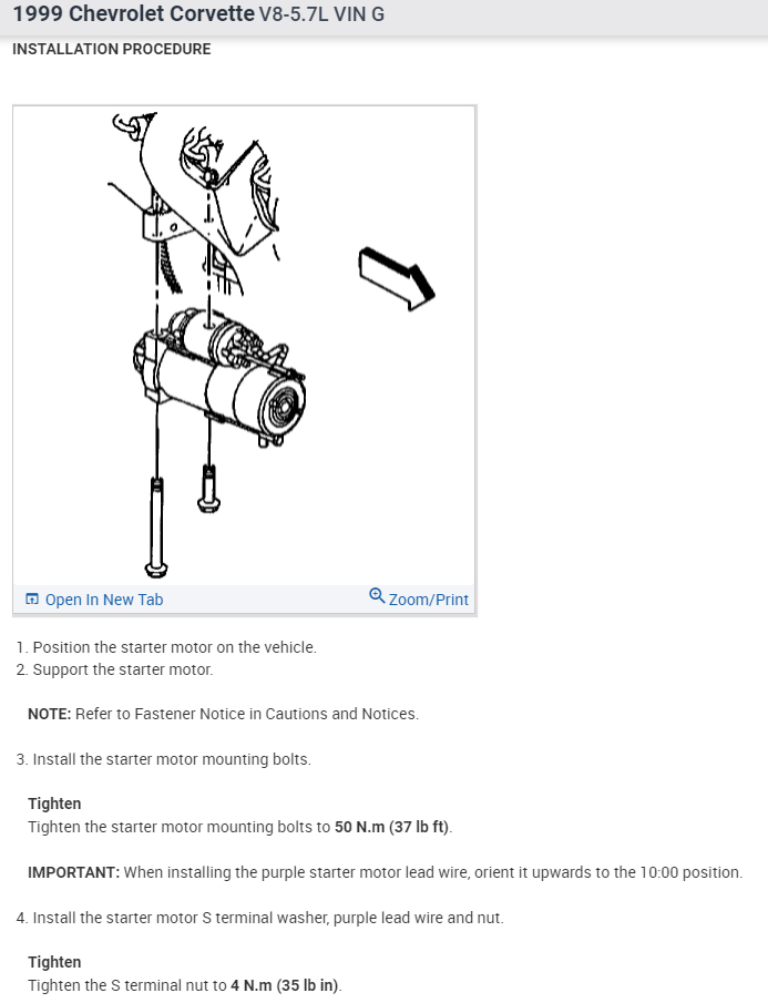

Here is a helpful guide on starter issues:
I have attached the starter replacement procedure below for your reference.

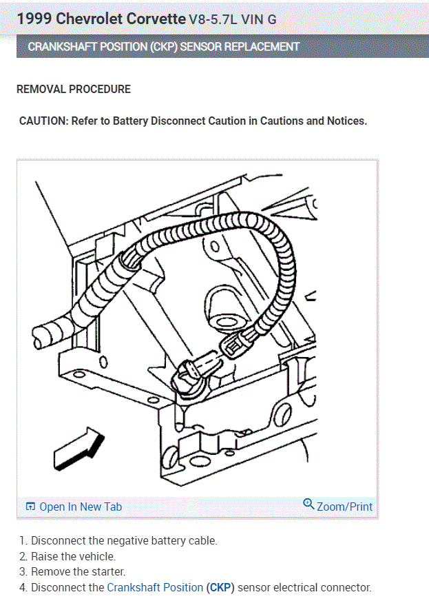

When trying to start the car it well trun over but no spark when starting

  • 110,176 POSTS

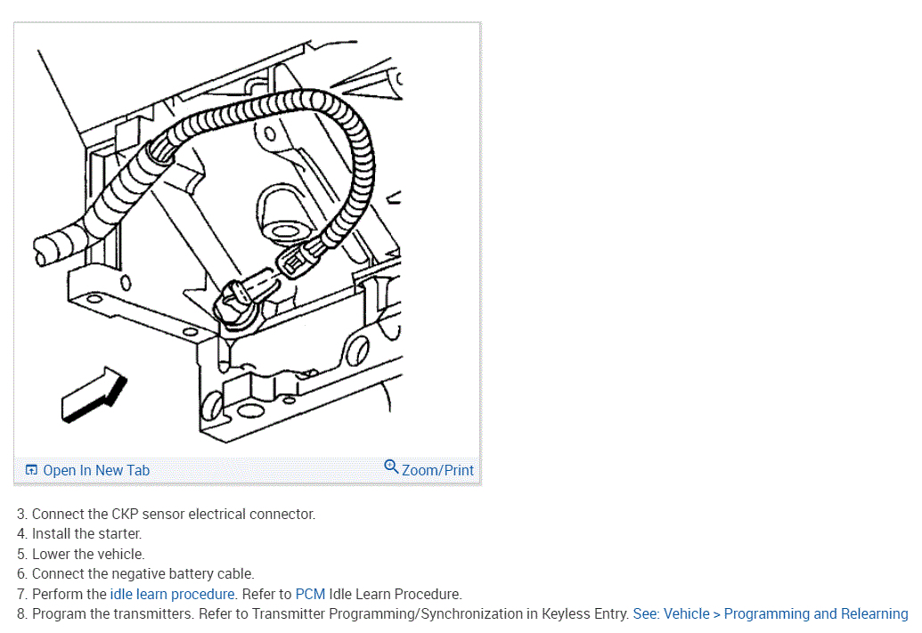

The most common cause of a no spark condition is a faulty crankshaft position sensor. If you have a live data scan tool, connect it and crank the engine. Do you receive an RPM signal? If you don't, suspect the sensor. Take a look through this link. It reviews common symptoms.
Start with this. Also, I attached the directions below specific to your vehicle for replacement. I hope this helps.
Let me know if you have other questions and what you find.
