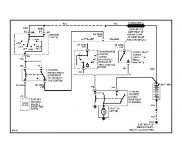

Car has sat for 1 yr., (Ran good before it sat). Had lost key and had new one made from dealer. Batt. Is new, Turn key and dash lights up. Everything looks tobe working (electrical) and I can hear the fuel pump come on, Try to start and all I can hear is a little click and it does not sound like its from the starter.? Thanks for any help, Ted.
Monday, December 3rd, 2018 AT 5:19 PM (Merged)
DOCFIXIT
  • 18,828 POSTS
Look for starter relay under left side dash turn key is this what you hear?If check Purple wire does it get voltage when key is turned to start? If not check black/yellow for ground. If no ground problem with CCM mid dash. If purple gets voltage then problem with solenoid/starter.

Sorry it took so long to reply, I'm out of town a lot for work. So here is what I know so far. The clicking sound is coming from down by the shifter. (I've try it in park and neutral). On the dash there is the word security lit up, when the door is closed it blinks, when I turn the key it stays lit.

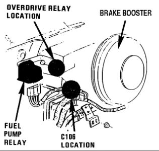

I need to know where the fuel pump relay is.
  • 75,992 POSTS
1985 Chevrolet Corvette V8-350 5.7L
FUEL PUMP RELAY
RH Front Of Dash.
https://www.2carpros.com/forum/automotive_pictures/12900_fprc_1.jpg
The Fuel Pump Relay is located in the Engine Compartment, RH side of Brake Booster, mounted to the Firewall.
