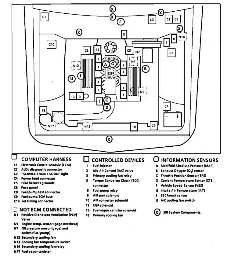

Every sensor and fuel pump and new injectors has been replaced? Unplug map sensor it runs fine. Have replaced two to three sensors?

Does the car have good power when the sensor is unplugged? You could have a plugged catalytic converter. lets run the codes to see what comes up. here is a guide to help you:
https://www.2carpros.com/articles/buick-cadillac-chevy-gmc-oldsmobile-pontiac-gm-1983-1995-obd1-code-definitions-and-retrieval-method

It sounds like the PCM is out I would get a used/rebuilt one and plug it in to see what happens here is the location and instructions below.
NOTE: Service of the ECM should normally consist of ECM or MEM-CAL replacement.
When replacing a production Computer with a service Computer, transfer the broadcast code and production number from the production unit to the service unit. Also during replacement, the PROM, CALPACK, and if equipped, the MEMCAL must be removed from the Computer being replaced and transferred to the new unit. Refer to PROM, CALPACK and MEMCAL in this section for replacement procedures.
