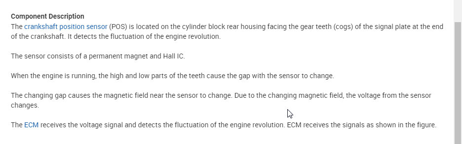

A crank sensor will prevent the start because it is needed to time the injectors and plugs.

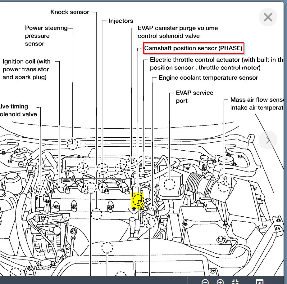

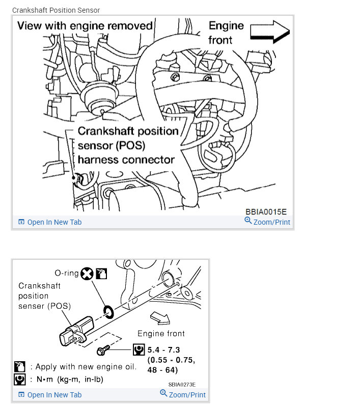

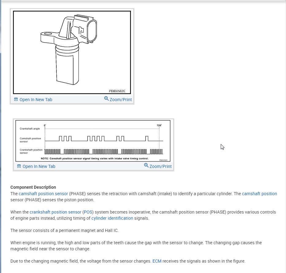

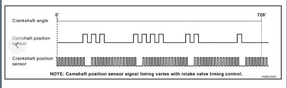

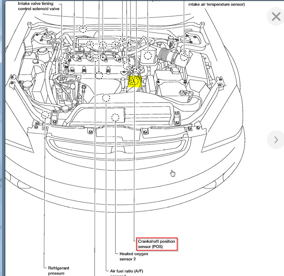

The cam sensor and crank sensor are different but it appears they may be the same actual sensor or the same part number.

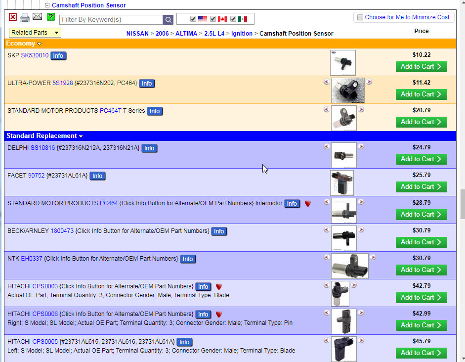

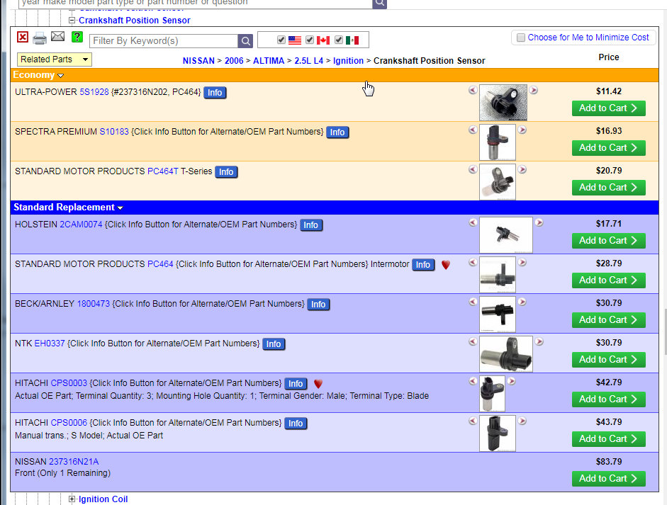

Here is a common parts website that should help. Screen shots below of all this info and of the website. One of the cam sensor and the other of the crank sensor.
https://www.rockauto.com/en/catalog/nissan,2006,altima,2.5l+l4,1432235,ignition,crankshaft+position+sensor,7196

I have a few questions because I feel you know what you're talking about and I feel that you won't steer me wrong but. I brought my car to the dealership a few months back (November 2019). They gave me the OEM 23731-6N21A Crankshaft Position Sensor. They stated that I needed 2 of these. The price was outrageous ($240.00 tax included). My question is, does it matter the OEM or not?
Also, on the RockAuto website, does it matter which is used from the Ecomony and Standard Replacement?

As for what sensor, the OEM is the best because it was produced specifically for this vehicle from the original specifications made by the designers. All aftermarket sensors are called recastings. Meaning they took the original and made a copy of it which means they could get something wrong. Think of it like trying to copy a well known painting. It may look the same but it is not the original.
All this to say, just because it is not an OEM part, doesn't mean it is no good. I use aftermarket parts all the time and have good luck and not so good luck with them. Unfortunately, there is no guarantee with any of the parts you buy.
The way I look at it is I always evaluate cost vs, easy of replacement. If I have to take the engine apart to replace the sensor then I only want to do it once so I get the best quality part I can. However, if it is easy to replace, I will get the cheapest because if it fails I just swap it out.
As for Rock Auto, the standard part is considered an OEM replacement. The economy is normally the cheaper parts.

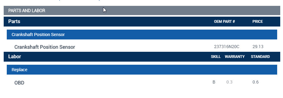

Yeah. That is parts and labor but still pretty pricey. Fingers are crossed. Let us know what happens. Thanks
