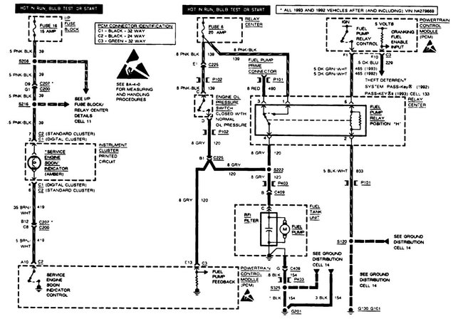

Fuel lines a few months old, fuel pump works fine, not purge valve or solenoid canister. Fuel injectors are clean and working fine. Alternator is fine. The car just stalls sporadically and after it cuts off it restarts again and is fine until it happens again. My mechanic at a loss as well as no codes come up on the computer and it otherwise drives perfectly. I'm thinking possibly the computer itself is faulty or that a ground wire is bad. I'm at my wit's end and and am eager for guidance. Which grounds should be checked first? If the computer is bad would there not be a code that would show up on scanner? Opinions? Thank you fellas.

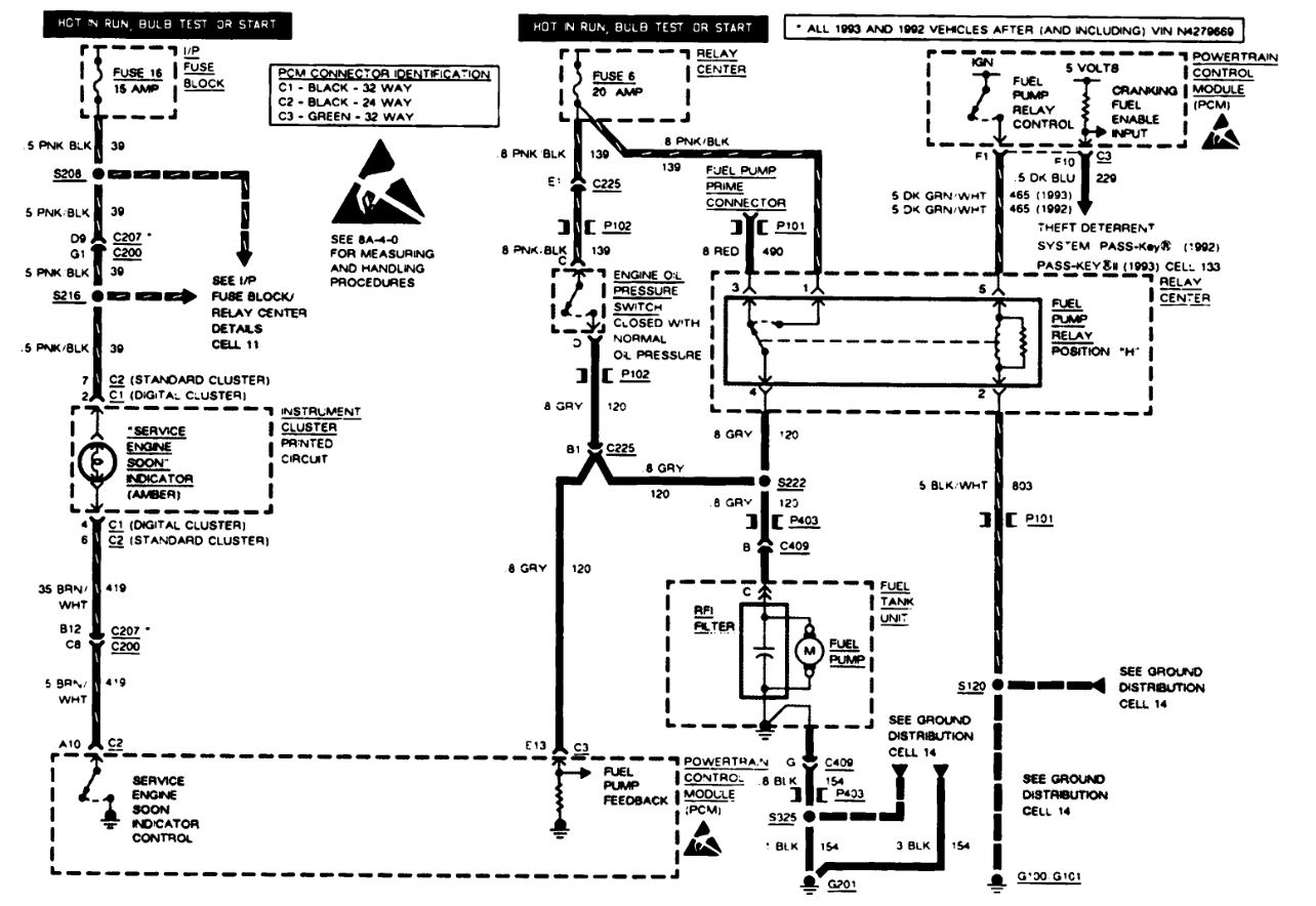

Okay, so it takes 3 tries turning it over to start. Try this if you can get it to shut down. Turn the key on, but not to start, just to on. Do that two or three times. Now try to start it. If it now starts up the issue is likely a bad oil pressure switch or intermittent connection to it. The reason I say that is that the system on that car works a bit different than modern cars. The pump relay on it only works to prime the fuel system, then shuts off. You crank the engine over and it primes the system, the engine starts, the oil pressure triggers the switch which then powers the pump on. A quick way to verify that as being the problem is to try the key test to start it, then find the red fuel pump prime connector under the hood. Now use a 20 amp fused jumper lead to jump power from a keyed battery feed like fuse 6 to that fuel pump prime circuit. That will bypass the relay and the oil pressure switch. If the car now runs fine the pressure switch or the connector on it is likely the problem. This is a common thing on them as the pump power goes through that switch and they have a bad habit of leaking inside the switch. It was one of the reasons why the later vehicles used a different safety system to shut off the fuel in an accident. The idea behind that switch was if the engine was shut off or if it lost oil pressure like the car flipped over, it shut off the fuel pump.

Thank you. When it happens again I will try that and let you know what happens. I appreciate it.
