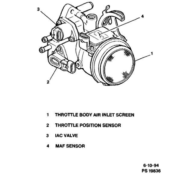

Good evening,
The first thing I would do is to clean the throttle body. carbon build up will cause this issue.
https://www.2carpros.com/articles/how-a-throttle-body-works
If it still does it then it may be the idle air control motor as it is what controls the idle speed.
Beyond that the only other thing I can think of is the EGR valve not closing fast enough and it stalls from it being open

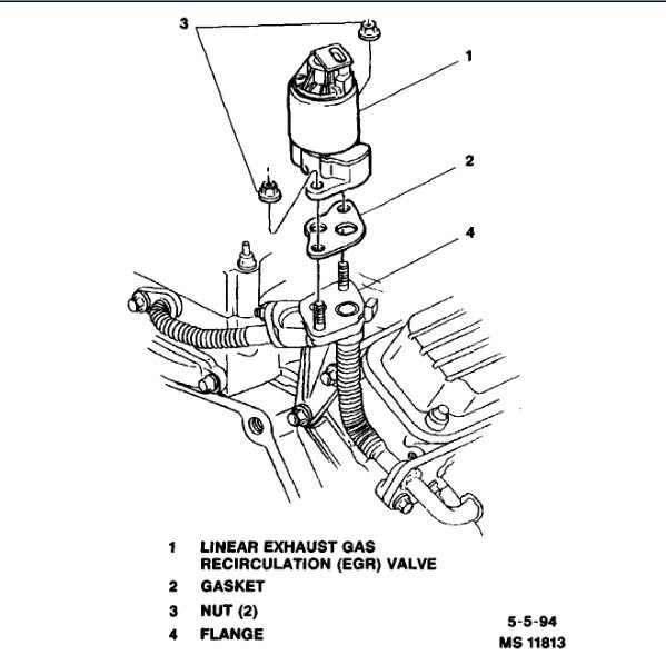

Throttle body is cleaned, new IAC, and I was finally able to read an old CEL code, which GM doesn't make it easy with this OBD "1.5" (the CEL comes on very infrequently but then stays off). The code was P0406, relating to the EGR. So I bought a new EGR valve, and still the issue persists. Hoping it isn't compression loss.

If you have the OBD2 connector, you have OBD2 system.
Is the EGR valve electronic?
If it is, did you run the car without the valve mounted? You should do this and listen for an exhaust leak and a loud hissing noise from a gross vacuum leak. You need those two for the valve to work.
Once you confirm this then we can go to other checks. You can turn the valve on and off in your scan tool.
+1
Friday, December 14th, 2018 AT 8:18 AM
MS5550
  • 5 POSTS
Yeah, the EGR is electronic. I unmounted it and there is definitely an exhaust leak and car sputters, but I do not hear any hissing noises from a vacuum leak.
Friday, December 14th, 2018 AT 10:24 AM
Okay, common issue. The vacuum port goes from the valve to the inside of the upper plenum. You can use a coat hanger to clear through the passage to get rid of the carbon.
That most likely is the issue with the 406 code.

Cleaned out the vacuum tube, and then put the EGR valve back on and hooked everything back up. It was a success! Took it on two long drives since and not a single stall.
Thanks for the help!
