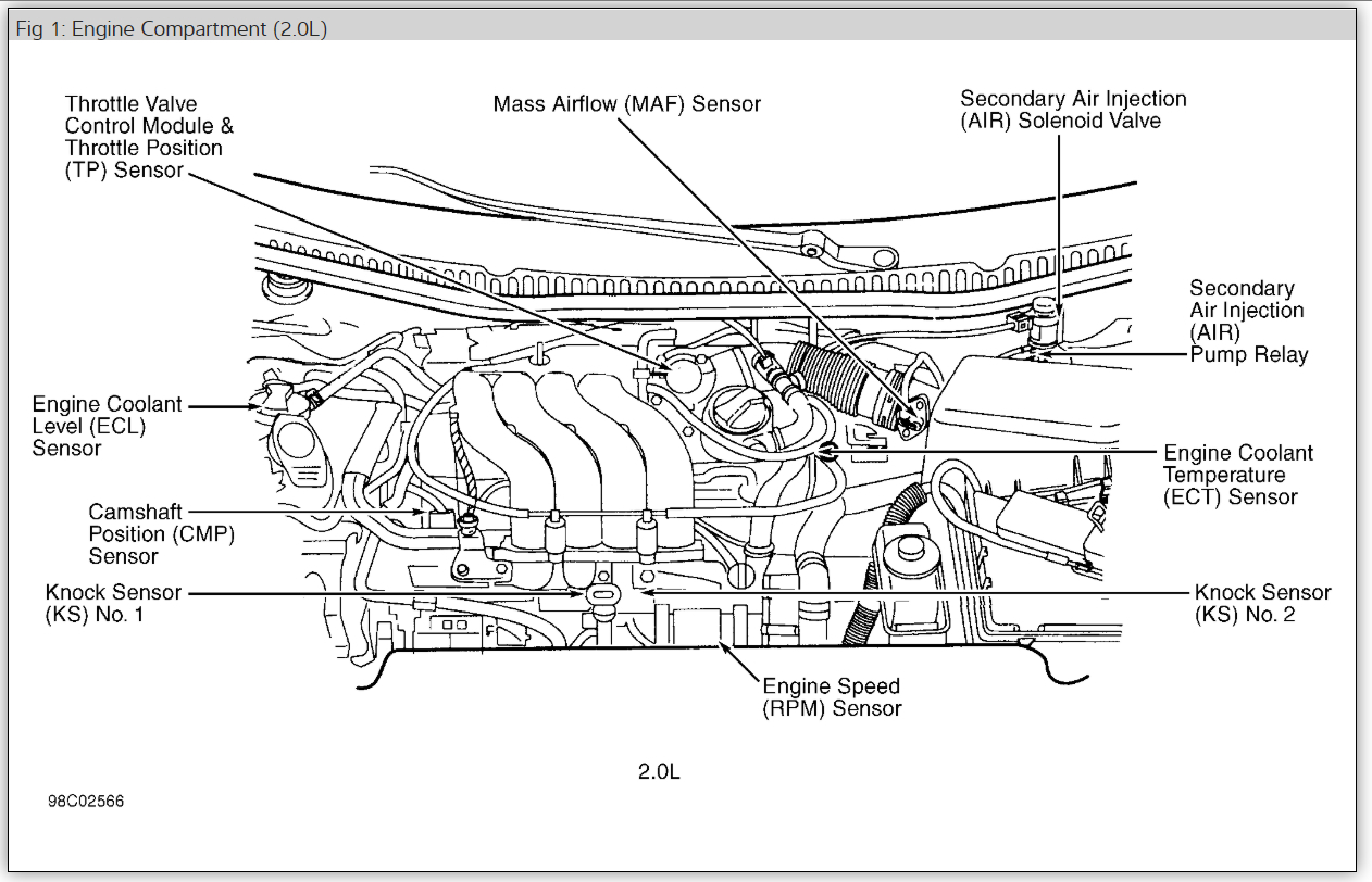

It sounds like the crankshaft sensor (RPM sensor) is failing which will leave no code. For the noise can you please shoot a quick video with your phone so we can hear the noise, that would be great? You can upload it here with your response. When the engine stalls can you hear the fuel pump in the tank running?
Here is a guide that can help:

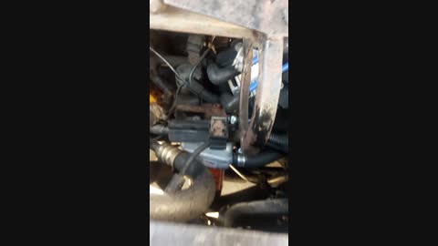

I uploaded two videos. One for the position if the crankshaft sensor. The other is the rattling sound of the car. So it rattles at different times. I am almost thinking it sounds like the chain on the oil pump? Not sure. Just guessing but it is a little disturbing.
I bought this car with I believe almost all its original parts. So, those things are starting to fail. But the rattling I am not able to pinpoint it. It is when I accelerate or drive.

Thanks for the videos they help. I believe the crankshaft sensor is under the ignition coil, but the noise the car makes sounds like the catalytic converter is falling apart which can clog the exhaust causing the engine to stall. Can you lift the car and check the catalytic converter? This guide can help:
