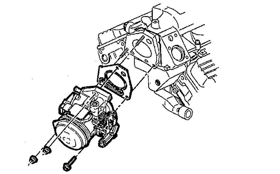

Can a vacuum leak cause hesitation, up and down idling and shutting the car completely off? It does it to me in the morning only and then fine when used again at lunch.
Wednesday, April 24th, 2019 AT 4:15 AM
Yes, it can. Check the base gasket on the throttle body. A common area of leaking.

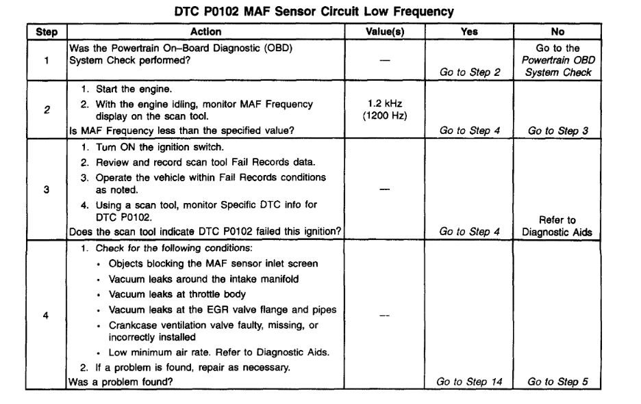

The mass air flow is the engine light on but I replaced it brand new, but I do have a leak. Can that cause the wrong reading and cause the car to jerk an hesitate and shut off in morning?
Wednesday, April 24th, 2019 AT 4:32 AM
What is the code for the mass air flow?
Wednesday, April 24th, 2019 AT 4:49 AM
ADAMFASCA
  • 50 POSTS
P0102

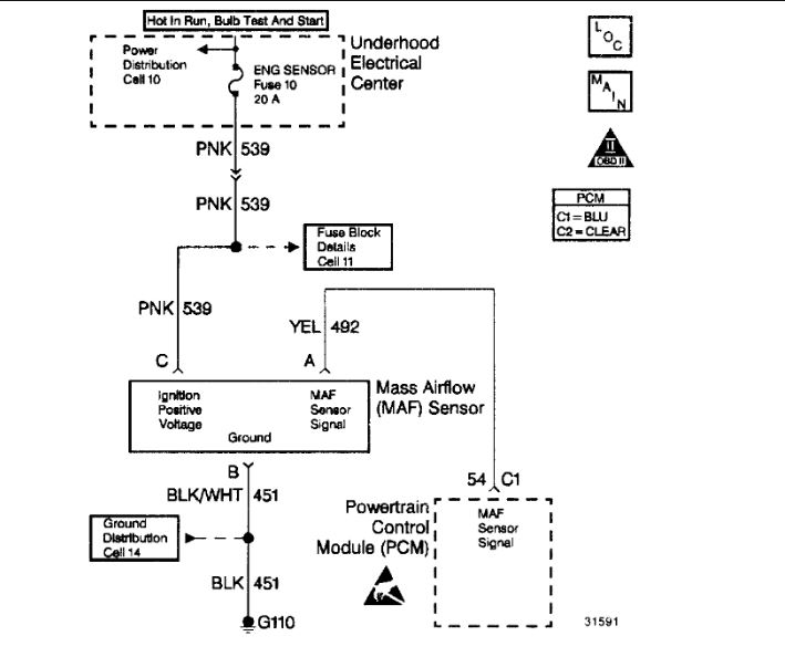

Description
CIRCUIT DESCRIPTION
The Mass Air Flow (MAF) sensor measures the amount of air which passes through it into the engine during a given time. The PCM uses the mass air flow information to monitor engine operating conditions for fuel delivery calculations. A large quantity of air entering the engine indicates an acceleration or high load situation, while a small quantity of air indicates deceleration or idle. The MAF sensor produces a frequency signal which can be monitored using a scan tool. The frequency will vary within a range of around 2000 Hertz at idle to about 10,000 Hertz at maximum engine load. DTC P0102 will be set if the signal frequency from the MAF sensor is lower than the possible range of a normally operating MAF sensor.

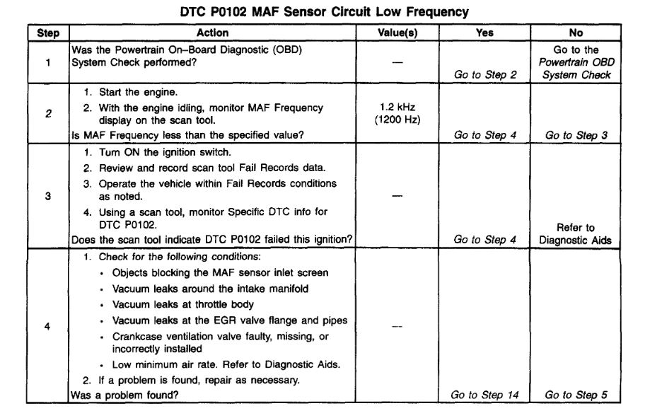

A low minimum air rate can cause DTC P0102 to be set during deceleration. Check the minimum air rate as follows:
1. Run the engine until fully warm (above 85°C / 185°F).
2. Disconnect the IAC.
3. Install a J 37027-A IAC System Monitor.
4. With the engine idling, command the IAC valve to the fully extended position (0 counts).
5. With the IAC fully extended, observe the Mass Air Flow reading on the scan tool.
6. Check for conditions that can cause a low minimum air rate, including throttle bore and throttle plate coking if the Mass Air Flow reading is less than 2.27 g/sec.
7. If the minimum air rate is less than specification, clean or replace the throttle body as necessary. Go to Throttle Body Assembly.

- Poor connection at the PCM - Inspect harness connectors for backed out terminals, improper mating, broken locks, improperly formed or damaged terminals, and poor terminal to wire connection.
- Misrouted harness - Inspect the MAF sensor harness to ensure that it is not routed too close to high voltage wires such as spark plug leads.
- Damaged harness - Inspect the wiring harness for damage.
- If the harness appears to be OK, observe the scan tool while moving connectors and wiring harnesses related to the MAF sensor. A change in the display will indicate the location of the fault.
- Plugged intake air duct or filter element. - A wide-open throttle acceleration from a stop should cause the Mass Air Flow displayed on a scan tool to increase from about 4-7 gm/s at idle to 100 gm/s or greater at the time of the 1-2 shift. If not, check for a restriction. If DTC P0102 cannot be duplicated, the information included in the Fail Records data can be useful in determining vehicle mileage since the DTC was last set. This may assist in diagnosing the condition.

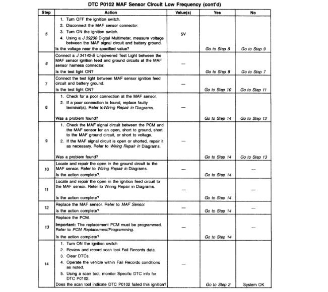

TEST DESCRIPTION
Number(s) below refer to the Step number(s) on the Diagnostic Table:
2. This step verifies that the problem is present at idle.
5. A voltage reading of less than 4 or over 6 volts at the MAF sensor signal circuit indicates a fault in the wiring or a poor connection.
6. Verifies that ignition feed voltage and a good ground are available at the MAF sensor.
13. This vehicle is equipped with a PCM which utilizes an Electrically Erasable Programmable Read Only Memory (EEPROM). When the PCM is being replaced, the new PCM must be programmed.

Can that MAF sensor be on due to the leak possibly to the intake manifold?
Wednesday, April 24th, 2019 AT 5:56 AM
Yes, You need to follow the flow chart.

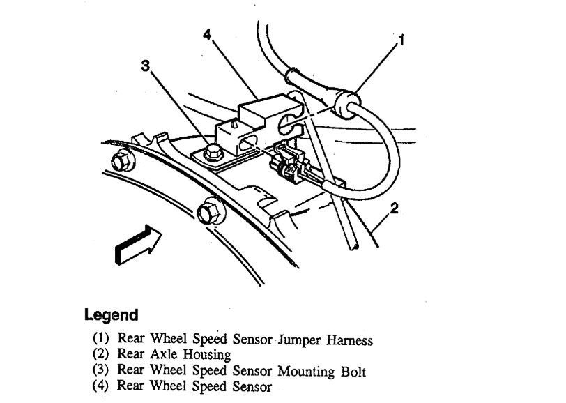

Is the ABS sensor behind the wheels in the rear? Do bolts have to come off?
Wednesday, April 24th, 2019 AT 10:44 AM
The rear is on top of the differential housing.

I had to scrape away the old EGR gasket. So now it’s flushed, but now when I start the car it comes on then turns right off.
Friday, April 26th, 2019 AT 2:01 PM
Did you use a new gasket?
