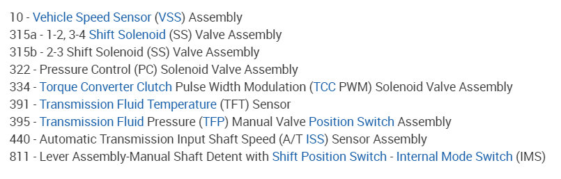

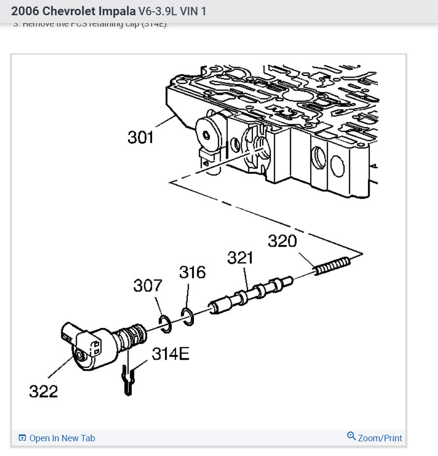

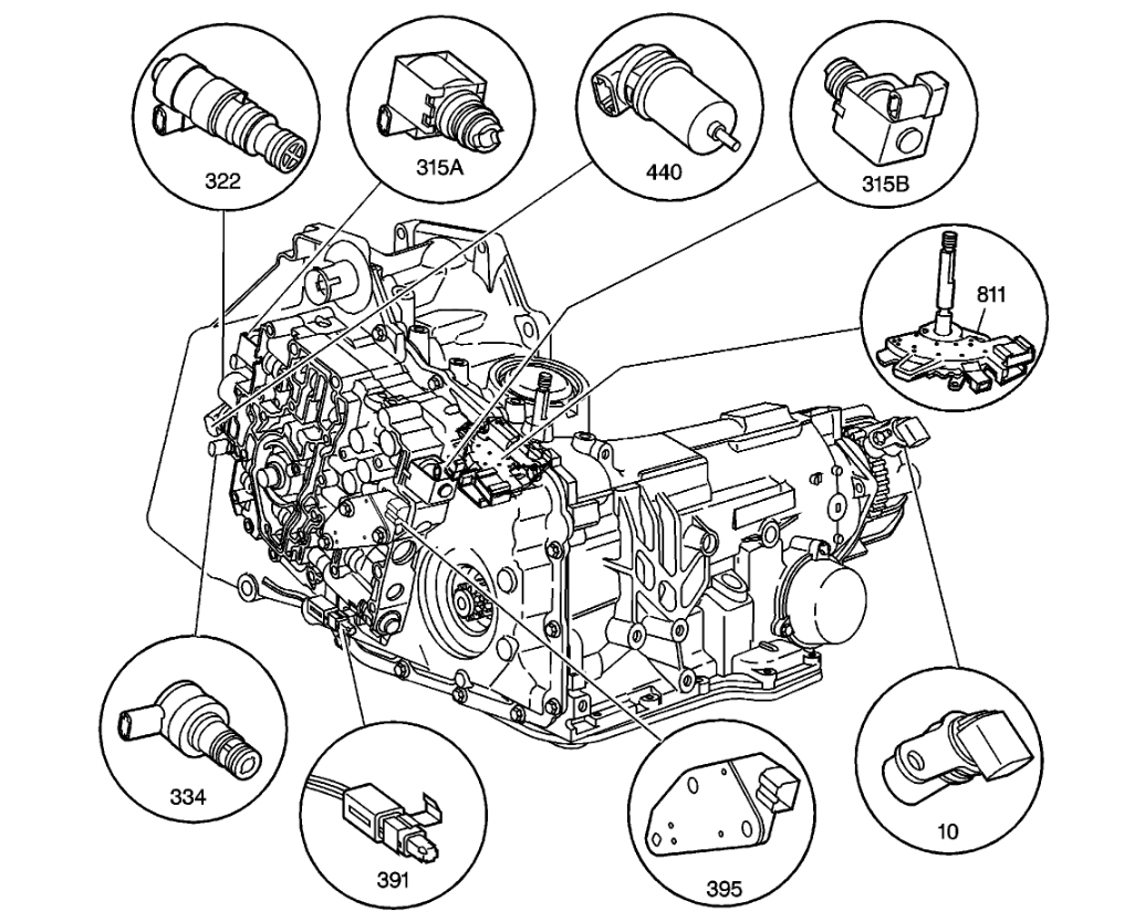

You could have a pressure control solenoid that is not working right. Here is the location, did you get a chance to run the codes? Check out the diagrams (below). Please let us know what happens.

I don't have a code checking machine.
My transmission is slipping incredible hard now. When I put it in drive from park, I have to wait until I hear a *clunk* for me to start driving. If I don't, and push the gas pedal before I hear that, my engine revs but it does not move, and then it slams into gear. I hear a clunk sound ever shift.
Another thing I am noticing now is that my rpm's bounce up and back down when driving. It happened in all four gears. Driving at a steady mph (80 for example) I have always sat at 2200-2300 (i don't know exactly because it only goes up my 500). My rpm's are now bumping up by 100-150 rpm's while driving, and then back down to normal. This happens a lot while driving. It jerks every time the rpm's bump up regardless of the speed I am at or the gear I am in.
Monday, May 20th, 2019 AT 12:02 PM
