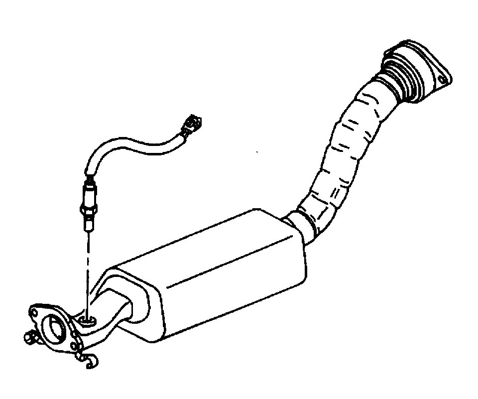

CONVERTER
Catalytic Converter Replacement (3.8L)
Removal Procedure
Important: The 3-way catalytic converter is serviced by replacing the entire assembly. Always replace the gaskets when servicing the 3-way catalytic converter assembly. Never install the original gaskets

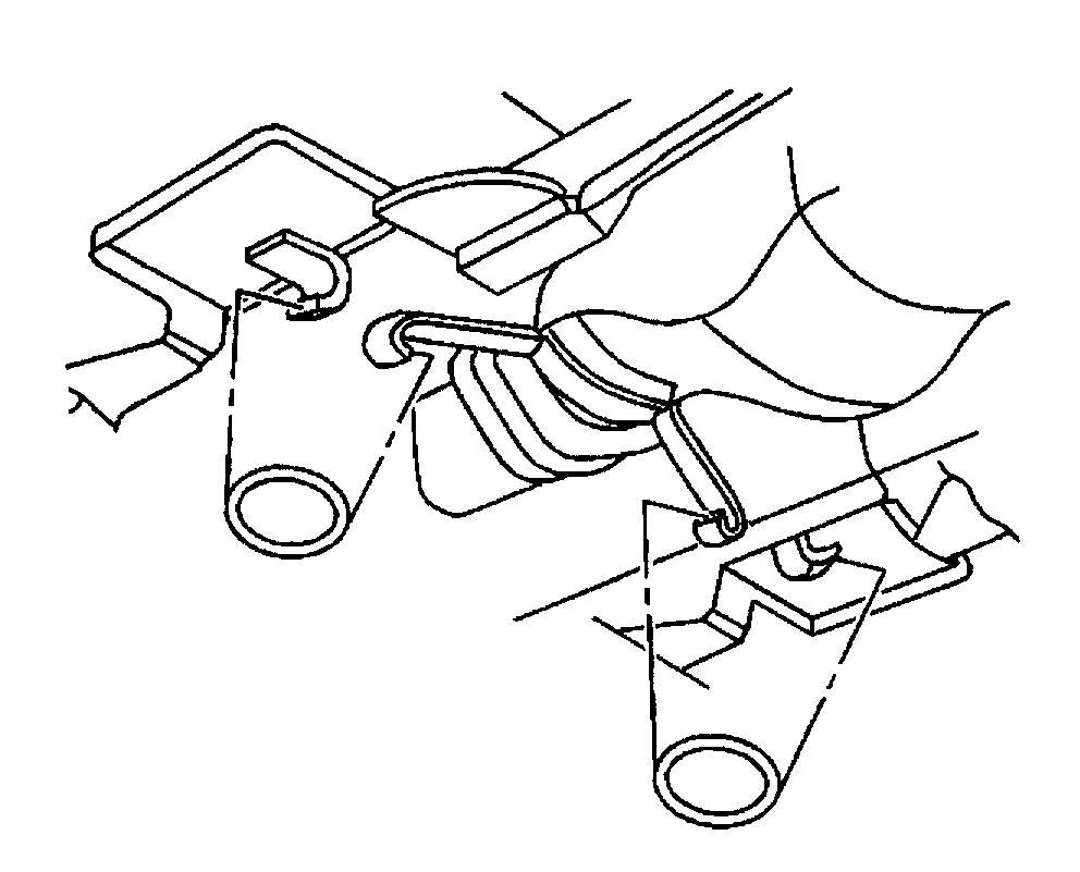

1. Raise and support the vehicle. Refer to Vehicle Lifting.
pic 1

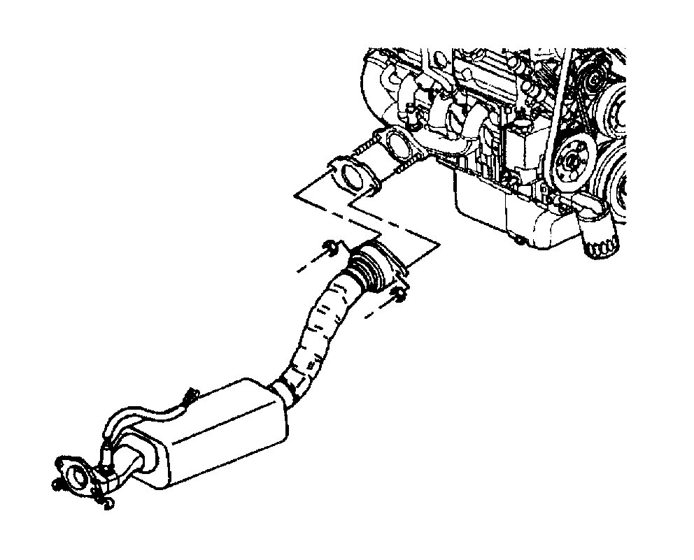

. Disconnect the Heated Oxygen Sensor (HO2S) electrical connector.

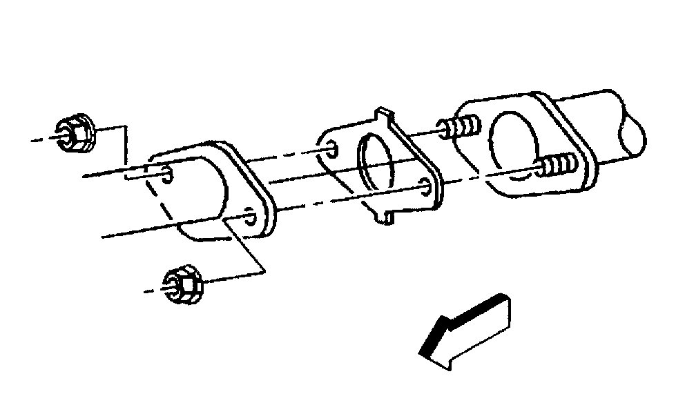

3. Remove the exhaust manifold pipe stud nuts.
pic 2

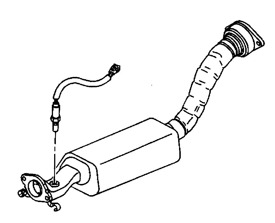

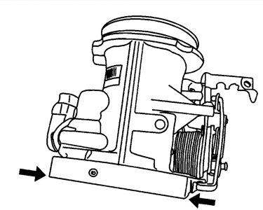

4. Remove the catalytic converter nuts.
pic 3
5. Remove the catalytic converter hangers.
6. Remove the 3-way catalytic converter.
7. Remove the gasket from the exhaust pipe.

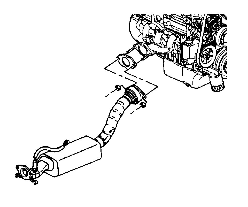

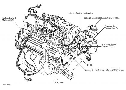

9. Clean and inspect the exhaust manifold and the exhaust pipe gasket mating surfaces.
pic 4
10. Remove the Heated Oxygen Sensor (HO2S).

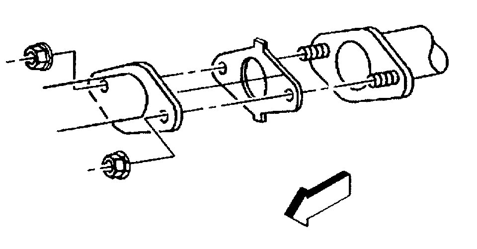

Installation Procedure
pic 5
1. Install the Heated Oxygen Sensor (HO2S).

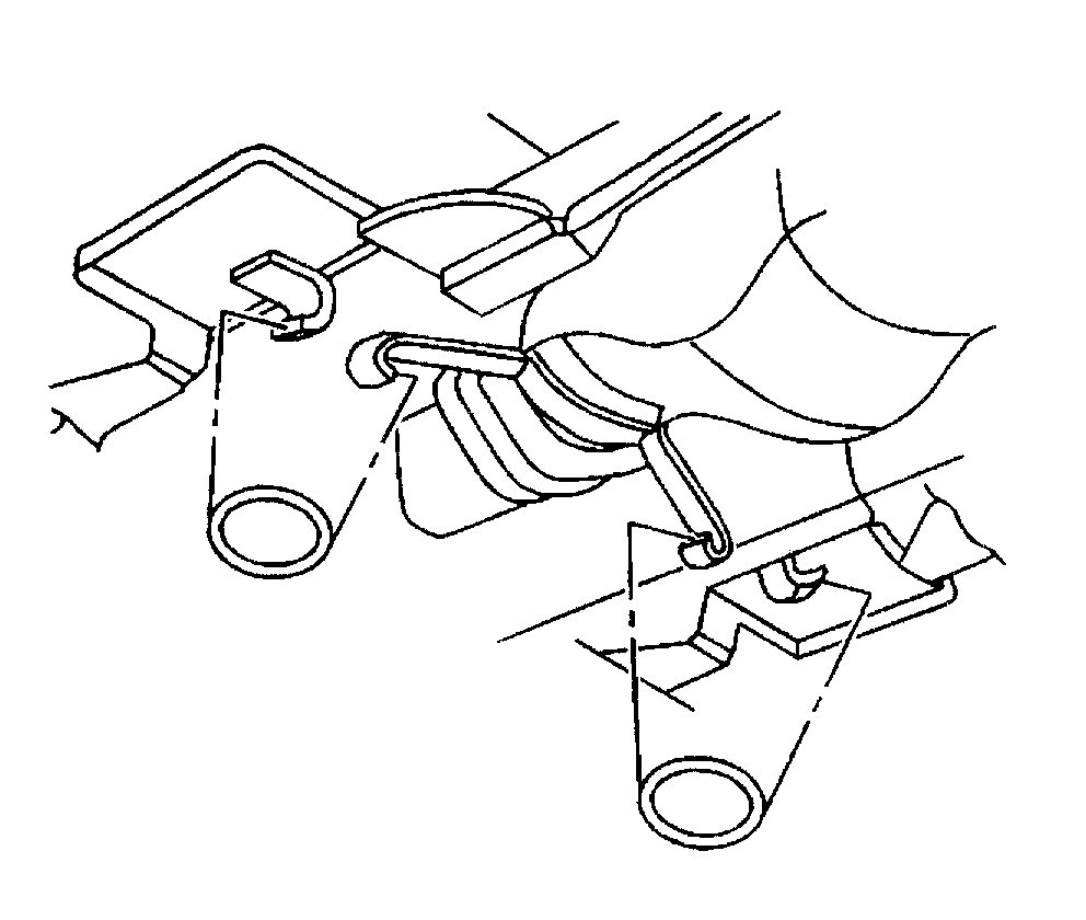

pic 6
2. Install a new gasket to the exhaust pipe studs.
3. Install a new gasket to the exhaust manifold.
Notice: Refer to Catalytic Converter Movement Notice in Service Precautions.
4. Install and support the 3-way catalytic converter.
5. Install the catalytic converter nuts.
pic 7
Notice: Refer to Fastener Notice in Service Precautions.
6. Install the exhaust manifold pipe stud nuts.
^ Tighten the exhaust manifold pipe stud nuts to 32 Nm (24 ft. lbs.).
^ Tighten the catalytic converter nuts to 60 Nm (44 ft. lbs.).
pic 8
7. Install the catalytic converter hangers.
8. Connect the Heated Oxygen Sensor (HO2S) electrical connector.
9. Lower the vehicle.
10. Inspect the exhaust system for leaks.
