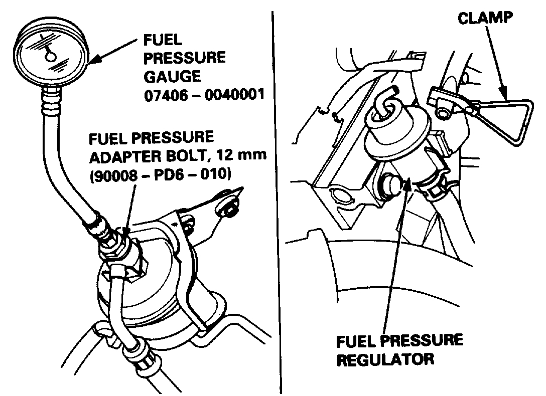

When cold no problem when car heats up; car jerks at 40 mph. Take foot off pedal or speed up it does it briefly at 60. Replaced idle air control valve ran okay for 2 weeks.

Is the check engine light staying on when the engine is running? If it is, that is where we need to start. You need to scan the computer for diagnostic trouble codes. Here is a quick video showing how it's done:
https://youtu.be/YV3TRZwer8k
I realize not everyone has a scanner, but often times a parts store will do it free of charge. If you find codes, let me know what they are.
Now, the next thing is it could be related to fuel pump pressure. I would suggest moving on to that next if there are no trouble codes. Here is a link showing in general how it's done:
Here are the directions specific to your vehicle. The attached picture correlates with the directions. The manufacturer's specs are included in the directions as well.
________________________________________
1997 Honda Civic DX Sedan L4-1590cc 1.6L SOHC MFI
Component Tests and General Diagnostics
Vehicle Powertrain Management Fuel Delivery and Air Induction Fuel Pump Fuel Pressure Testing and Inspection Component Tests and General Diagnostics
COMPONENT TESTS AND GENERAL DIAGNOSTICS
Inspection
1. Relieve fuel pressure.
pic 1
2. Remove the 12 mm banjo bolt from the fuel filter while holding the fuel filter with another wrench. Attach the special tools.
3. Start the engine. Measure the fuel pressure with the engine idling and the vacuum hose of the fuel pressure regulator disconnected from the fuel pressure regulator and pinched. If the engine will not start, turn the ignition switch ON (II), wait for two seconds, turn it off, then back on again and read the fuel pressure.
Pressure should be: except B16A2 engine:
260 - 310 kPa (2.7 - 3.2 kg/Sq.cm, 38 - 46 psi)
B16A2 engine: 270 - 320 kPa (2.8 - 3.3 kg/Sq.cm, 40 - 47 psi)
4. Reconnect vacuum hose to the fuel pressure regulator.
200-250 kPa (2.0 - 2.5 kg/Sq.cm, 28 - 36 psi)
B16A2 engine: 210 - 260 kPa (2.1 - 2.6 kg/Sq.cm, 30 - 37 psi)
If the fuel pressure is not as specified, first check the fuel pump. If the fuel pump is OK, check the following:
- If the fuel pressure is higher than specified, inspect for:
- Pinched or clogged fuel return hose or line.
- Faulty fuel pressure regulator.
- If the fuel pressure is lower than specified, inspect for:
- Clogged fuel filter.
- Fuel line leakage.
There are other things that could be an issue as well, but lets start with these two things. Let me know what you find or if you have other questions.

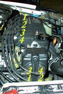

So.I just recently puchased a 1.6L zc engine and transmission from a company. And have installed it into my car.I have goten every thing installed onto the engine and tranny. Their is how ever 1 vaccume line that does not hook up. I cannot hook up. Due to the fact on the back of the throttle body the port is not their.I had a zc 1.6l engine in the car before and it did have this port. My main issue is once I got every thing together I turned the car over and it wouldent start so I put the gas pedal down and it fired up. But was chuggin really bad it has disapated a small amout but still very shuggy.I have checked my wires and the distributer cap and took some sand paper to the cap. And pluged the vacumme line. Yet its still really bad. It wants to idel at 400-500rpm for a couple on seconds then dies unless I keep feeding it fuel. Any suggestions? And if it helps I do have headers on the car.1-2-4 are really hot 3 is cold
Monday, January 4th, 2021 AT 12:56 PM (Merged)
F4I_GUY
  • 3,302 POSTS
In what order do you have the ignition wires installed?
https://www.2carpros.com/forum/automotive_pictures/276698_firing_order_honda_6.jpg
It should look like that.
If that's fine, check your mechanical timing (timing belt marks)
