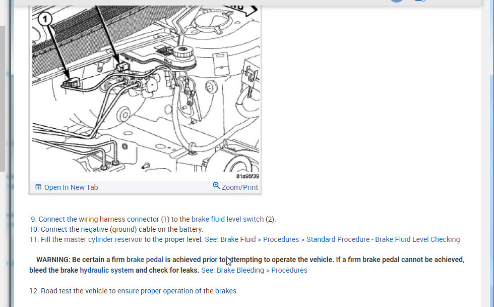

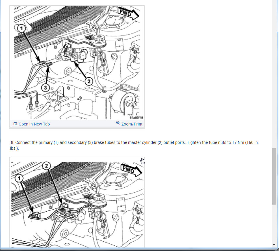

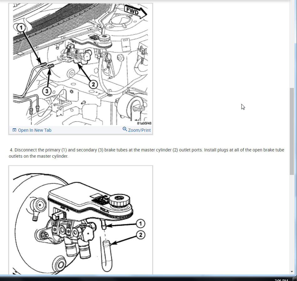

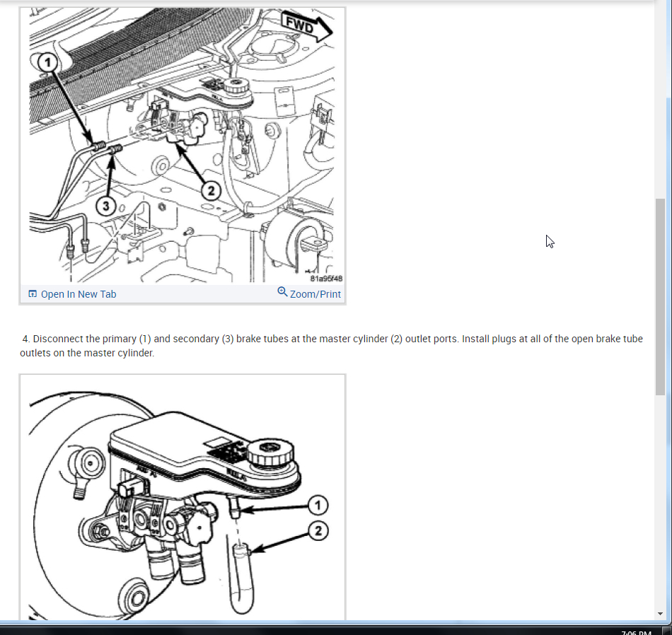

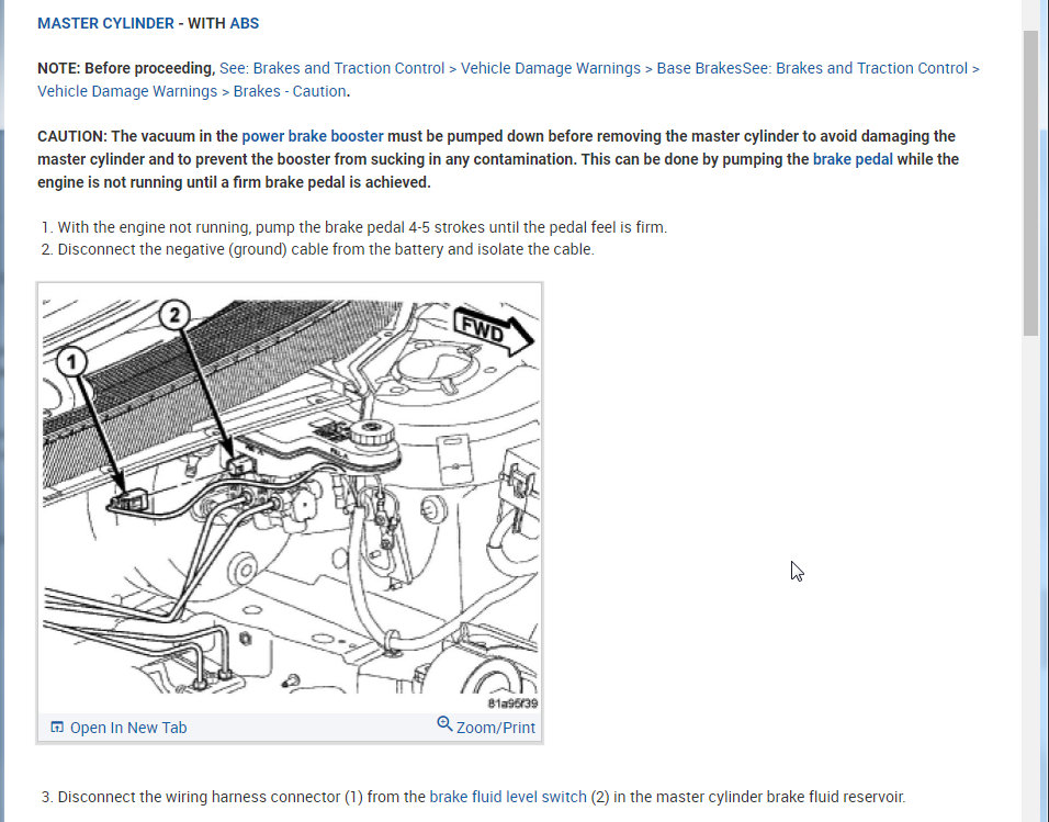

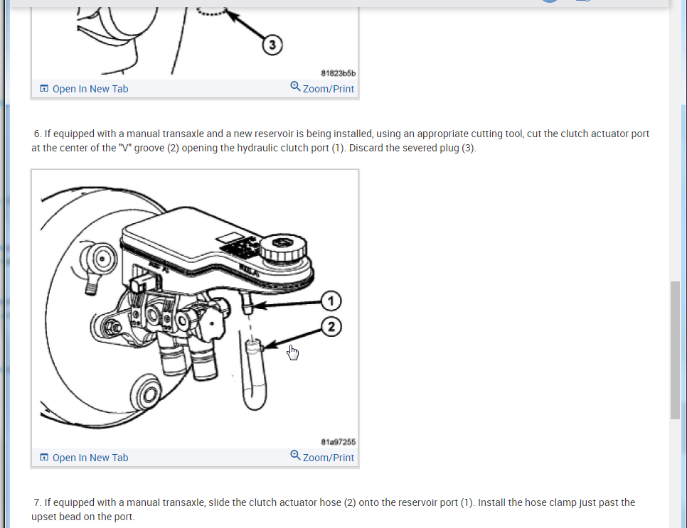

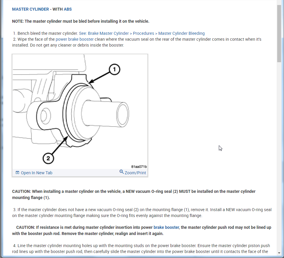

The brakes go to the floor the wshop said I need a new brake master.
Tuesday, September 24th, 2019 AT 10:58 PM
MECHANIC
18,907 POSTS
Here is a guide that will help with this:
https://www.2carpros.com/articles/how-to-replace-a-brake-master-cylinder
Below is the process from the manual on how to replace the master.
Please let us know if you have other questions. Thanks
