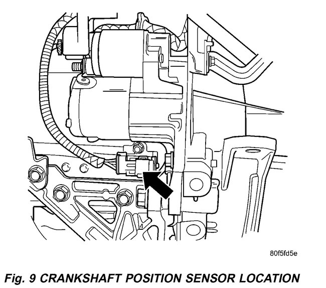

Fig. 9 pic 1 Crankshaft Position Sensor Location
The Crankshaft Position Sensor is in the front of the engine block just under the starter motor.

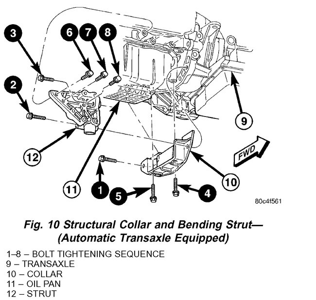

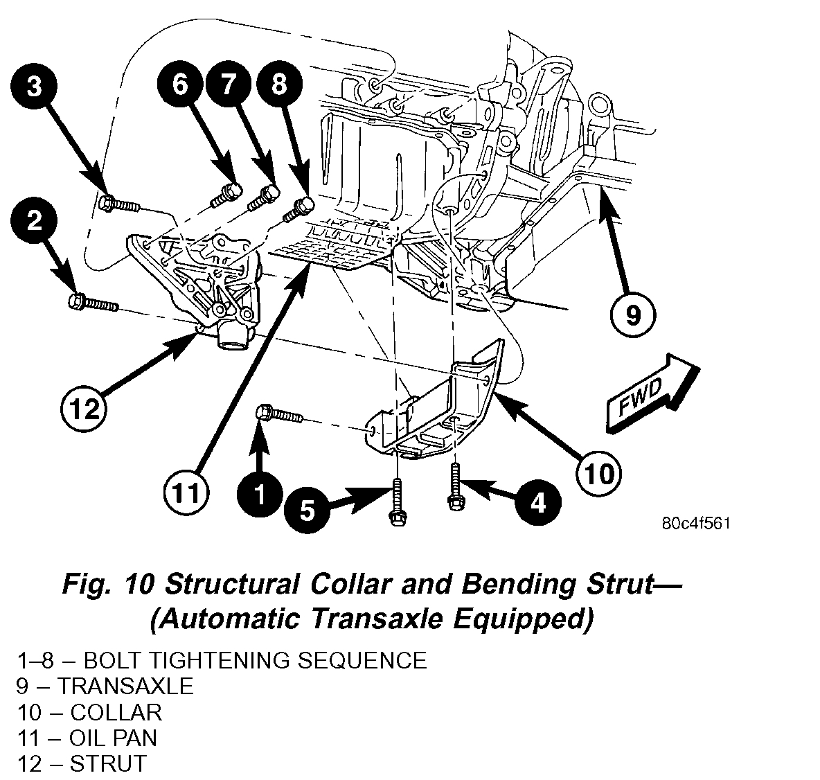

Fig. 10 pic 2 Structural Collar And Bending Strut (Automatic Transaxle Equipped)
3. Remove the Structural Collar, refer to the Engine, Structural Collar Removal and Installation.

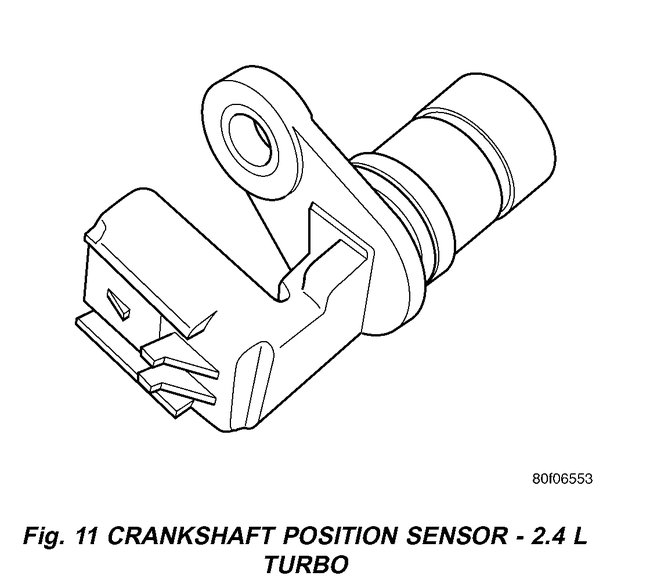

Fig. 11 pic 3 Crankshaft Position Sensor - 2.4L Turbo
6. Remove the sensor.
