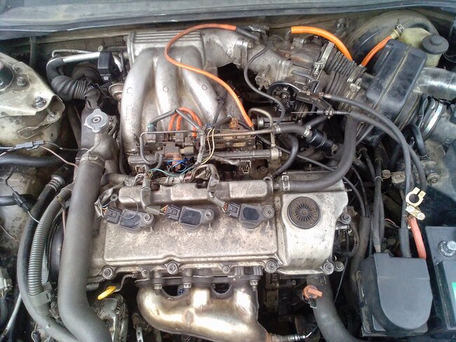

Fortunately, after everything, the car started again. But there was still an intermittent misfire. What the car owner said was that, 'even when the second mechanic did engine rebuild, the car still misfired. Until he personally bypassed earth from the COP wire to the solenoids very close to the fuel injector often tightened with 10mm knot and depicted with blue and green colors on the picture. Car owner verified that the reasons for the misfire from both mechanics which still prevailed, was due to the solenoid valve that wasn't opening. That's why when accelerating it experienced a loss of power, similar to that experienced by a faulty fuel pump.

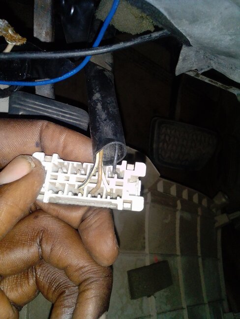

I tried to scan for DTC codes, but my scanner wasn't communicating. I checked all fuses, power and ground at obd port, those checked ok. But my scanner isn't compatible to read CAN network. There are only 4 wires intact for the obd2 port.
Furthermore, I added fuel through the intake to the engine, no change at all. I checked for spark and injector pulse. These things weren't present. But there was power to injector with just the key at ignition or ACC and COP had 1 ground and 1 power as usual.
Electrician from that garage, who also worked on the car said that he sniffed burning smell from the ECU, however personally I didn't when I went to start the car. I don't know how certain that was. Hence, I pulled out the ECU to a laptop board engineer to test the components inside. He said: "everything looks ok and test fine, however the IC he doesn't have the right tools to proceed with the test. With the ECU removed battery connected, Engine light would come ON. With ECU connected check light still comes ON.

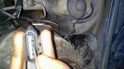

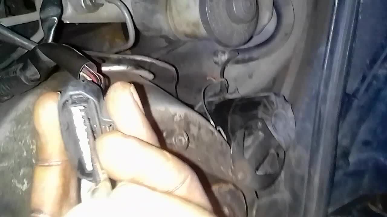

Before I left, I checked the MAF sensor 5 wires and noticed that 3 wires were earth instead of 2 and 1 power; no ignition current/ power was available for the remaining 2 wires.

That's the photo and video, I captured.

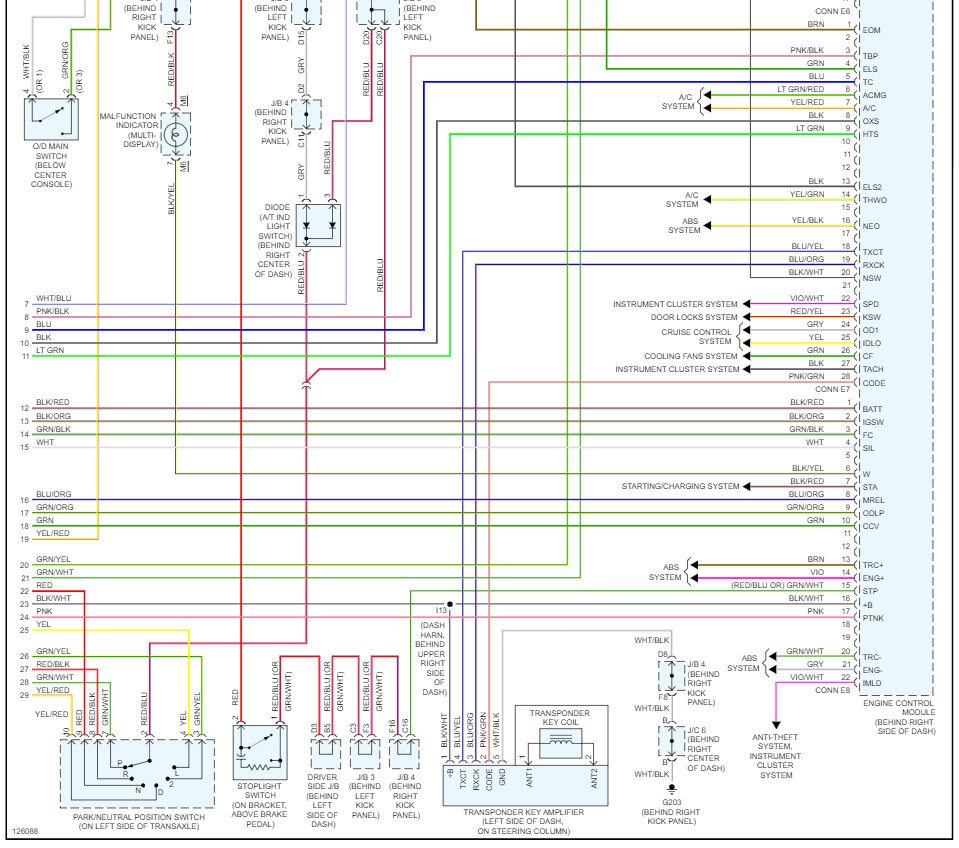

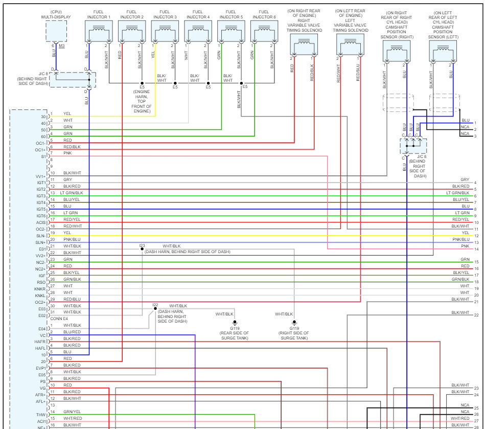

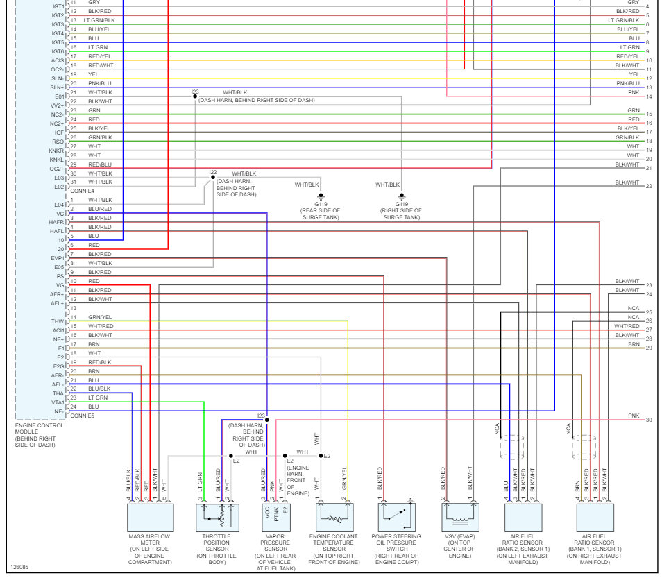

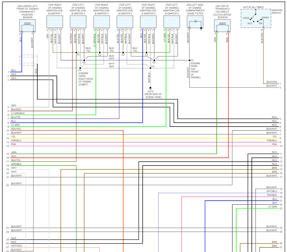

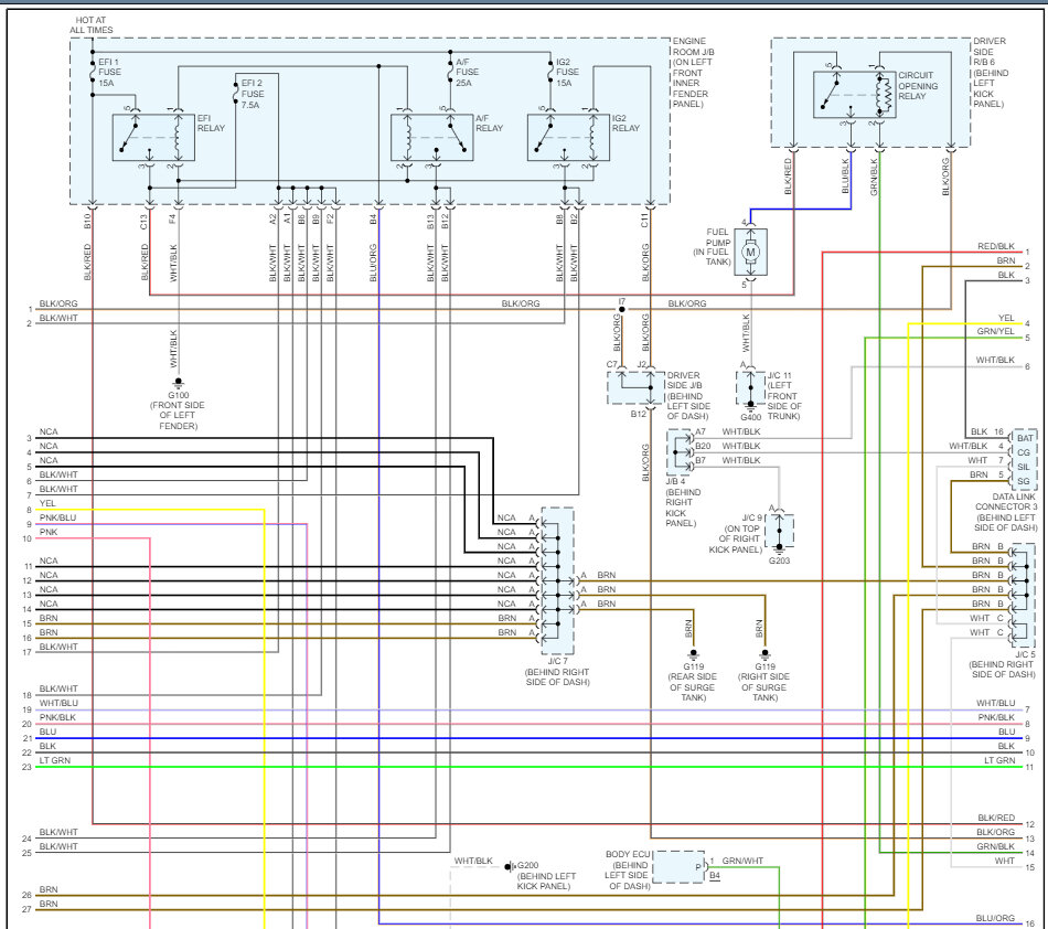

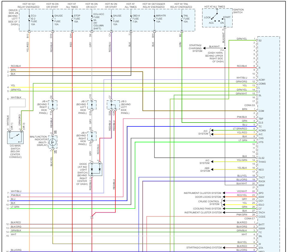

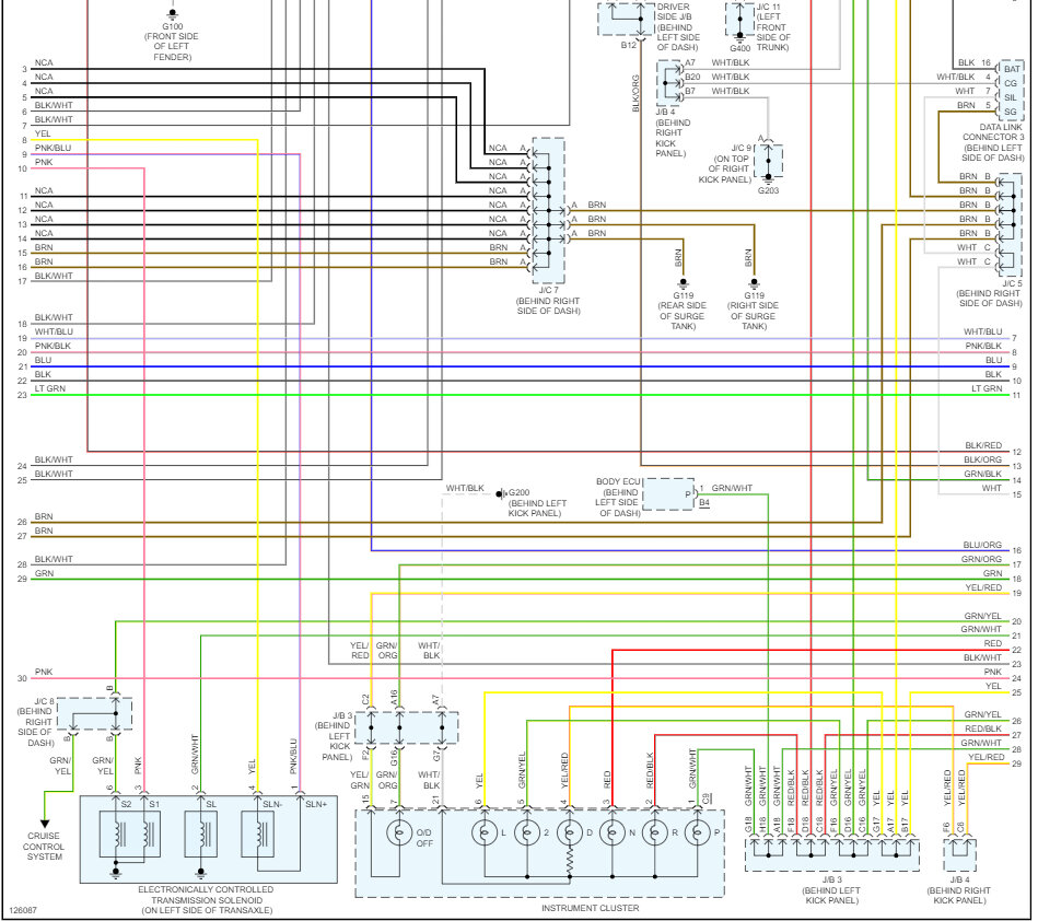

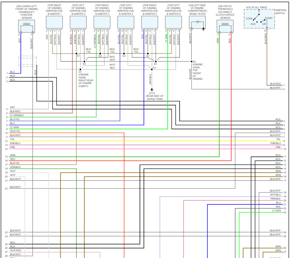

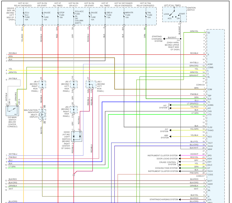

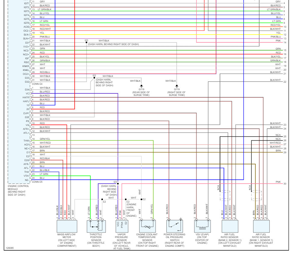

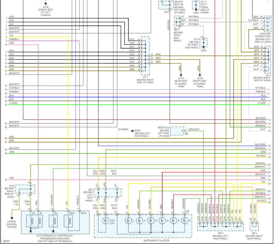

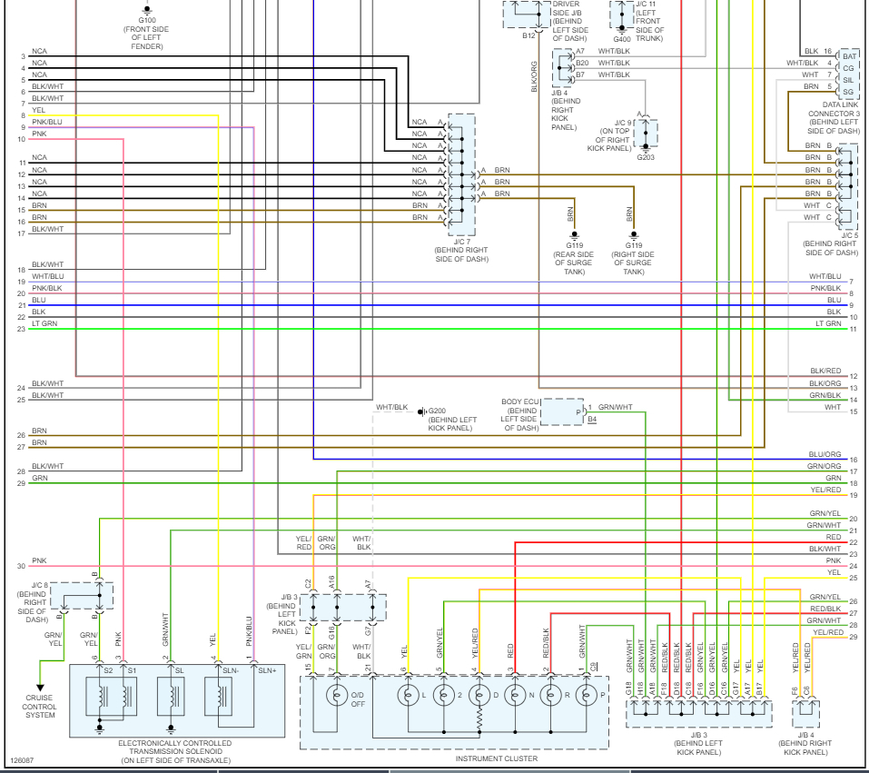

Please sir, can you also share the power distribution of the grounds, ecu wires- showing their routing, fuse box inside and outside, and sensors- especially including MAF sensor?
Saturday, June 17th, 2023 AT 10:09 AM
KEN L
  • MASTER CERTIFIED MECHANIC
  • 55,322 POSTS
Sure, here are the engine wiring diagrams and a guide to help you check the connections:
Monday, June 19th, 2023 AT 10:26 AM
DAVID DAVO ESSIEN
  • 152 POSTS
Okay. Thank you for the images! Definitely, I'll reach out to you.

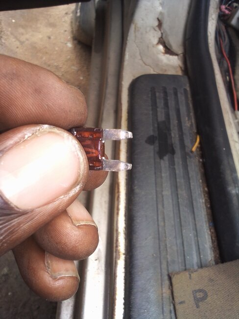

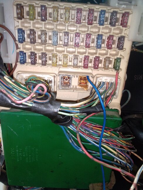

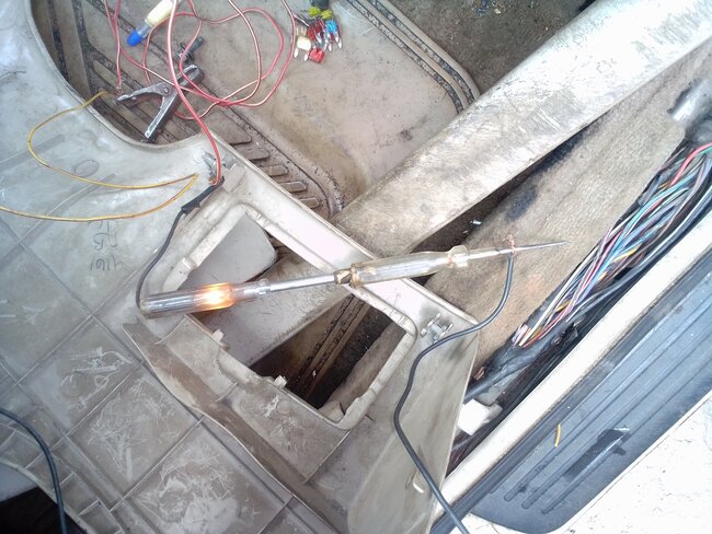

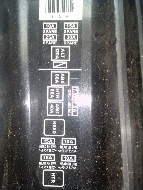

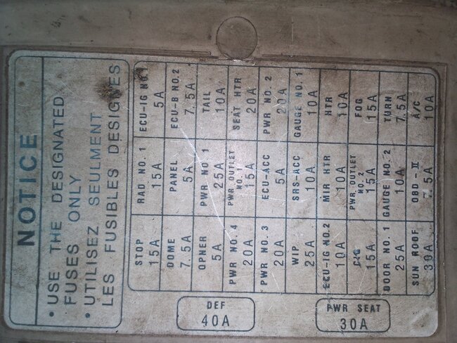

Once more, thank you for the wiring! Today, I went to check the things you highlighted. However, there was no good battery that was capable to crank the engine it could only be used to perform some test with test light. The client apologized for that. Nevertheless, I did some basic test. I checked the fuses the were all ok. I found the fuse that powered the MAF sensor wire that was supposed to be power instead of ground. When I unplugged the fuses, number 19 of it shutdown the light in test light but put on the light whenever that fuse is reconnected. That's how the fuse for that location looked.
Additionally, I noticed that that particular MAF sensor wire illuminated the test light even with the ECU removed. Using multimeter, I checked and saw that that particular MAF sensor wire goes to one of the ECU connector.
Also checked the 3 front out of 6 fuel injector wire to ECU, they were not shorted. Still good! How can I follow up that particular MAF wiring and what other checks can be done to fix the problem?

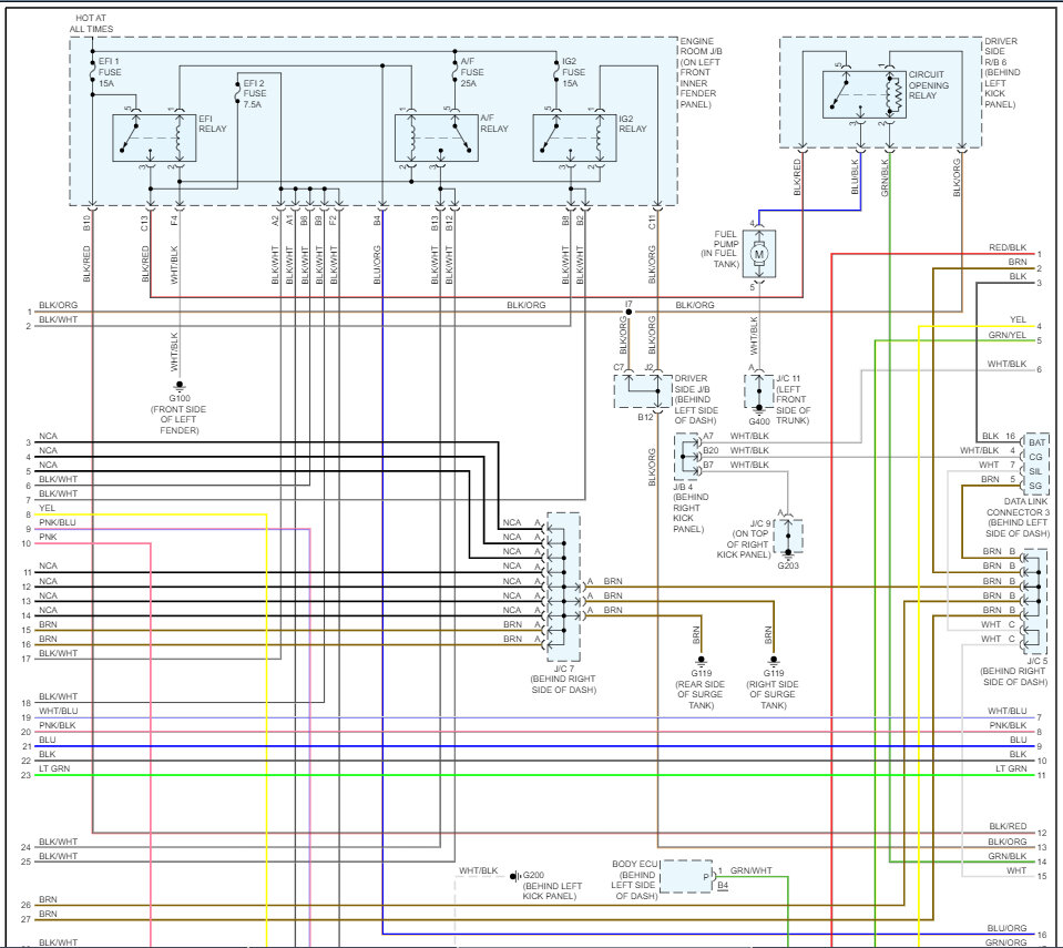

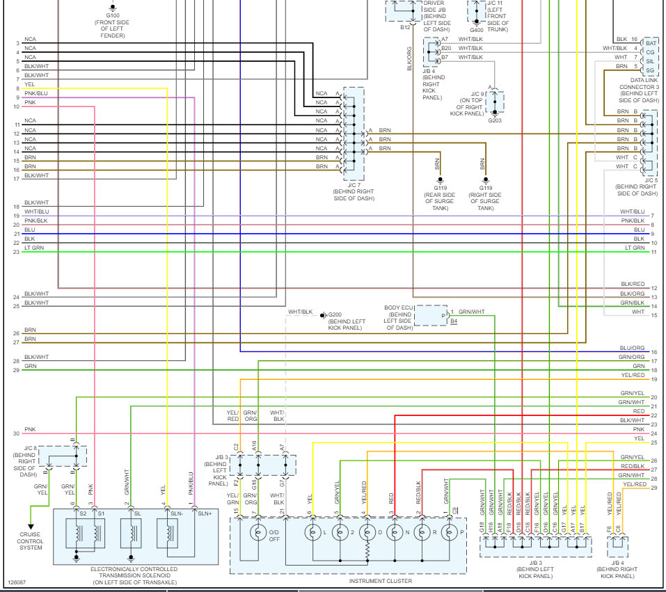

Good evening, sir. I went there yesterday to conduct some tests in the car and noticed that no iota of fuel was forth coming from the fuel pump on ignition on and during cranking. Scanner still didn't communicate. No spark no injector pulse still remained.
Sunday, June 25th, 2023 AT 3:48 PM
DAVID DAVO ESSIEN
  • 152 POSTS

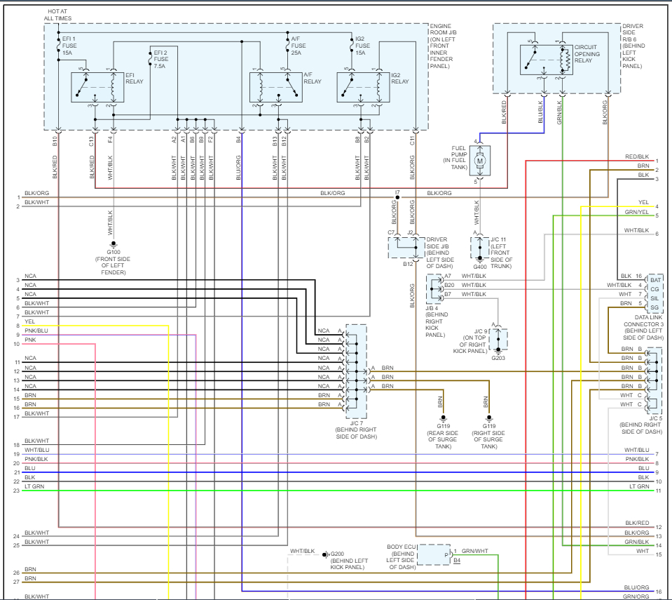

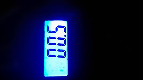

The first is the no fuel after I loosened the 14mm bolt slightly. Second is the power distribution layout for inside the video, while the last one is the engine room power distribution layout. In addition, I swapped the EFI no change at all. When I tested for power and ground, in one of the relay in the fuse compartment, the a/f relay was actuated. Please what checks should I further embark on, to rectify the issue?
Sunday, June 25th, 2023 AT 4:01 PM
KEN L
  • 55,322 POSTS
It sounds like you may have a bad ECM, did you check all fuses?

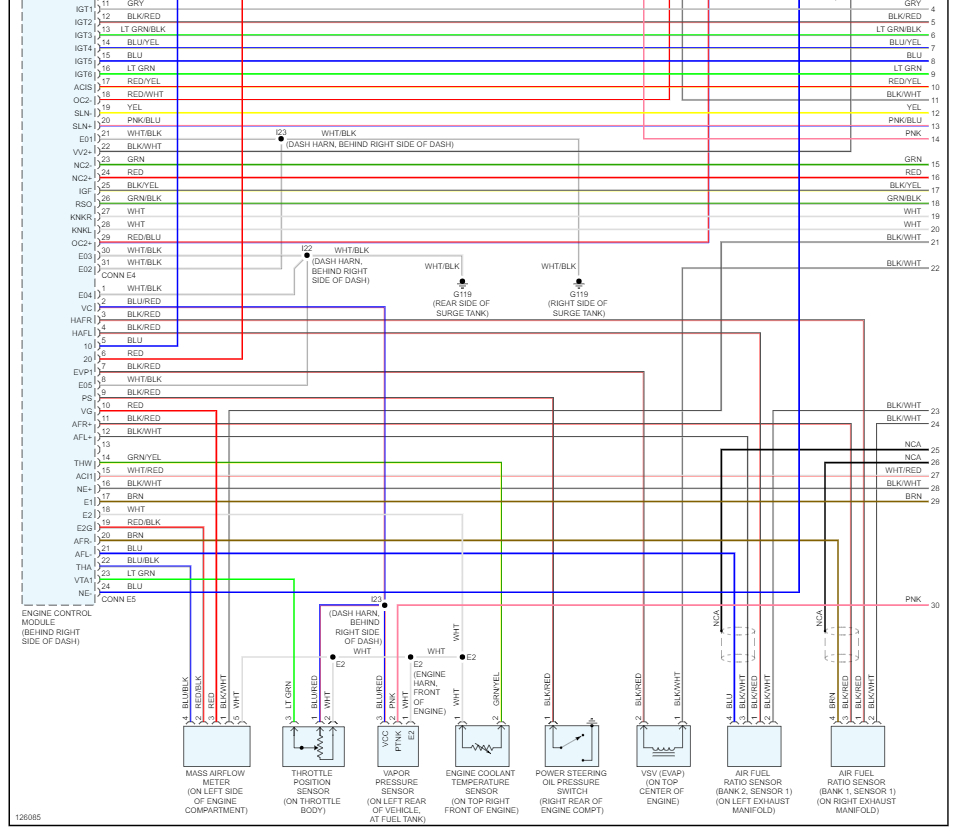

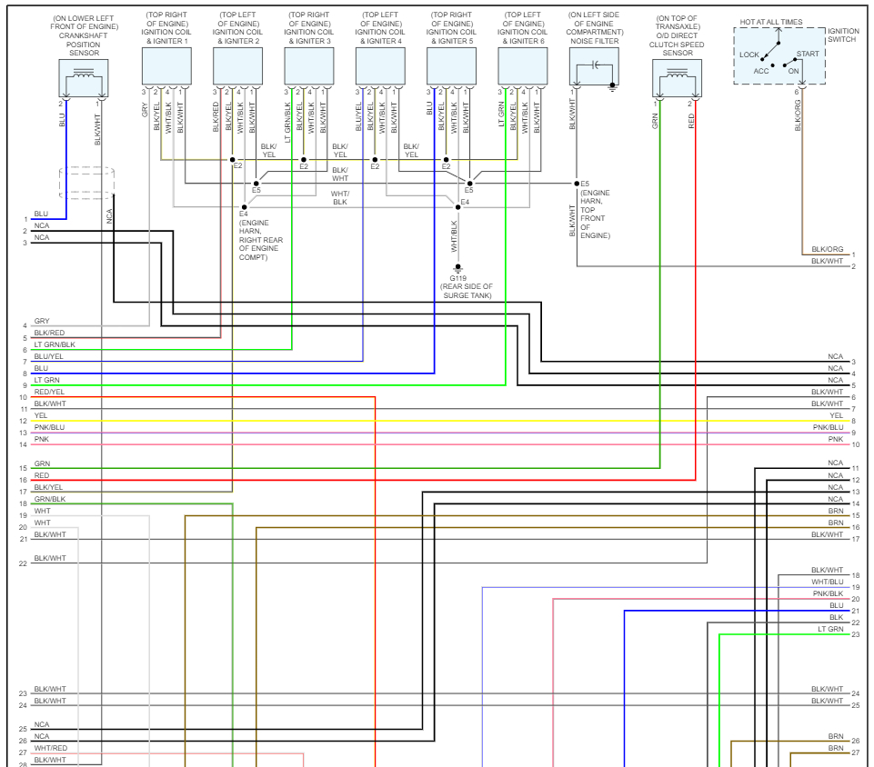

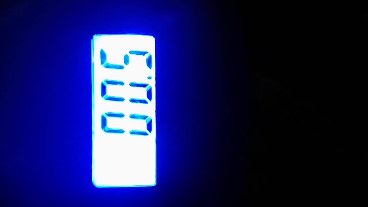

All fuses were okay. I also checked the ECU and noticed the presence of only one dc current 2 ignition current and several earth. Also, I later did a direct bypass from the ignition current to the fuel pump ground which buzzed the fuel pump to operate. Thus, fuel reached the engine however, there was no spark nor injector pulse as well. Consequently, I pulled out and bench tested the CKP sensor with a multimeter. Setting the meter to 20 ohms reading, I got 2.31. CKP sensor connected back, multimeter set to 200 AC, power to reference wire, engine cranked I got between 0.4 and 0.5. With the key released it dropped to 0.2. Initially, I got 27.5 then 22.8 during cranking, maybe it was an error with multimeter, but I don't know. Please guide me more on what I should do next.
Tuesday, July 25th, 2023 AT 6:22 PM
DAVID DAVO ESSIEN
  • 152 POSTS

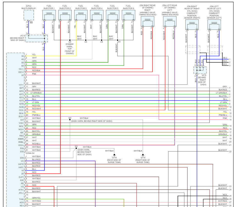

I noticed from my test light that both wires of CKP sensor had ground no power. Please how do I correct the wiring issue, could CKP sensor itself be faulty?
Wednesday, July 26th, 2023 AT 1:33 AM
KEN L
  • 55,322 POSTS

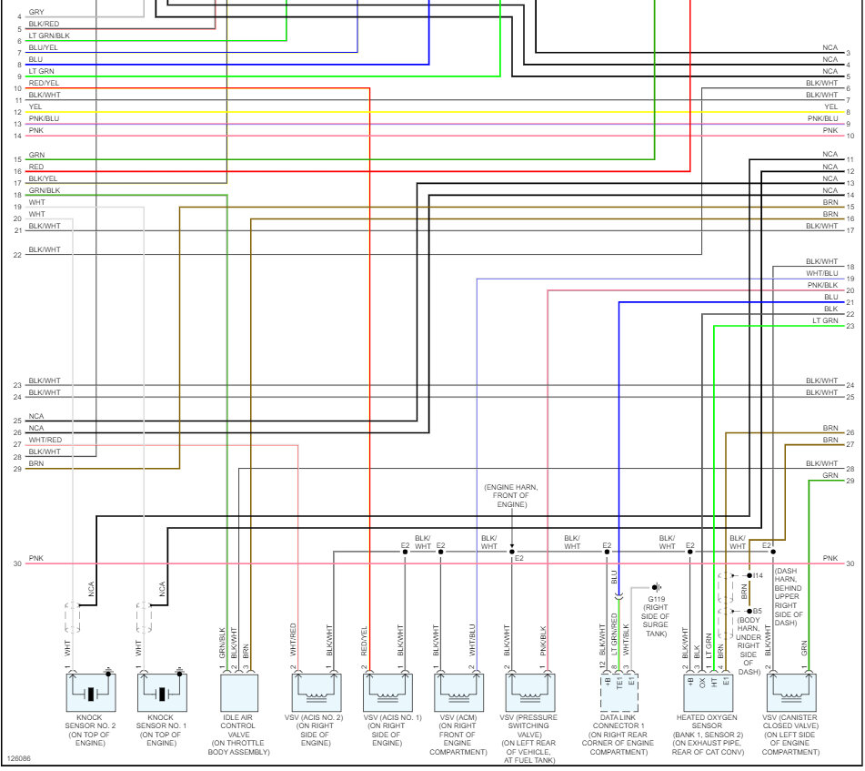

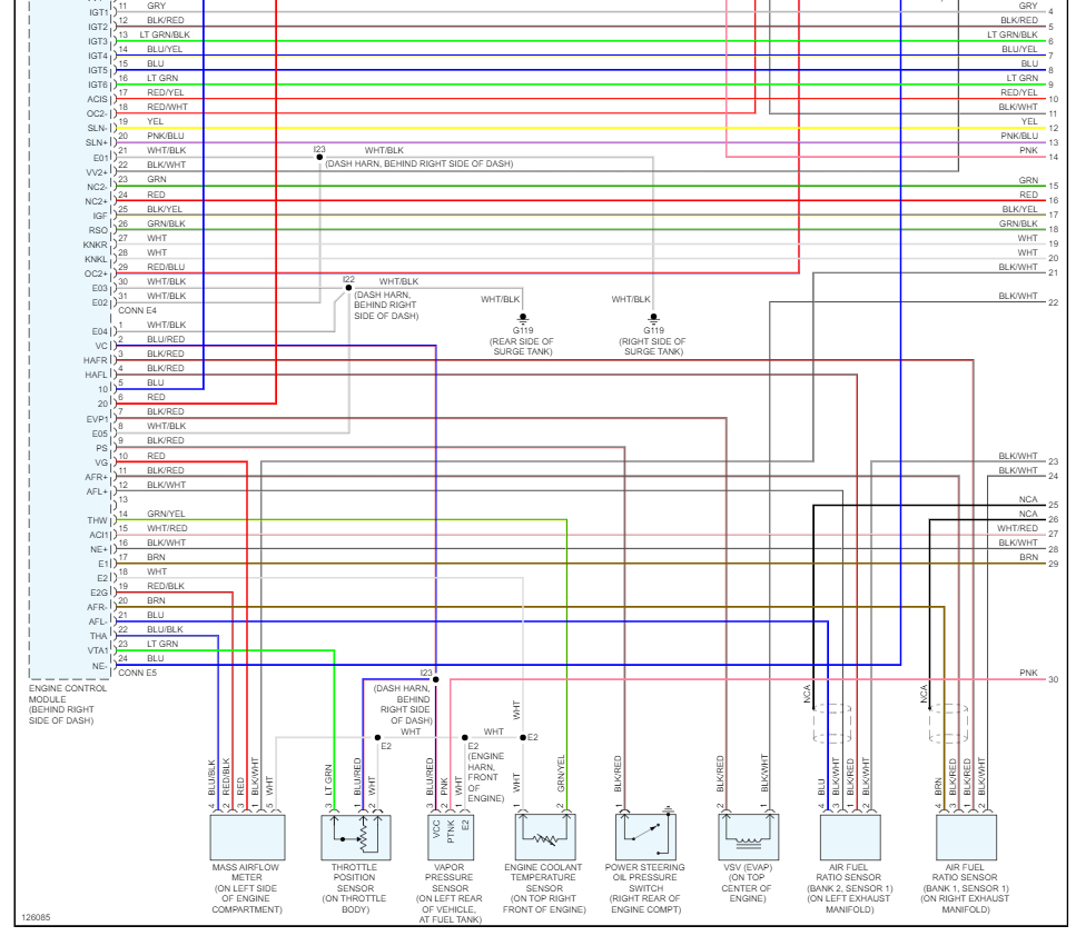

Did you check to see if the PCM was getting power to its power inputs? Also, I would check the PCM grounds as well. Check all fuses in the PCM wiring diagrams as well.
Check out the images (below). Please let us know what you find. Check out the images (Below). Please let us know what you find.
