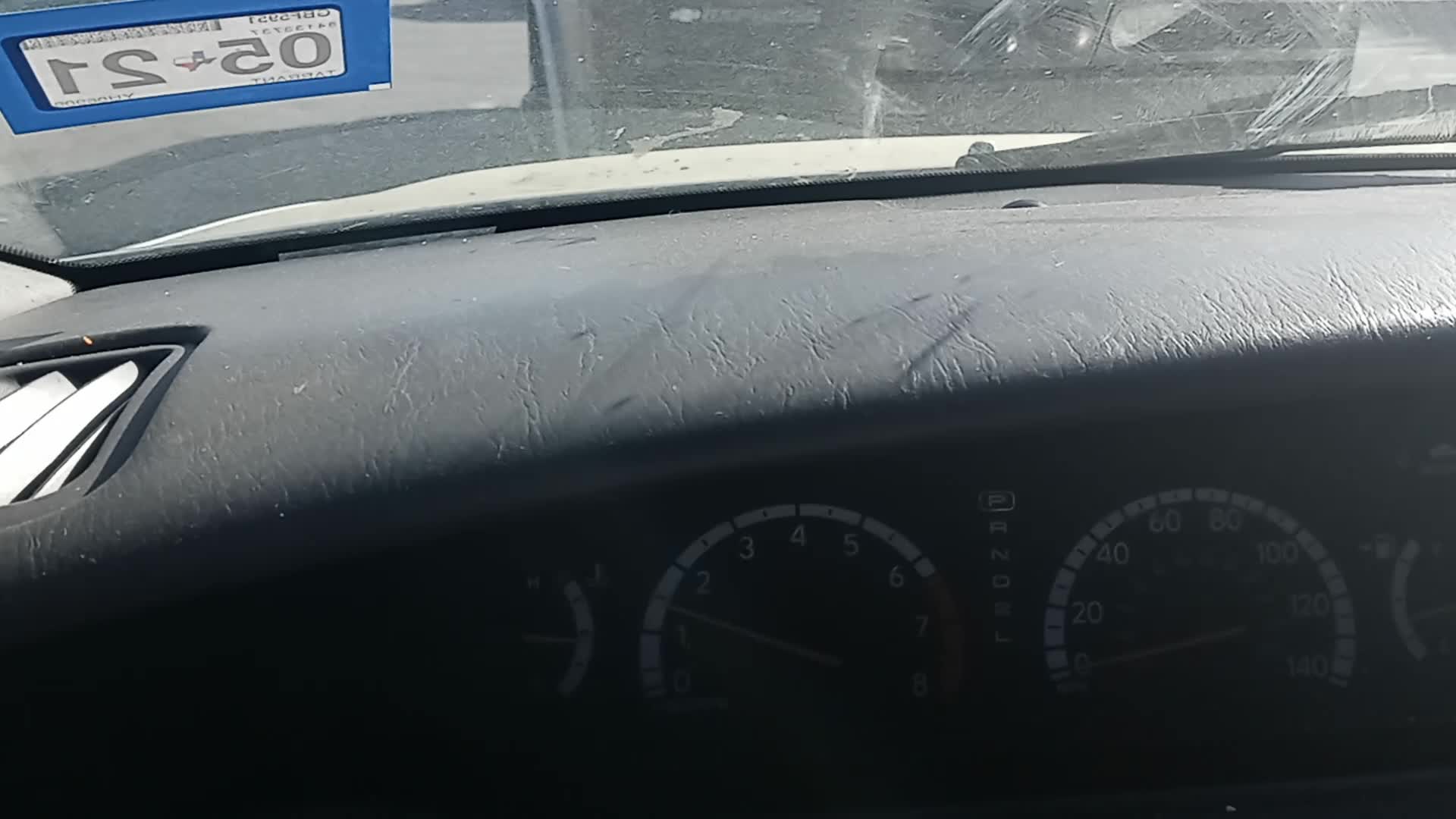

Cleaned IAC no fix. Here is a video. Sorry my editing skills are not good. If I let off brake the car will just keep accelerating so it's really not safe to drive. I took off check valve it is good and hoses look good.

Yes. You are correct. However, when you showed the RPMs it looked like it was surging around 1,000 RPMs up to about 2,500. Was this you accelerating the vehicle or was it doing this by itself?
Have you checked for a vacuum leak?

It was completely doing it by itself. That's the scary thing is if I just let off the brake the car will accelerate and continue accelerating until I hit brake and even then I have to hold the brake pedal firmly to keep my car from surging forward into someone else's. I guess a vacuum leak would be the next thing to check for but think it's kind of unlikely it just started one all hoses look to be in good shape no dry rot or damage. But I will check that next I guess.

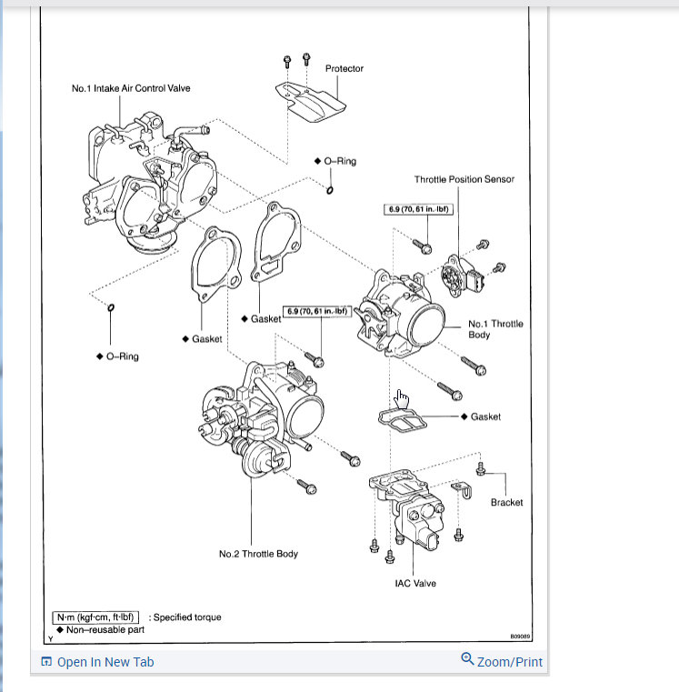

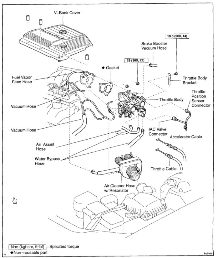

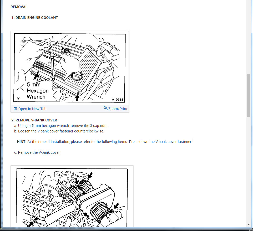

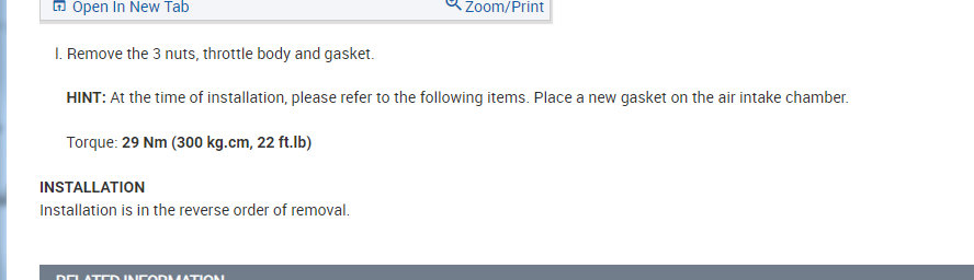

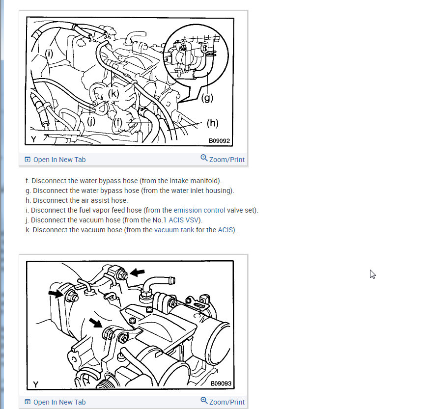

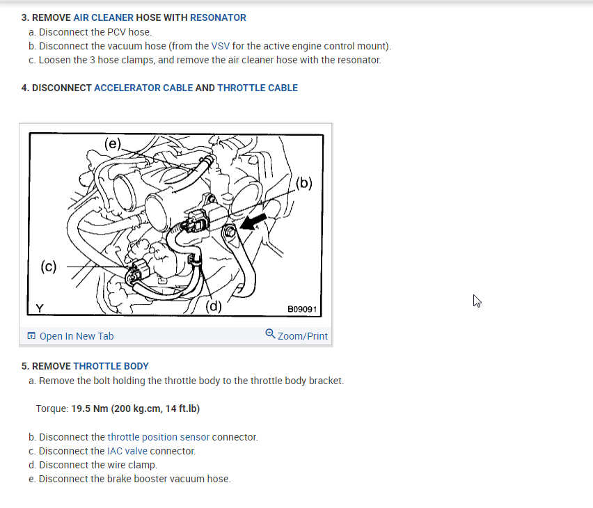

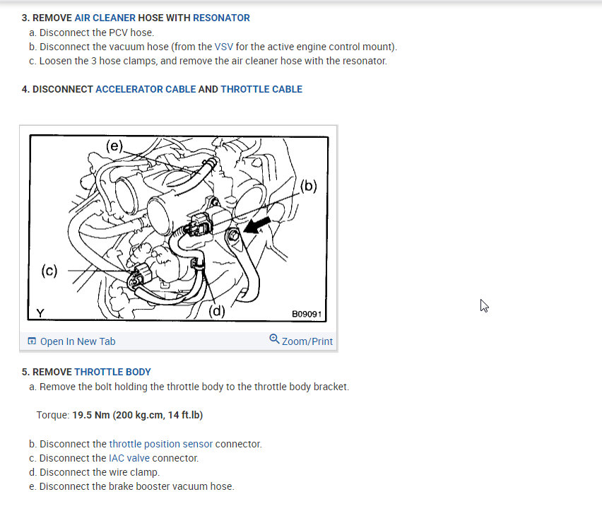

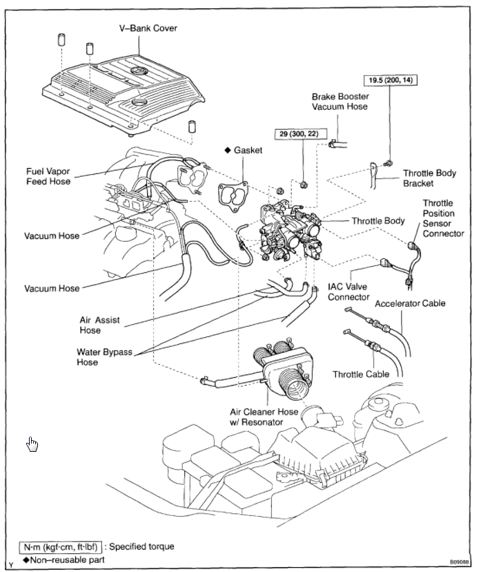

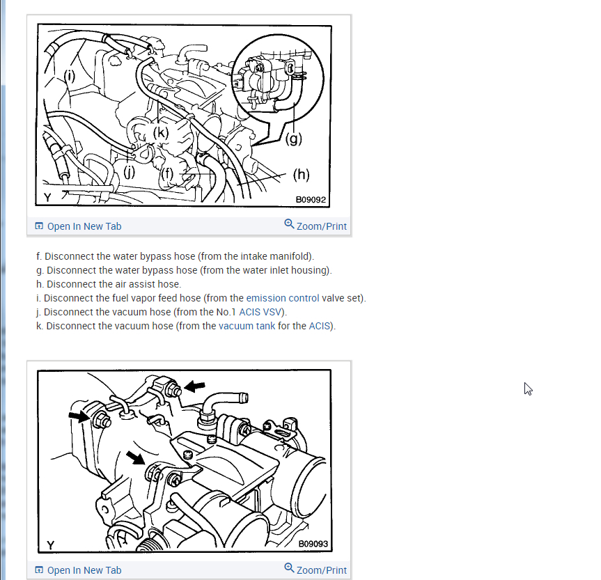

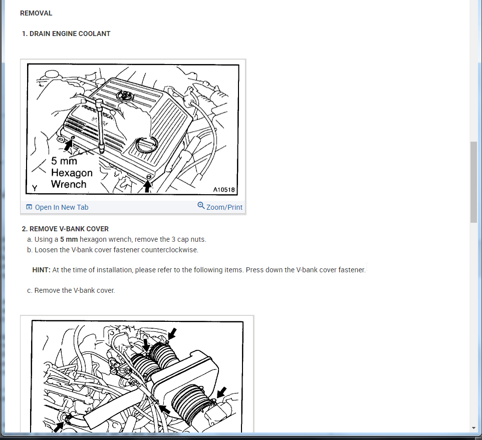

I just want to clear something up from that last post. When you say the gas pedal seems stiff, did you mean the brake pedal because you said the booster was replaced.
However, if you meant the gas pedal then that is interesting and something I did not think of. You have a throttle cable on this vehicle and they were known to stick and the throttle body would stick open and that would cause this issue.
I would at least remove the throttle body and clean it and then make sure the cable moves freely.
Below is the info from the manual on this.
Sunday, April 18th, 2021 AT 6:49 PM
