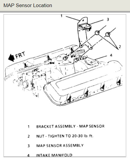

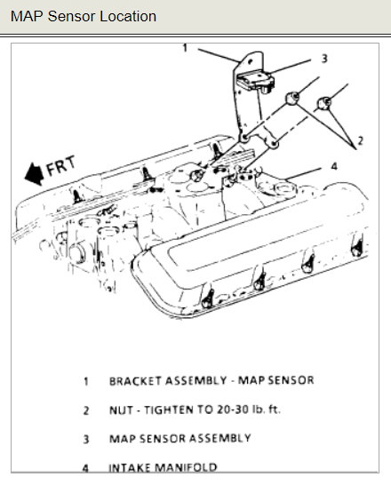

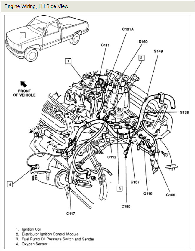

Hmm that says to me low fuel pressure or bad MAP here is a guide and a diagram to help you see whats going on.
and
https://www.2carpros.com/articles/engine-backfires-while-running
Wednesday, April 4th, 2018 AT 7:31 PM

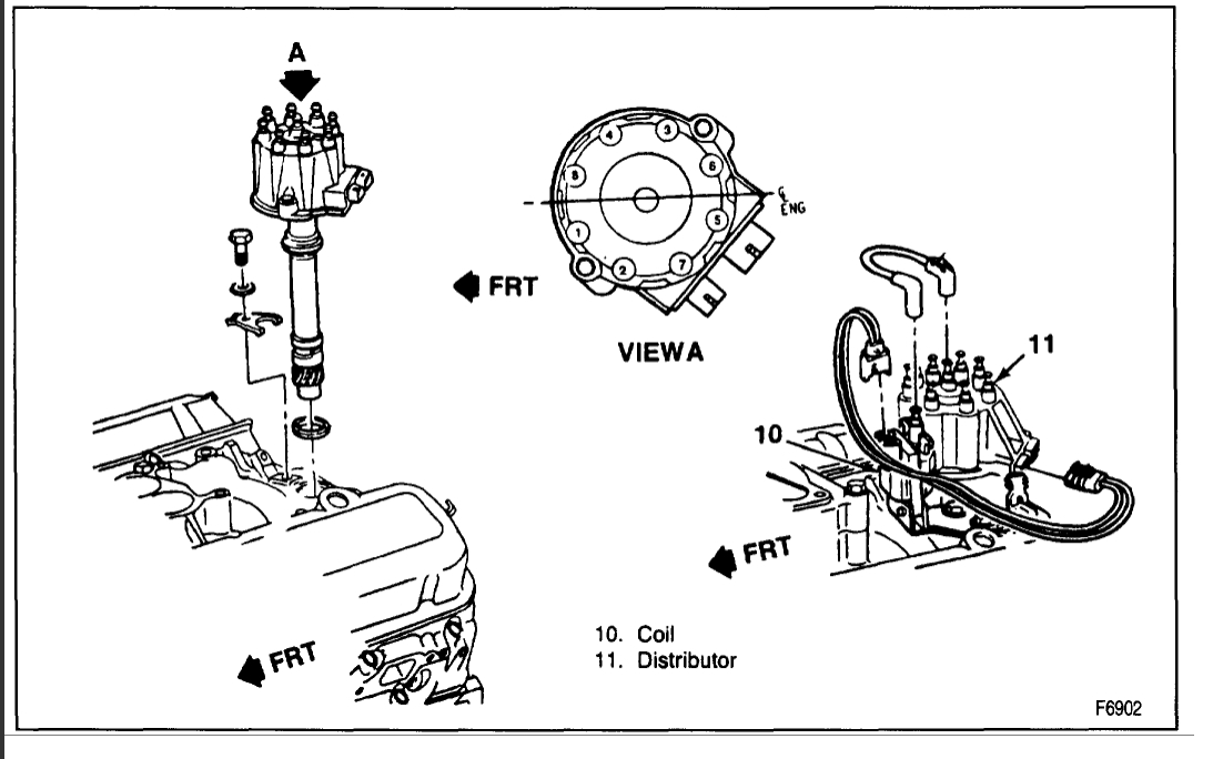

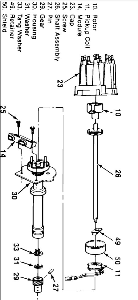

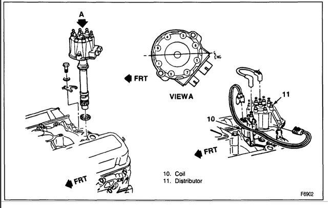

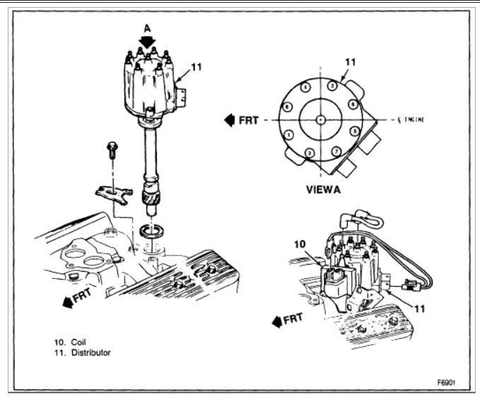

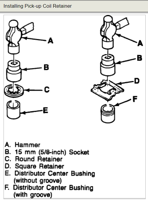

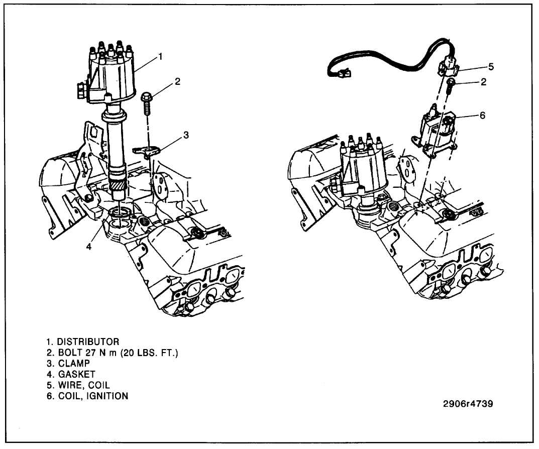

Sorry I didn't think of this earlier but have you changed the ignition module? Here is a guide to help you see what you are in for when changing the unit out.
I would also do the pick up use AC Delco
Saturday, April 7th, 2018 AT 12:22 PM
KURT2913
  • 5 POSTS
Ok I just picked up the new ignition control module and getting ready to install it now. I'm praying its the problem. I will let you no how it turns out

I put the new ignition sensor module in and the truck ran fine all day. Thank you so much for your help
