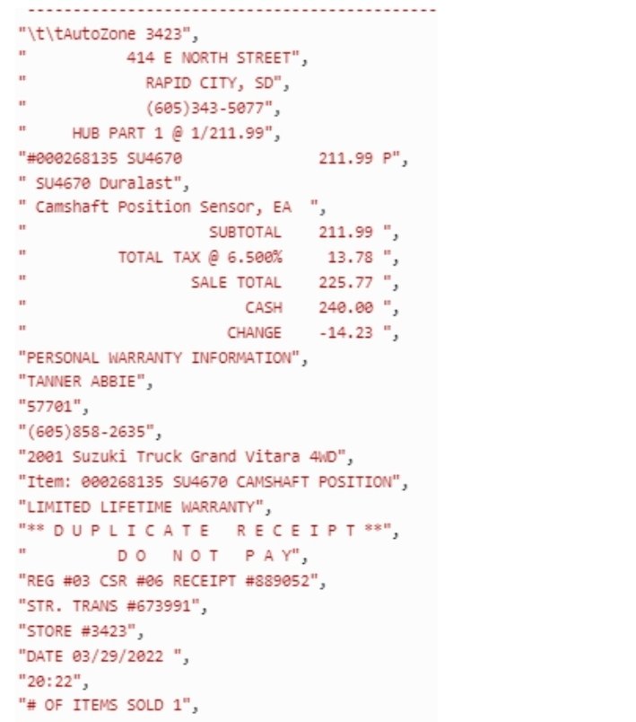

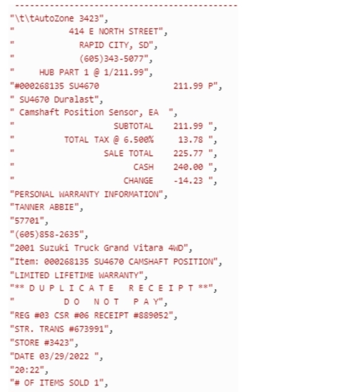

I attached receipt so you are able to see the exact part replaced.
