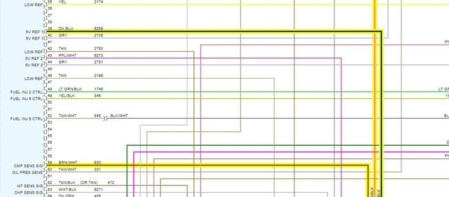

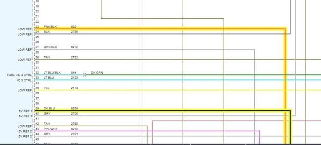

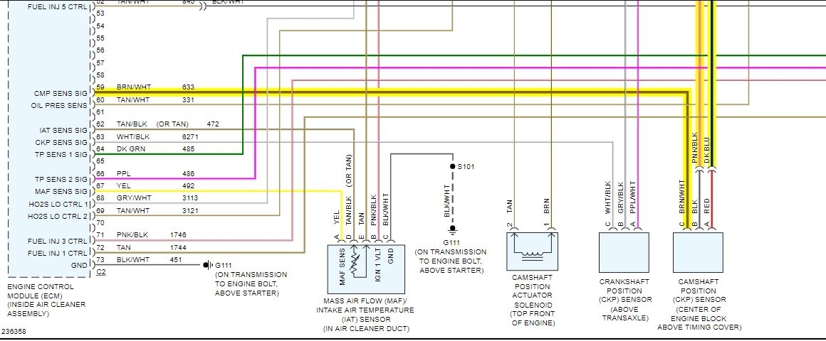

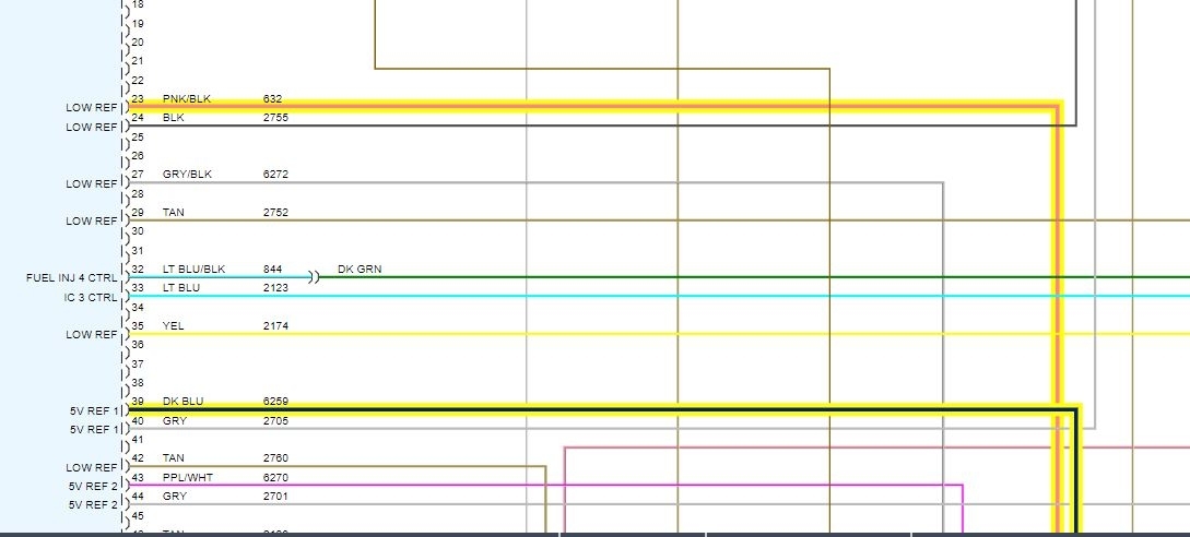

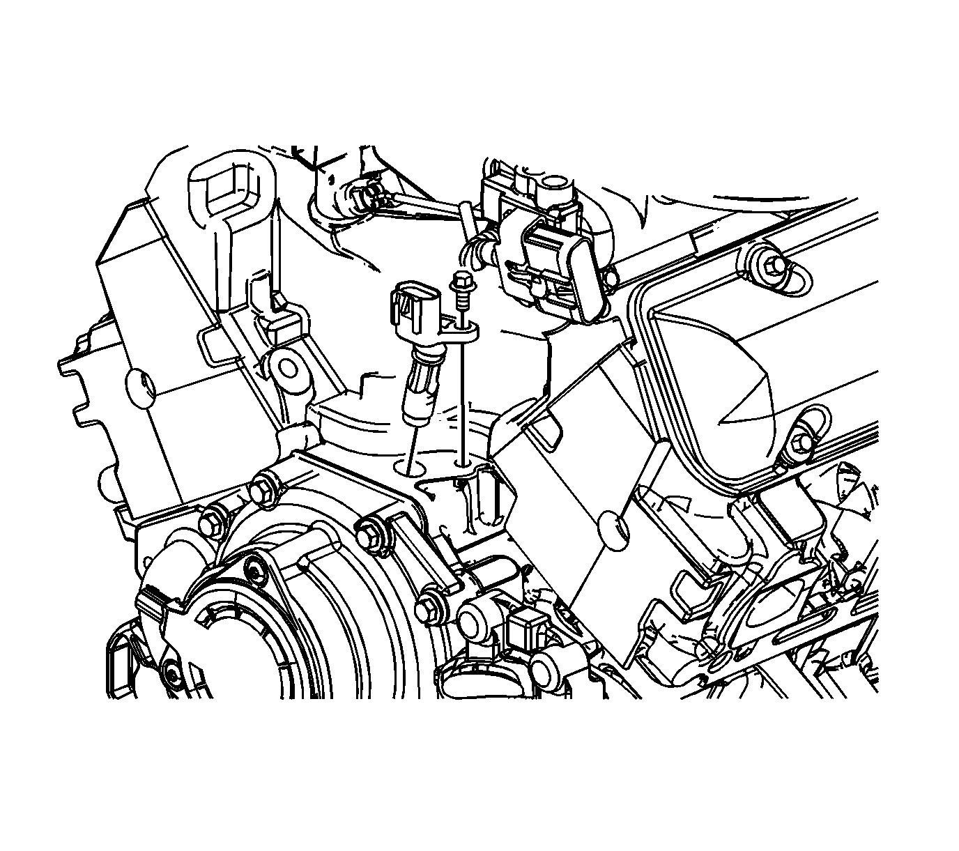

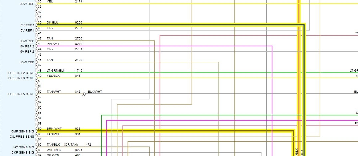

Where does the 2 wires that plug into the camshaft magnet under the powersteering pump run to and connect to? Please help anyone
Friday, January 25th, 2019 AT 3:28 PM
  • 110,192 POSTS
Hi and thanks for using 2carpros. Com
As far as the wires, they attach to the camshaft position sensor. The sensor relays a signal to the engine control module (ECM) and from that, ignition timing and fuel injector timing.
I attached a picture of the component. Take a look and let me know if that is what you are referring to. Additionally, pics 2, 3, 4 are wiring schematics that show where the wires go and where they connect on the ECM. I had to break the schematic in three because of size. I highlighted the wires you asked about.
You will note the three connections. One is a low ref, one 5 volt ref, and one CMP signal. Here is what those mean:
Low Ref = Ground
5 volt Ref = Power from the ECM to the sensor
CMP Signal = The reference from the sensor to the ECM
