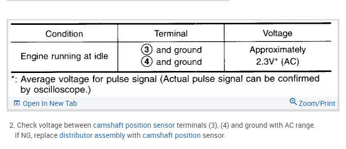

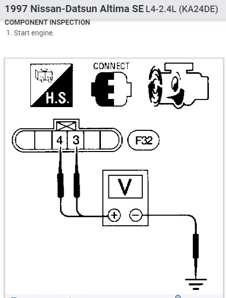

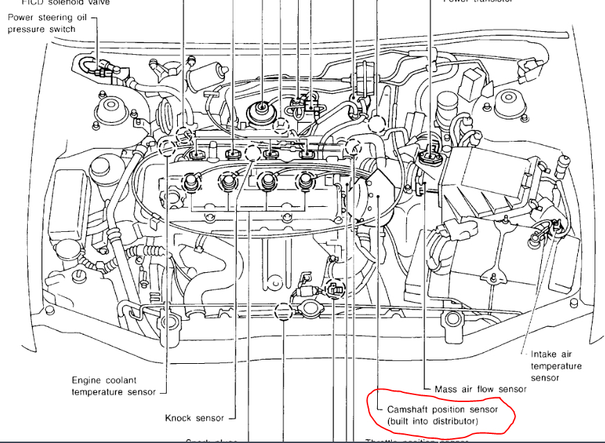

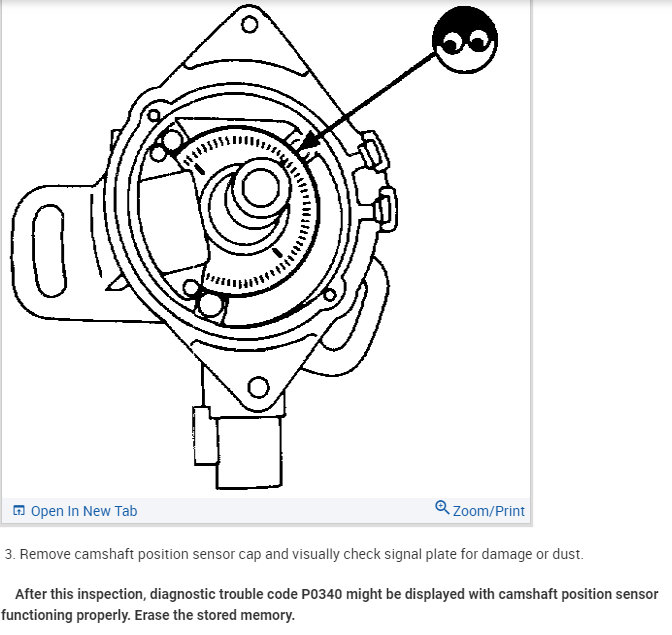

I have been trying to locate my camshaft sensor. Please help how do I change it?
Friday, September 20th, 2019 AT 5:01 PM
DANNY L
MECHANIC
5,648 POSTS
Hello, I'm Danny.
The camshaft position sensor is within the distributor assembly. Here is a basic tutorial showing what's involved for replacement:
https://www.2carpros.com/articles/camshaft-angle-sensor-replacement
I've attached pictures below showing location and steps on how to test.Hope this helps and thanks for using 2CarPros.
