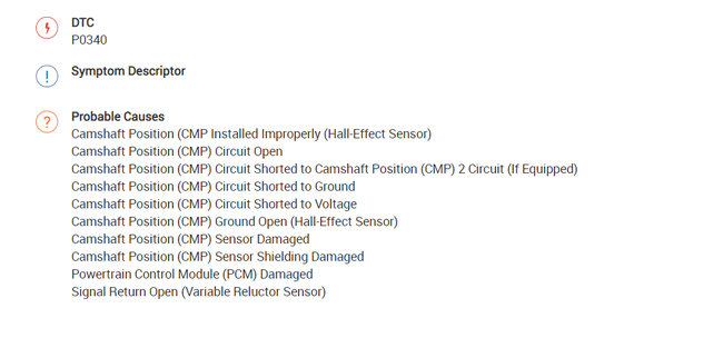

Truck runs good on highway way but fuel mileage down. Sometimes stalls when coming to a stop and rough idle. Also whirls over a lot to start. Only active code is p0340. Changed sensor as old sensor failed resistance test and had something loose inside it. New sensor gives same issue. Truck will throw a stuck lean O2 sensor code when preforming a key on engine running diagnostic test.
Also checked and repaired open in wiring from sensor to ECM. I have not removed new sensor to recheck it yet.

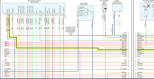

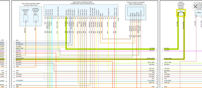

I attached the possibilities for the 340 below. You will need a voltmeter to test the reference voltage to the sensor.
https://www.2carpros.com/articles/camshaft-angle-sensor-replacement
Can you give me all the codes that were set?

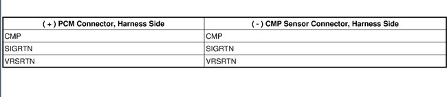

DR8 CONTINUOUS MEMORY DTCS P0340 AND P0344: CHECK THE CMP SENSOR RESISTANCE
Note:For vehicles with 2-pin CMP sensors, measure the circuits listed in the table that apply to 2-pin sensors. For vehicles with 3-pin CMP sensors, measure the circuits listed in the table that apply to 3-pin sensors. Refer to connector end views at beginning of pinpoint test.
Ignition OFF.
CMP Sensor connector disconnected.
Measure the resistance between:
Is the resistance within specification?
GO to DR9.
INSTALL a new CMP sensor.
CLEAR the DTCs. REPEAT the self-test.
DR9 CHECK THE CMP CIRCUIT FOR A SHORT TO VOLTAGE IN THE HARNESS
PCM connector disconnected.
Ignition ON, engine OFF.

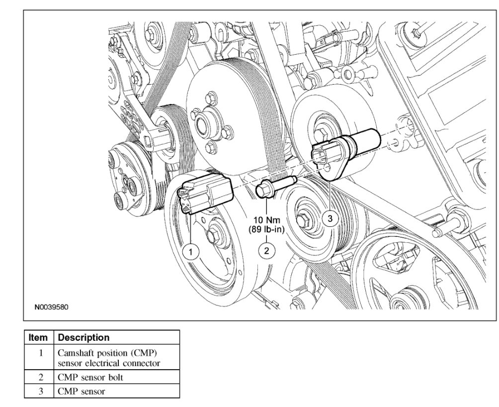

Removal and Installation
1. Disconnect the camshaft position (CMP) sensor electrical connector.
2. Remove the bolt and the CMP sensor.
To install, tighten to 10 Nm (89 lb-in).
3. To install, reverse the removal procedure.
Lubricate the CMP sensor O-ring seal with clean engine oil prior to installation.
