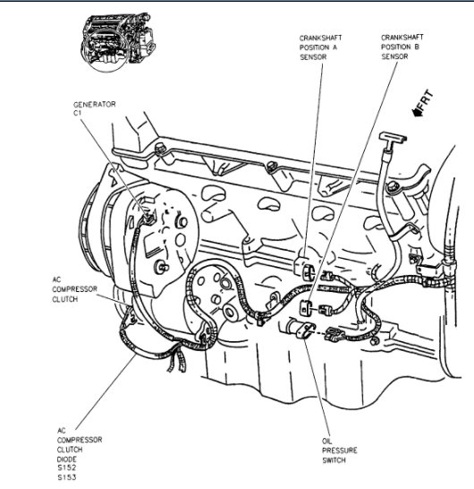

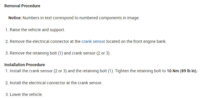

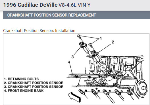

Here is the information you requested. You have 2 crankshaft position sensors on your vehicle sensor 'A' and sensor 'B'. Here are a few tutorials for you to view on how to change a crankshaft position sensor and related symptoms:
I've attached a few picture steps below on how to replace a crankshaft position sensor including their locations on your car. Hope this helps and thanks for using 2CarPros.
