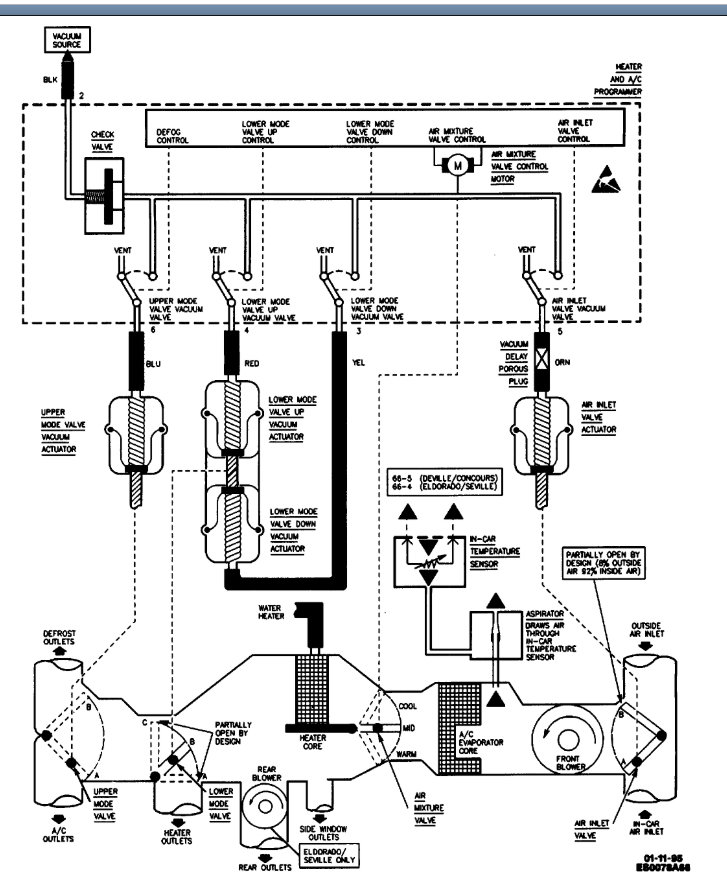

where can i find a vacuum hose diagram

https://images.2carpros.com/forum/automotive_pictures/416332_1996_cadillac_deville_vacuum_diagram_1.jpg
There you go that's for the plain deville not the deville concours.

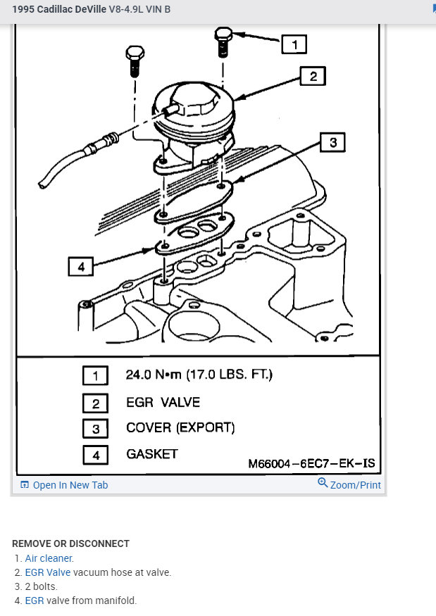

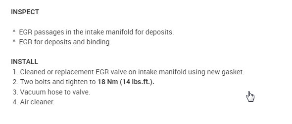

I just recently replaced the EGR valve on my car because it was stalling out idling rough and a bunch of other things. now I have a few vacuum lines coming off of the EGR that were so old and dried out they broke. so I'm looking for a diagram to replace them and or can I use a different vacuum hose like a fuel line but smaller? it's also rattling but I'm guessing that's due to the vacuum lines being broken. correct?
Nov 25, 2020 at 5:49 PM (Merged)
  • CAR REPAIR CONTRIBUTOR
Looks like the EGR only has one vacuum line. If you have multiple lines then I suspect someone may have tapped into the vacuum source.
If this doesn't making sense then I would suggest taking few pictures so we can take a look at them.
