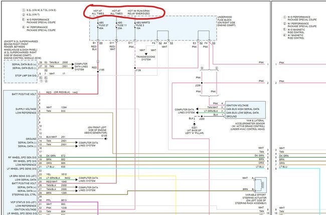

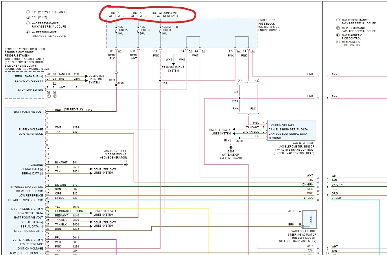

Well all of those codes including the new 0450 code are from the EBCM. IE the ABS brake control module. It is a known failure item on many GM vehicles.

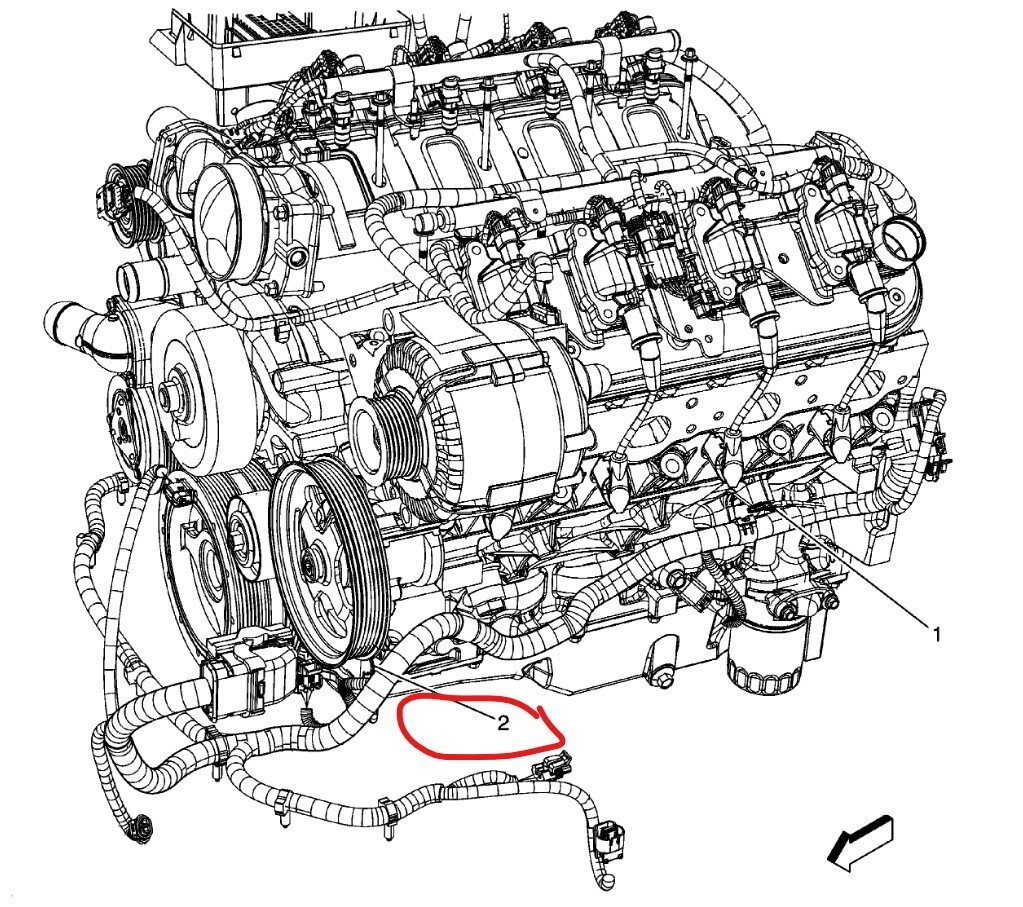

I would check the fuses for it first, verify it has power. Then check the grounds. Both go to the same spot, the ground point on the block near the power steering pump. If it is corroded, you can get all of those codes.

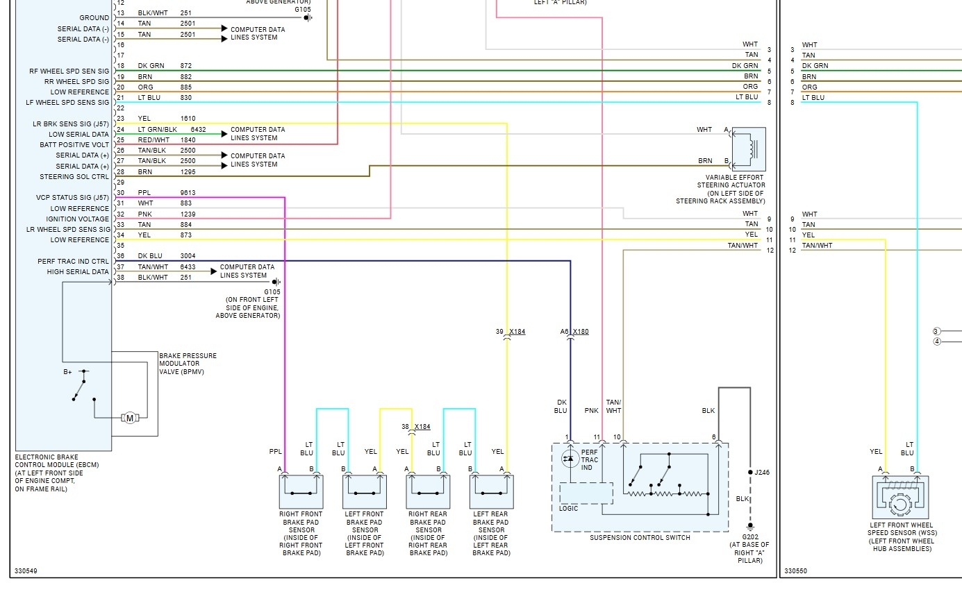

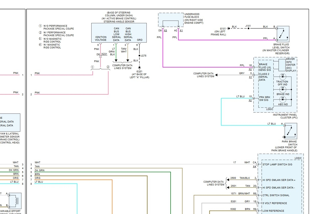

Removed EBCM connector tested and found +12VDC on two end connectors and found ground on opposite two end connectors, cleaned female and male connections with electronic cleaner, let dry and reconnected. Checked nearby chassis bolted ground, wire good, ground good, cleaned and reconnected.
I am still getting Service Vehicle Soon, Service Active Handling System, Service Antilock Brakes, and Service Traction System in the message window of instrument cluster and the following codes: U2100-00, U0101-00, U0100-00, U0140-00, C0450-5A, C0561-71, P0300-00 (will address at another time).
Is it time to get a new Electronic Brake Control Module Kit? If so, do I have good used/reman. Options or should I source new? Can the factory part number be provided as I may only need the EBCM kit and not ABS Pressure Modulator Valve?

If the powers and grounds are good then it's likely that the EBCM is bad. The part number for the original is 25994201. That replaces the module and the solenoid coils pack. However you also need a scan tool and J2534 programming link and a GM account to be able to program the new unit to match your car.
