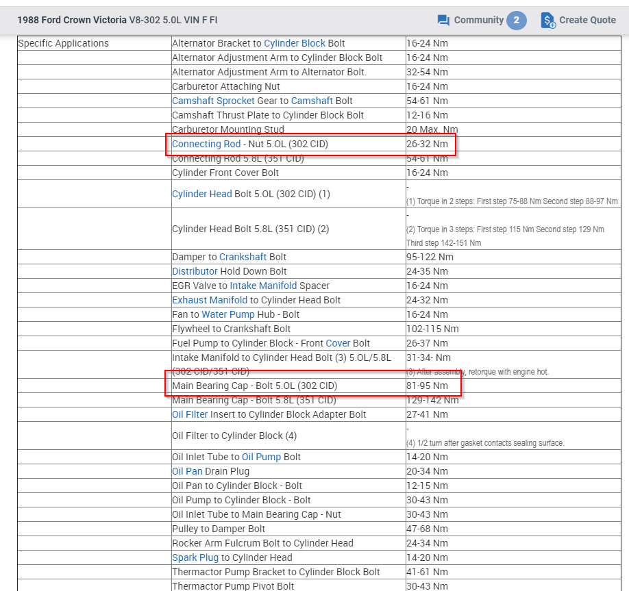

I’m going to try and save it and I need one more thing. Is there torque specs for the rod bearing caps?
Thursday, September 10th, 2020 AT 7:02 PM
Haha. Sounds great. Be sure to keep us posted on how it turns out.
Sorry, I thought I gave you that. I attached and circled the connecting rods and main bearings.
Thursday, September 10th, 2020 AT 7:54 PM

I looked at it and it’s a different engine then what I thought.
Friday, September 11th, 2020 AT 3:30 PM
Sorry. I am not following. Do you not have the 5.0L? Did I give you the wrong info? Just let me know if you need some other info and I can get that if needed. Thanks
Friday, September 11th, 2020 AT 7:17 PM
SKOOTER24
  • 275 POSTS
It’s 5.0 EFI. He said it’s the Mustang version for the Crown Victoria.
Friday, September 11th, 2020 AT 7:19 PM
SKOOTER24
  • 275 POSTS
Fox body I believe is what he said. It looked totally different then what the instructions say, I got confused. I thought someone had changed the motor out but he said there’s the regular Crown Victoria and the Police Fox Body Mustang style one. Can you explain? I need help on this one.
Friday, September 11th, 2020 AT 7:22 PM
Okay. Does this vehicle have the Police Package? Meaning was it a former cop car? If so, it has a 5.0L engine but it was out of the Fox Body style Mustang which just had more horsepower then the standard Crown Vic and they put a different engine controller in it to aid in pursuits.
Your torque specs are going to be the exact same with or without a Police Package.
Friday, September 11th, 2020 AT 7:37 PM
