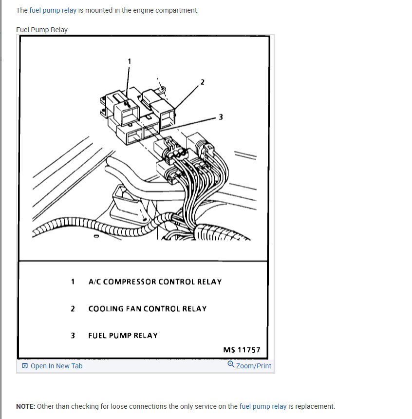

Engine turn but not stat. No fuel in the injectors line. I think it's the relay, I don't know the location. Please help. Thanks'.
Saturday, May 23rd, 2009 AT 7:42 AM
MECHANIC
18,907 POSTS
You may be correct and that is a great place to start. Here is a guide that will help with testing the relay:
Also, to confirm this is a fuel issue you could check the fuel pressure as well.
Here is a guide that will help with this as well:

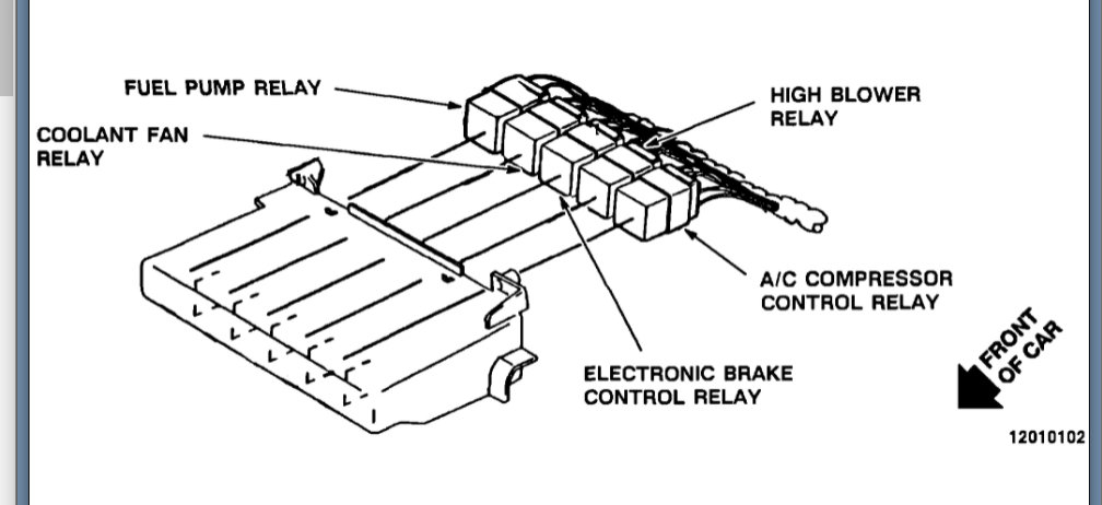

Below you will find the location and process on how to replace the relay. Please run through this and let us know what you find. Thanks
