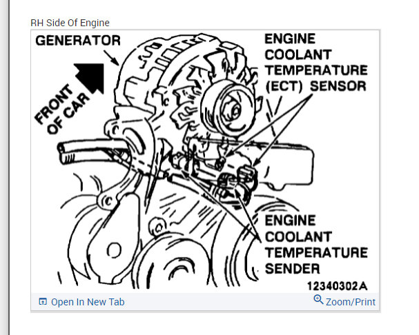

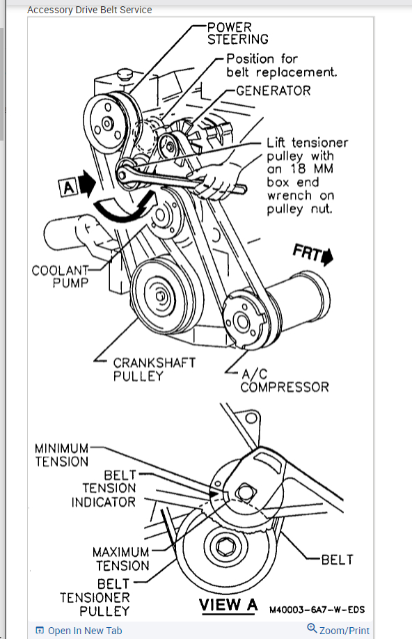

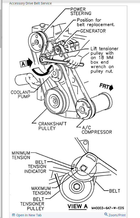

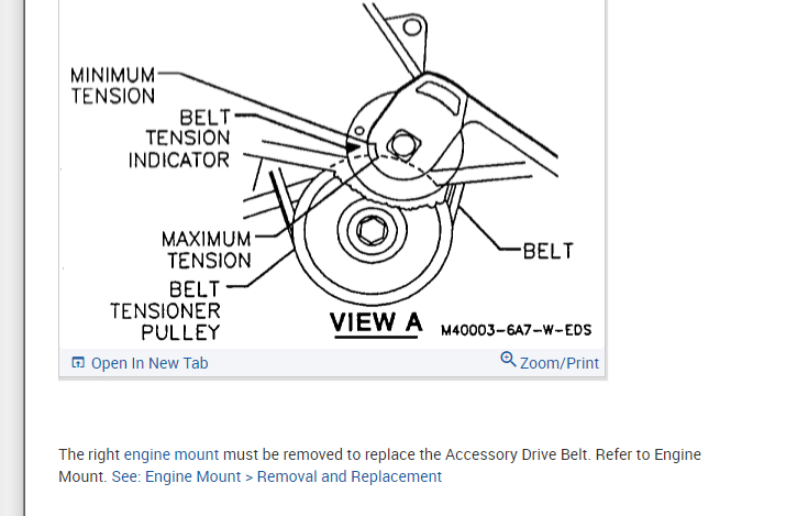

How do you replace the alternator, or release the belt. Is there a belt tensioner and if yes where?
Tuesday, April 7th, 2009 AT 12:31 PM
Basically the alternator is pretty easy. You remove the belt and then just remove the two bolts that hold it in place.
Here is a guide for each of these:
Next here is a guide on how to replace the alternator:
https://www.2carpros.com/articles/how-to-replace-an-alternator
Below you will find the complete diagram from the manual on how to replace the belt.
Please run through this info and let us know if you have other questions. Thanks
