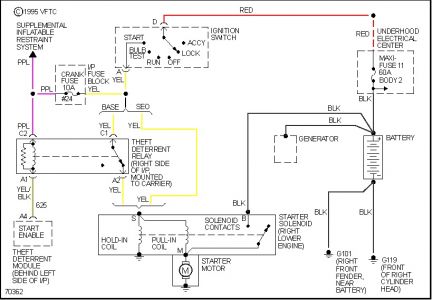

When I turn the ignition switch the car does nothing.I have a brand new battery and everthing works(lights, radio etc) and the starter is also good because someone was able to crank it from the starter under the car but it would not stay crunk.

One posibility is your security system. Check for applicable trouble codes. I cannot help you bypass the system, if that is the problem. Any testing, make sure the tranny is in park or neutral and the e-brake is set.
https://www.2carpros.com/forum/automotive_pictures/170934_roadmaster_starter_circuit_1.jpg
