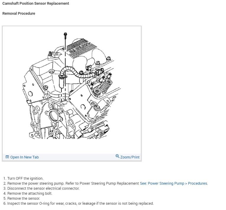

I have a problem with my rendezvous not starting after short runs. If I run the vehicle for approximately thirty minutes or less and turn it off it won't start again. I if run it for longer I can turn it off and it will usually restart with no problems. When it will not start I have to wait anywhere from thirty minutes to approximately two hours and it will start up with no problems. I had it looked at when I had a no start condition and was told the the cam sensor was working, but that either the PCM was not receiving the signal, or the PCM was not processing the signal. I know that the issue is that something is not telling the vehicle to send fuel because when it will not start. I can hear the fuel pump running and all it does is just turn over, but when I wait for a bit and try I can hear a click and fuel running through the rails and it starts no problem. Fuel pressure, spark have been tested and are okay under no start conditions. Could the lack of a cam senor signal cause this issue? I have heard that it should still start if the cam sensor signal is bad.

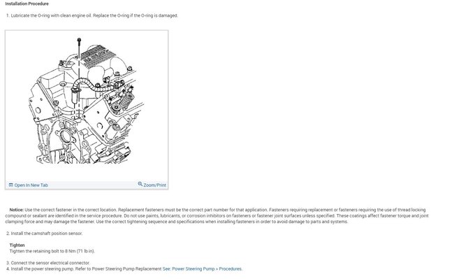

If cam sensor is bad it will not start. The cam sensor controls injector pulse, which is what lets fuel into the engine. Sometimes when electronics fail they do it when warm/hot due to expansion which creates loss of connection internally. You should have it scanned for codes to see what errors the computer has stored.
See the guides below. Scanning and cam sensor replacement. Not vehicle specific but will give you an idea of what is going on.
https://www.2carpros.com/articles/camshaft-angle-sensor-replacement
See the diagrams below for make/model specific instructions and pictures.
