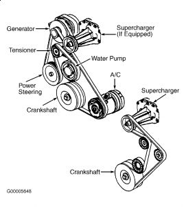

Does anyone have a diagram for the serpentine belt?

DOCFIXIT
  • 18,828 POSTS
This guide will walk you through the repair with the diagrams for your car below.
3.8L

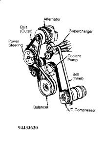

I need the routing diagrams for a 2003 Regal GS serpintine belts.

MHPAUTOS
  • 31,937 POSTS
Hi there,
Belt information.
Mark (mhpautos)

JAEGERSTEIN
Thanks! I removed it thinking that there was a diagram on the car.

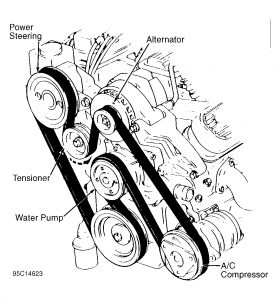

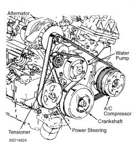

ZACKMAN
  • 4,202 POSTS
Look at you VIN. Match the 8th digit with the diagram. They all use a tensioner. Splash removal is not necessary. The belt is removed from the top of the engine.
VIN "1"
https://www.2carpros.com/forum/automotive_pictures/55316_3800vin1_2.jpg
VIN "K"
https://www.2carpros.com/forum/automotive_pictures/55316_3800vink_2.jpg
