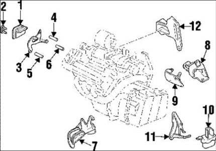

I have to take off the whole bracket to replace the serpentine belt. I am having significant trouble taking off the motor mount! I have to disconnect the mount from the block and there is a nut on a screw behind a pulley that will not allow me to take the bracket off from the engine block.

To better assist you please let me know if your model is just a Park Avenue or an Ultra. Also I need to know the fourth and eighth digit of your VIN and your engine size in liter.

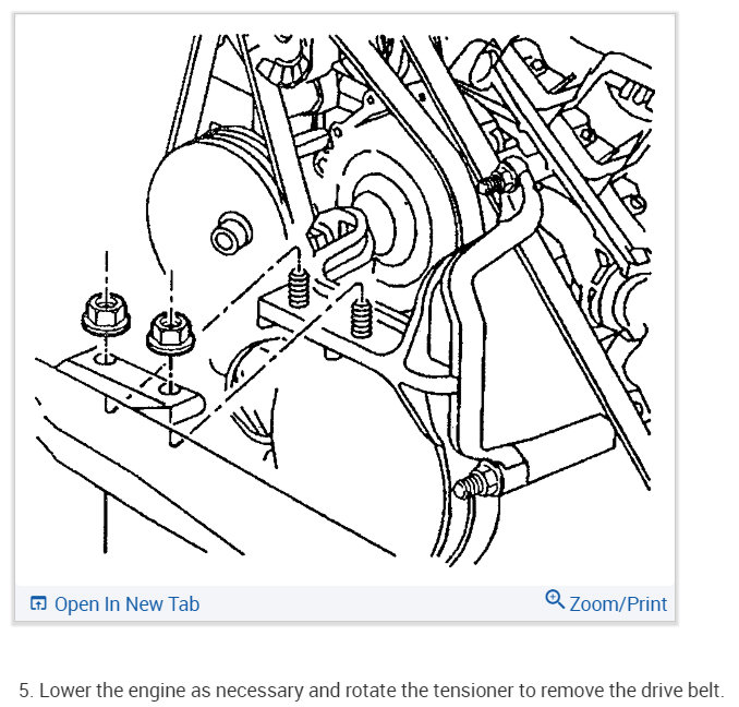

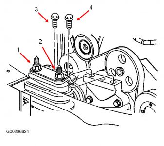

I have attached a picture and numbered the hardware. Which number are you having problems with?

It is a 3.8 liter V6 this diagram is only the top part of the mount. On these latter model Park Avenues (1998) you have to take mount off to take the serpentine belt off. This diagram only shows the top part of the mount which only connects the mount to the frame of the car. The mount is attached to the engine block with the serpentine belt running through the mount. My model is the type where I have to jack up motor but also the model where the belt does not come off unless I take the mount off the engine to take the belt off. The nut to take the mount completely off the engine block is somehow going behind a pulley with holes that will not align so you can actually put a socket on it.

Well, good news bad news. First lets get the bad out of the way. This is what I have in the manual. So I do not have a visual on removing or replacing the mount.

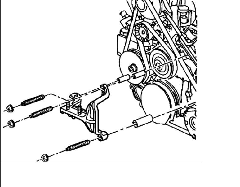

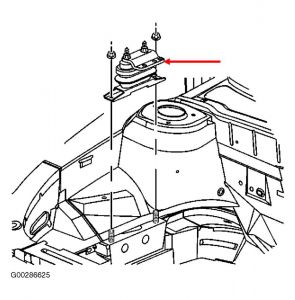

Okay, I have attached another picture but shows the mount from the frame side. If I understand you correctly the mount part you are having problems with mounts to this part where I have the arrow? Yes?
https://www.2carpros.com/forum/automotive_pictures/248015_4_45.jpg
So you have the bolts off where it mounts to that mount but not where it mounts to the engine and you said you can not get to it due to a pulley. Which pulley? On many of the models I have worked on the pulleys if they have bolts on them either have holes in them so you rotate the pulley to the position you need to put the tool or they press on/off like power steering pulleys many times. Which is your case?
Can you send a couple of pictures of what you are looking at?
You do have a jack under your engine and it is braced, yes?
If the picture in m head is correct on what you are talking about if you disconnect the mount connected to the engine from the mount on the frame at that point can you jack the engine up just enough to clear getting the belt out between them?

No the problem I am having is with the mount to engine block not mount to frame like you have in the diagrams. And yes the pulley is the power steering pulley but the holes will not align so that you may stick a socket in them to take the nut off the screw behind it. The diagram I am seeing only shows how to take the mount off the frame when on the Park Avenues you have to take the mount off the engine block to take the belt off. The belt does not simply slide off or come off without you removing the mount fully as if it was broken and you were replacing it totally. What would better serve me is how to take the mount off the engine instead of taking the mount off the car body. And yes this pulley has holes in it. But the aligning is improper to actually stick a tool in and take it off. I wish I could I would have had this done a week ago, lol. My belt does not go around the mount in these cars it is in between the mount. I have searched extensively and it seems to be quite a few people having this problem even on this site I have not found a definitive answer to others questions about this because they are asking the same one I am maybe not as clearly though.

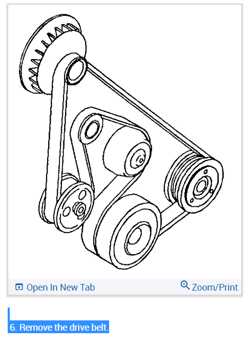

Okay, located the below picture. If I understand we need to get 5 and 6 apart or out of the way. Am I correct?
https://www.2carpros.com/forum/automotive_pictures/248015_5_4.jpg
I do not have any visuals in my information other than the picture above.

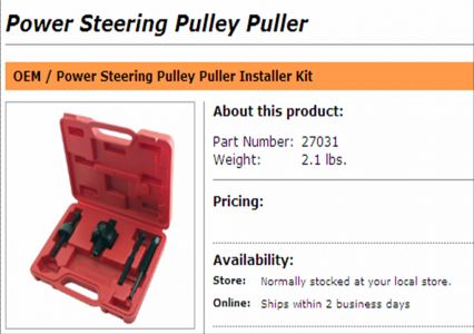

Can you remove the pulley off of the power steering pump (AZ has the tool) and then get to the mount bolts and remove the mount that way?

Wow! This site will be forever bookmarked. That is exactly what I need. Yes, because it is 6 that is the bolt that runs behind the pulley with the on it that I need to get off so I can fully take the mount off. I will try to go to AutoZone and get a tool to try and get the pulley off. Seems as if that is the only way to get to the nut because the holes in the pulley do not align and the nut is so far behind the pulley. I cannot even get a tool on the head of the nut, and the mount does not slide off 5 far enough so I can slide the belt through. So is that the only way to get it off. Yes I know I can probably get to it if I took the pulley off (I think the power steering pump). But I wanted to know if I could indeed take that pulley off without messing anything up, as I did not see any tool in my box that would take it off. And if that was the only and right way? Thanks man, you guys are great. My first time using the site and I am very impressed. Thank you.

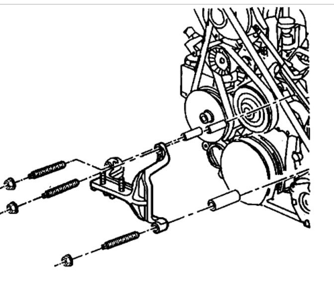

I attached the tool for your viewing.
https://www.2carpros.com/forum/automotive_pictures/248015_2_108.jpg
If you have never used one ask them to make sure you understand because the parts that go over the pulley end are in two halves and a ring slides over. Make sure you have the rod centered in the middle of the pulley so you do not damage the pulley and mark where the pulley is to be sure when you press it back on right. Slow and steady are the two words for the day.
You use the same tool to press it back on so lube the shaft a little.
Also, before you remove it stand to the side or look from above to get a good view of how all the pulley wheels line up. That way when you install you can verify. If it is a fraction off you could shred the belt you probably do not want to do this twice but think how fast you would be the second time!
Next, for your safety please make sure you jack/brace the engine so when you remove the mount the stress is off of it.
Yes, you can remove the pulley wheel without messing t things up if you use the right tool and go easy.

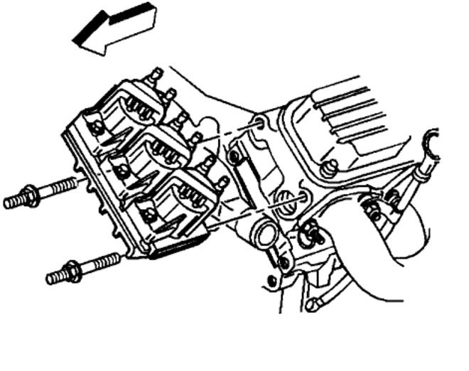

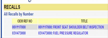

Hey, also one last thing, it looks like you may have some recalls on your vehicle. The dealer may fix these for free. Please contact the dealer service department, give them the VIN number of your car and have them check on these to see if they apply to you.

I have done this job if you remove spacers 4 and 5 (by removing studs (Inverted torx ) with a little effort you can change the belt.

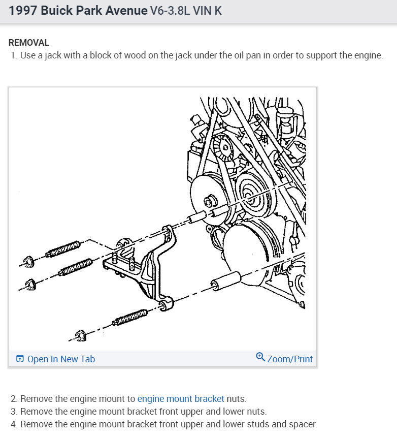

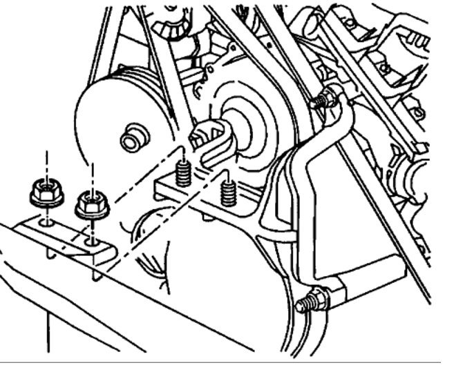

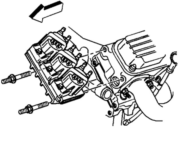

Yep soon of these designs have little to be desired. Here is what the book says about changing the belt with diagrams below.
INSTALLATION
1. Install the drive belt.
2. Install the engine mount bracket front upper and lower studs and spacers.
3. Install the engine mount bracket front upper and lower nuts. Tighten the nuts to 78 Nm (58 ft. Lbs.).
4. Install the engine mount to engine mount bracket nuts. Tighten the nuts to 87 Nm (64 ft. Lbs.).
5. Remove the floor jack.
Check out the diagrams (Below). Let us know what happens and please upload pictures or videos of the problem.

You must use a jack under the engine pan to hold it up while doing the job, also remove the negative battery cable before you begin. Here are some diagrams (below) of the job being done. Please let us know if you need anything else to get the problem fixed.
