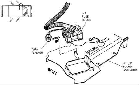

WRENCHTECH
  • 20,761 POSTS
On the top side of the sound insulator on the driver's side.
http://www.2carpros.com/forum/automotive_pictures/561653_Turn_signal_flasher_97_Lesabre_1.jpg
