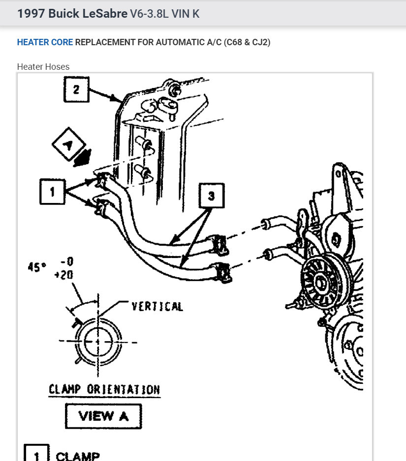

How do you repair or replace the heater core? I keep having to reach behind the glove box to see is it is leaking and it is.
Monday, December 14th, 2009 AT 9:27 AM
JDL
  • 16,098 POSTS

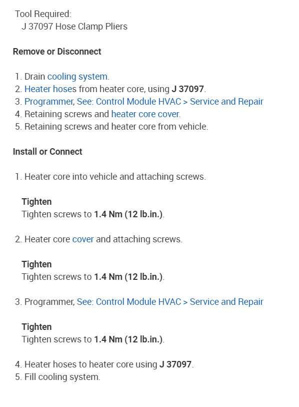

The heater core is not to bad it comes out the front check out the diagrams below, start by draining the coolant. Here is a guide to help you step by step with instructions in the diagrams below to show you how on your car.
https://www.2carpros.com/articles/replace-heater-core
