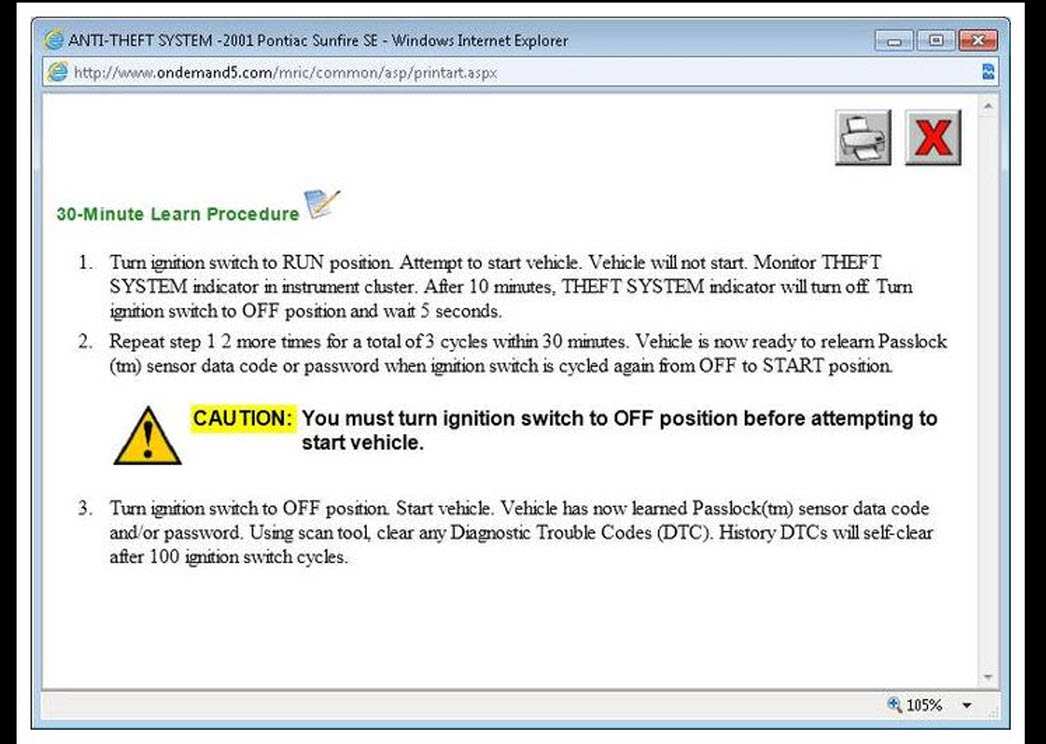

Try resetting security system may be the cause. When you turn the key to the on position without cranking the engine over can you hear the fuel pump run in the tank for 5 seconds?

Thank you so much. For the fast reply I will check that today.

That is for a Pontiac though. Will it work?

The newer GM cars 2000 and up disable the fuel injector pulse for anti theft not the starter like the older GM cars. I looked at this one and do not see a tie in for the starter through the anti theft. With the key in the start position see if you have power to the small purple wire at the starter?

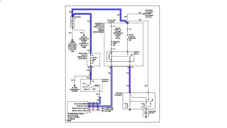

  • 75,992 POSTS
Battery and connections a okay-check and test the ignition PCM fuse 10amp, start circuit breaker, starter relay and ignition switch
https://www.2carpros.com/forum/automotive_pictures/12900_starter_32.jpg

SATURNTECH9
  • 30,869 POSTS
Yes, bad starters can do that work one minute not the next. Check what I asked and let me know what you find.
