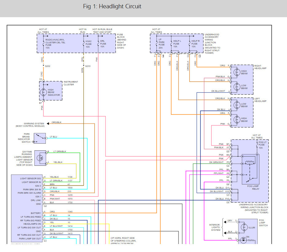

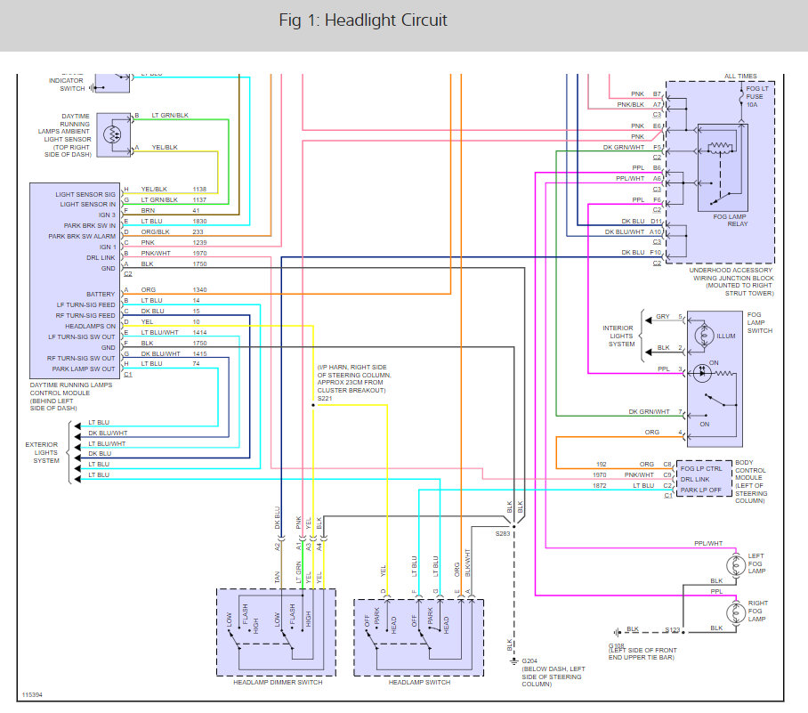

no low beams i changed the bulbs and light switch on dash

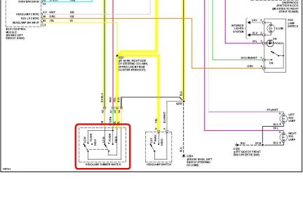

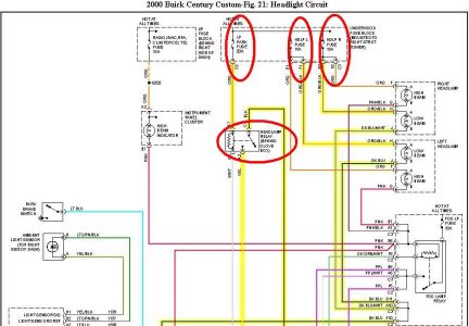

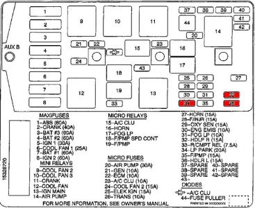

Fuse #32, 34, and 36 under the hood Headlamp relay is behind the glove box Headlamp dimmer switch

It sounds like the headlight switch is going out, but to be sure here is a guide to show you how to check for power coming out of the switch to confirm the failure:
Check out the diagrams (below). Please run some tests and get back to us.
