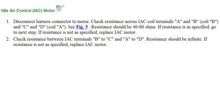

When I drive the car then shift back into park the car will rev itself once then cut off. I have cleaned the IACV and the car still does it. Is there anything else I can try?
Tuesday, July 20th, 2010 AT 7:49 PM
JDL
  • 16,098 POSTS
Any applicable trouble codes? Idle issue only? You may need to take the throttle-body off and clean it?
https://www.2carpros.com/forum/automotive_pictures/170934_iac_ohms_test_1.jpg
