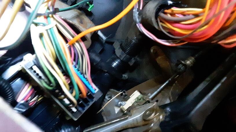

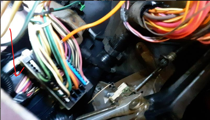

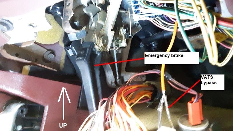

The most specific information I have was found just hours ago, and I have spent as much time as I had taking photos and searching, according to the information. That information says, "The (starter-enabled) relay is found under the left-hand of the instrument panel, above the instrument panel fuse block. Look just left of the steering column support and on a bracket beside the main wiring conduit. You must remove the fuse block cover and panel."
* I have labeled two of the attached photos for your convenience, but hope they are not confusing in their orientation.

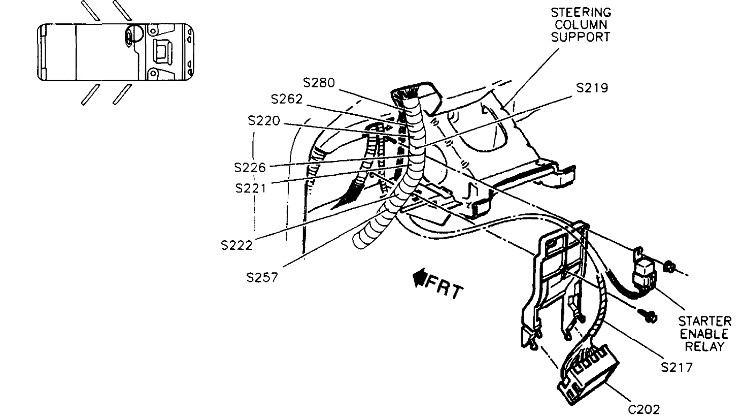

Thanks for the photos, I think I see the relay above the main electrical connector. If so let me know if there is activation voltage and output voltage. I think we are getting closer to fixing the problem.

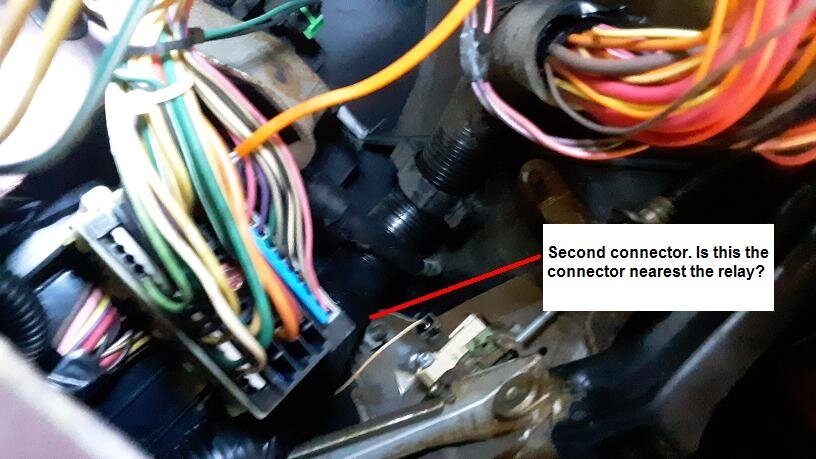

If I can confirm the relay is "above" the main electrical connector-- that is, if I can find it-- replacement of the relay would seem in reach, at last. In the next 24 hours, I must plunder through my collection of auto tools to find the circuit tester.
At this point, I should mention I have located something of interest near the main electrical connector. With my fingers and a small lantern flashlight, I spotted a small cylindrical part, about the size of the relay cube. But its cylindrical/pot shape does not match either the four- or five-bladed relay cubes I bought from O'Reilly (making sure to specify Buick98, 3.8L, LeSabre Custom).
Just a thought-- do you have the ability to use Windows Paint (in every version of Windows) to draw an arrow in the photo to the part you believe may be the relay? Editing an arrow into a photo may be unfamiliar territory for you but could be a practical way for you to show me where the relay hides.
* BTW, I have confirmed I can right-click and "Save As" on any of the photos I posted, and download the photo to my desktop for editing. So, I presume you can do the same to download the photo file, edit an arrow into the photo, and then re-post the edited photo in your response.

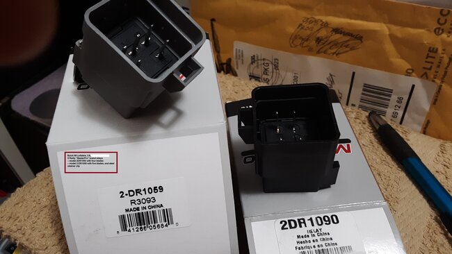

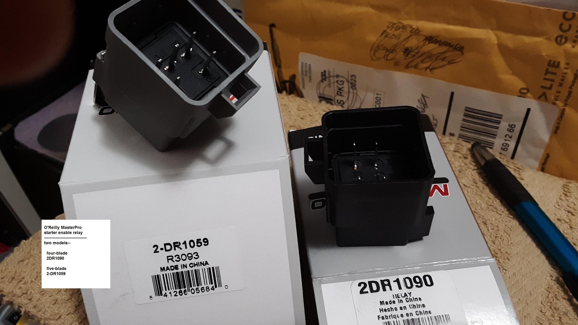

Here is a photo of the starter enable relay, but of two models, one with four blades, the other with five (and a steel retainer clip).
Note the small inset text box, with relay brand and each model number.

Here is another photo of the starter enable relay, which comes in two models-- one with four blades, and the other with five blades (and a steel retainer clip on the relay body).
Note the small inset text box, with relay brand and each model number, which I tried to make more legible.

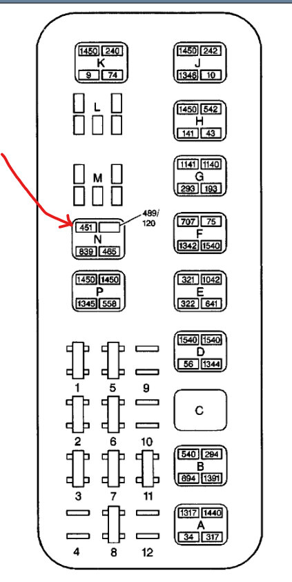

Here is where it looks like it might be, check out the images (below). Please let us know what happens.
Thursday, June 15th, 2023 AT 12:29 PM
ALPHAA10
  • 232 POSTS
Thanks, I'll look behind the main electrical connector, next. What threw me off was the source I quoted, saying the relay is on a bracket beside the main connector-- not behind it.
Thursday, June 15th, 2023 AT 8:08 PM

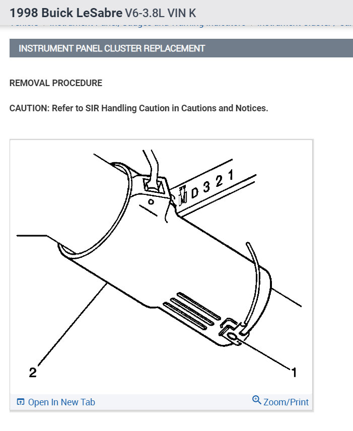

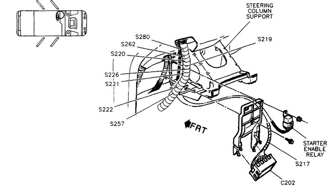

Reviewing my work, I have looked everywhere on the right and left sides of the steering column, and am familiar with the location of the instrument panel fuse block and of the main electrical connector. Nowhere have I found anything resembling the two starter enable relays (4- and 5-blade) I purchased.
Quite a few forums address various GM issues, and some offer schematics which may vary from GM model to model. Somehow, my Buick 98 starter enable relay location is clearly visible on the schematic you sent (in a previous post), yet cannot be located visually in any of the forum offerings. The location you arrowed for me in a photo as a likely position turned out to have nothing behind it.

What I need, at this point, is a clear photo, not a line drawing, which helps orient me to the actual location. Photos submitted by owners/users are usually not very helpful, and there are very few sharp and clearly defined enough to contribute anything.
Am I giving up? Of course, not. I am stuck with this problem. The only way out is through.

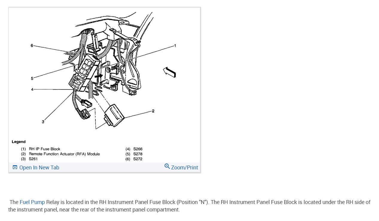

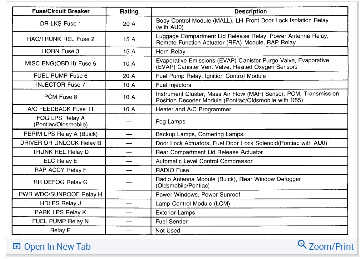

Great attitude! I checked for a 1999 year car and they say it is in the fuse panel, maybe your car was in a mid-year update, please check out the images below. Please let us know how it goes.

The fuse and relay panel layout does not match my vehicle-- but it was a good, intuitive try. Would the VIN help? VIN 1G4HP52K5WH500185

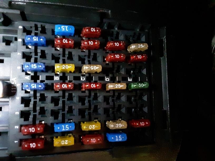

I have attached a photo of the below dash, inside MiniFuse panel (driver left), showing no relay cubes. Tomorrow, or whenever I can catch a break in the rain, I'll take another, better photo of the inside fuse panel (115A) and the outside MaxiFuse panel and outside relay panel layouts.

We know one thing-- the Buick 98 LeSabre 3.8L has a starter enable relay, and its location is clearly indicated in the line drawing and schematic you have provided and which I have found elsewhere, too. But no photos, of course.

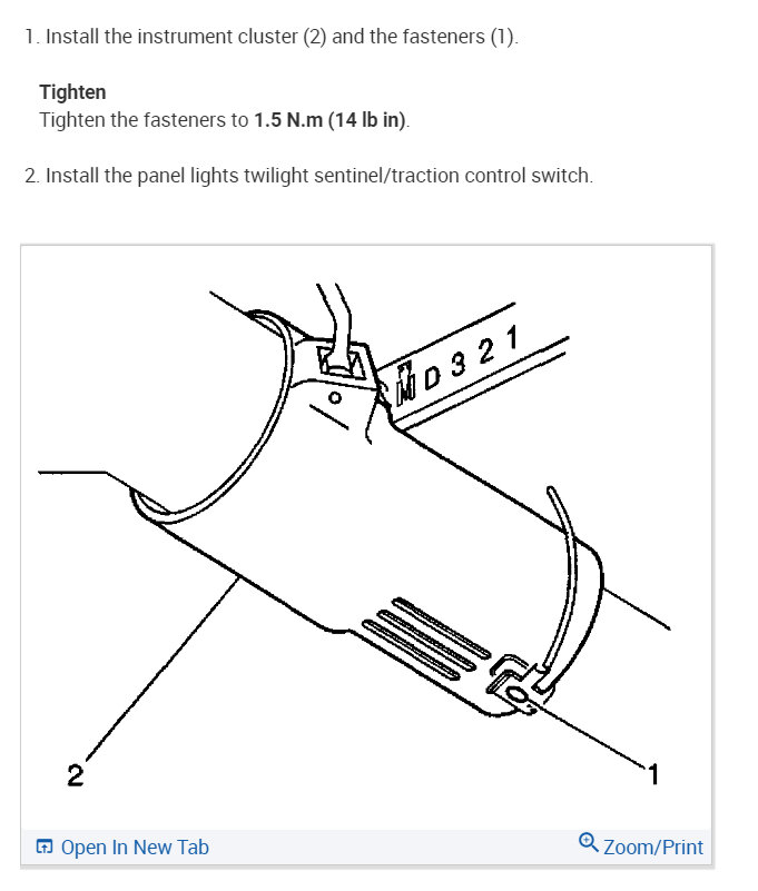

Updating you: My tendonitis has vanished, but the rain continues. Despite that, I have traced the positive line from the battery to the relay and Maxifuse bank, and this is where the fun begins-- at the power distribution bus.
According to all references I have read, the starter enable relay is inside, beneath the dash, but just to be sure, I first looked over each relay or fuse on the firewall power panel, and found no label referred to a starter.

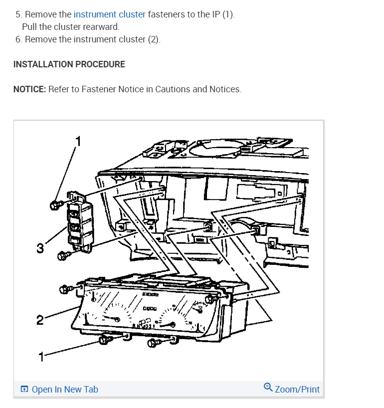

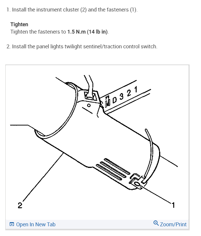

Looking beneath the dash, again, I had no better luck, so far. So, the rest is tracing down from the steering column, to reach the circuit contact points for the starter trigger circuit.
In that regard, a question-- Is it necessary to pull the steering column housing? That is, do you know of a better way to check contact points from the ignition switch?

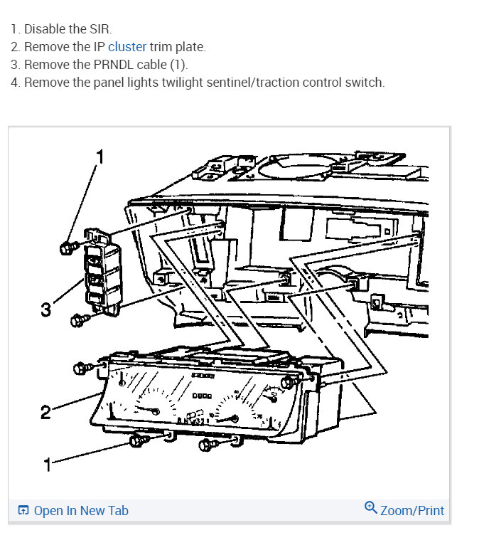

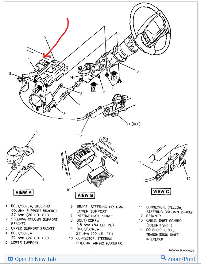

I found a better image for the location of the relay; it is way up above the steering column mounting plate. Please check out the images below.

Thanks, Ken, I'll look for it.
Of course, it is perfectly logical that no accurate Buick-issued instructions for the relay location exist, but another, unlabeled Buick view might contain exactly what we need. Hope so, anyway.
Should I remove anything on the steering column and/or its support bracket to reach this location? I know it's largely up to me to determine that, but I just wondered.

I would use a flashlight and mirror on a stick to help see up and around the column. You should be able to see it.

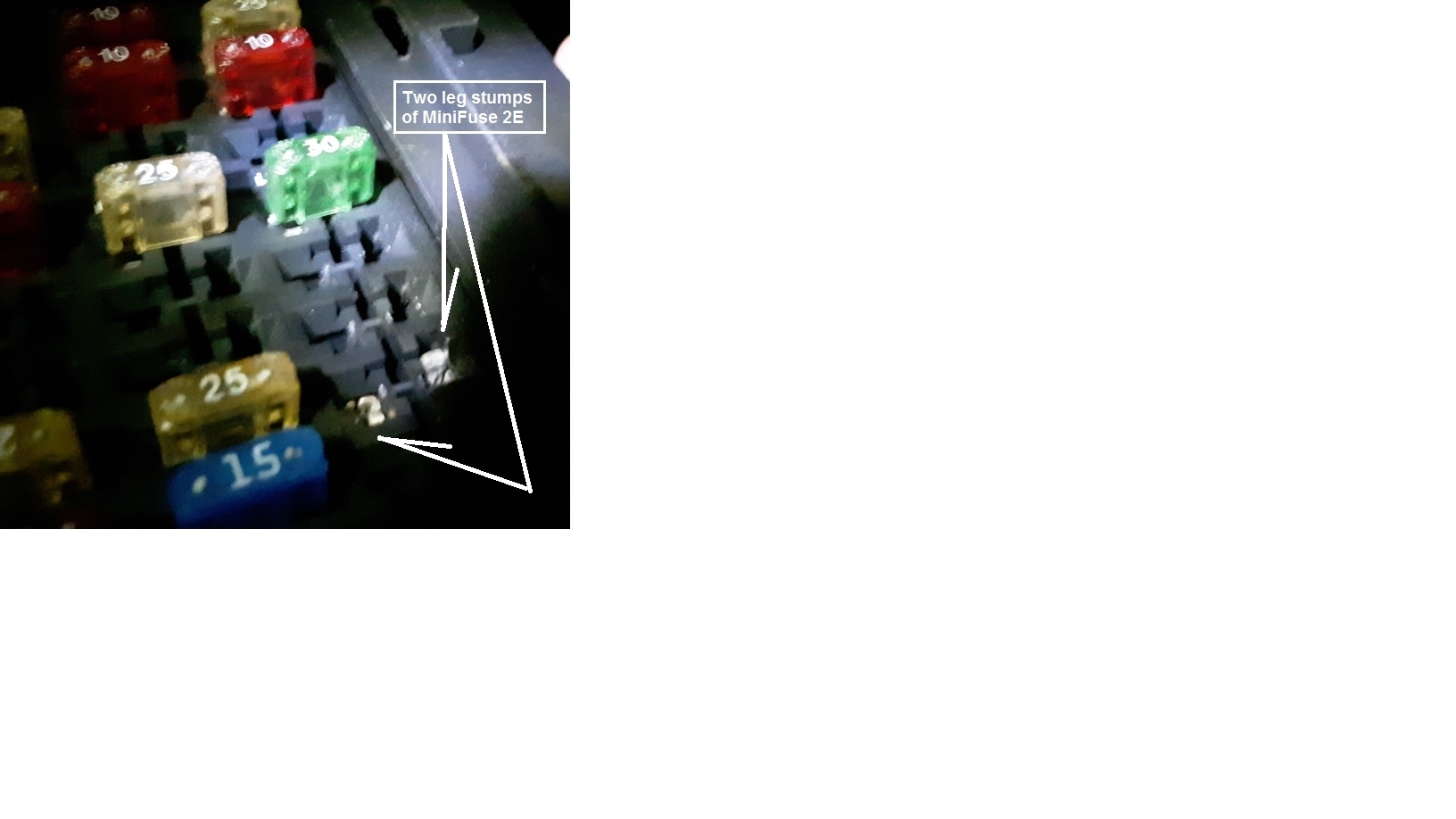

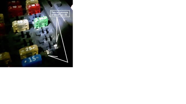

1. I checked thoroughly with flashlight and mirror but saw nothing which matched the size and shape of the starter enable relay purchased from the manager of my local O'Reilly auto parts store. However, while searching in exactly the area you and others suggested, I did find an oddly shaped plastic connector which had four wires running from it-- two light yellow, one light yellow with black stripe and one green. Since the connector was firmly in-place, I decided not to apply major force until I understood which way to pull or pry.
2. Now, the interesting part. I had put away all my tools and was on the way inside the house, when I stopped, recalling the image of something odd I had seen beneath the dash, in the Mini fuse panel. I turned around, unlocked the car, and looked carefully at Mini fuse location 2E, which I had presumed was empty on first inspection (not remembering this is the starter enable circuit fuse location). Looking more closely, I saw-- inside each leg of the socket-- was what appeared to be the silver stump of a Mini fuse.
Apparently, fuse 2E had blown/melted, and its red plastic cap had fallen off, leaving only the two metal remnants of the fuse, deep in the socket. Tomorrow, I'll use a turkey basting needle to probe inside the socket to pry out the fuse leg stump. If I am successful with that operation, the next step is to find another 10A fuse, or borrow one from the spares in the fuse panel and see what happens.
