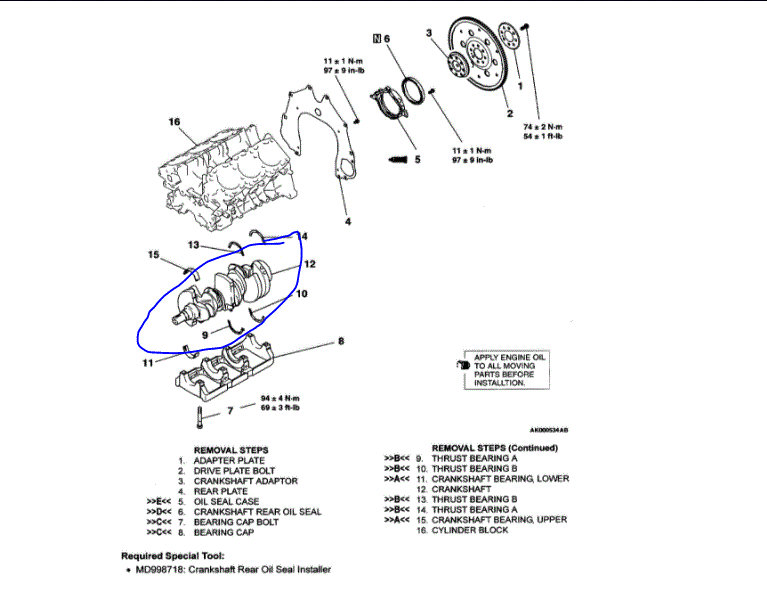

Good morning,
That is the heart of the motor. It is a complete tear down.
It is easier to replace the motor than do this.
Tell him he needs to replace the motor for you. You are not responsible for this since he brake the crankshaft.
I attached a picture for you of the location.

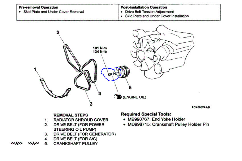

Do you mean they broke the bolt that secures the balancer to the front of the crankshaft?
I attached a picture for you to view.
If that is the bolt, they can drill out the bolt and replace it with a new one.
The only way that could not be done is if they were installing the replacement and they cross threaded the threads. Then the crankshaft has to be replaced.

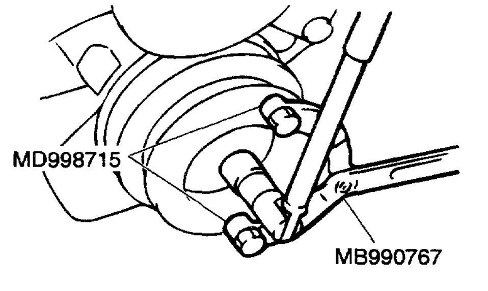

REMOVAL AND INSTALLATION
REMOVAL SERVICE POINT
[[A]] CRANKSHAFT PULLEY REMOVAL
Use special tools MD998715 and MB990767 to remove the crankshaft pulley from the crankshaft.
INSTALLATION SERVICE POINT
]]A[[ CRANKSHAFT PULLEY INSTALLATION
Use special tools MD998715 and MB990767 in the same way as during removal to install the crankshaft pulley.

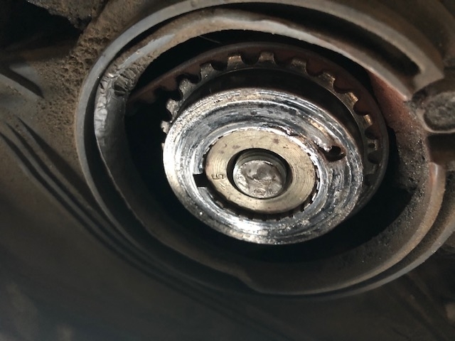

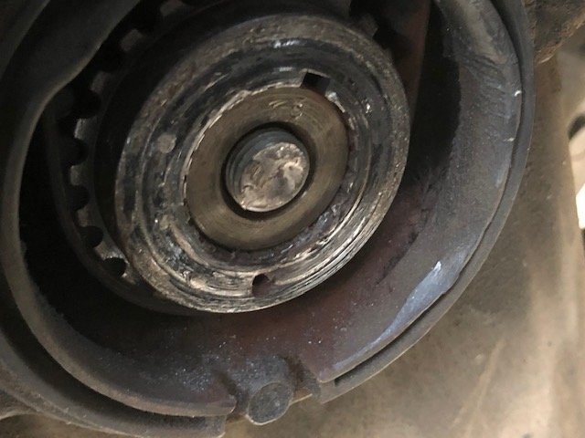

Hi Roy,
I think that is it, but I added this picture to help explain what I am not sure of. This is what it looks like now, which it seems to me that the bolt is broken off inside there, but honestly, I am just not sure what it is.
Wednesday, September 16th, 2020 AT 2:59 PM
The second picture shows a part of the bolt exposed. Does that come out by hand?
The first picture looks like they tried to drill the bolt but they did it off center and will never work.
They really messed this up as it looks the the balancer inner section is still there.
Wednesday, September 16th, 2020 AT 4:14 PM
MAEEAST7
  • 6 POSTS
I tried to loosen the bolt by hand but it will not budge. I'm at such a loss here. In your opinion, what do you think would be the best way to fix this? I know I'm out of my depth here and I so much appreciate your time and input.
