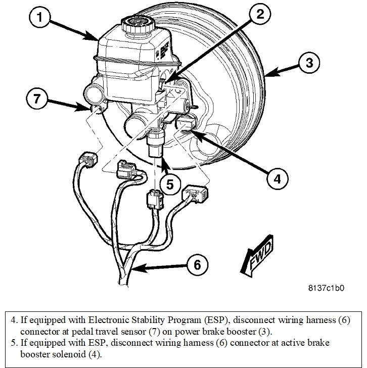

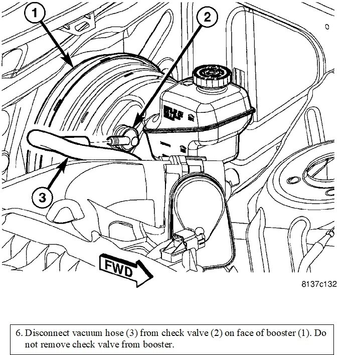

Okay, so I had a shop bleed the ABS module and do other checks and they determined the brake booster is bad, they said I could try replacing the check valve on the booster, but it'll be a long shot. The booster didn't go bad until I was trying to bleed the system after replacing the master cylinder, the brakes work but I have to apply much more force which is obviously a sign the booster is bad, I also held the pedal down as I turned the car off and it raised back up which is another sign, so I guess now I'm looking at replacing the booster, but before I get the part what are some things I should try first? I noticed too sometimes when I apply the brake the throttle indicator will start flashing and the rpms will go up, turning the car off and back on resets it, could the valve actually be bad? Thanks for all your help.
Thursday, April 20th, 2023 AT 1:00 PM
CARADIODOC
  • 34,489 POSTS
Now you're in an area I have very little experience in. Brakes has been one of my specialty areas since the mid 1980s, but in that time, I only replaced one power booster, and the car owner had to teach me about his system. It was an unusual / uncommon design used on an Olds Alero, and failed because his wife dumped the car in a ditch. Those have two valves inside and one can dislodge from the impact of a crash. The replacement booster can be damaged the same way simply by laying it down while transporting it. Professionally rebuilt units come with a special cone around the valve with a notice to not remove it until the booster has been installed. That cone holds that valve in place.
Leave it to GM to dream up such a problem-ridden design. You and I would never believe there was a problem as there still were power brakes, but the owner could sense there was something different or abnormal. That does not apply to any other car model I've ever run into. I have to stop short and not say there's nothing wrong with your power booster, but from many years of experience, I can say this will be a first if the replacement solves the problem.
The only other power assist problem I was ever involved with was on an old AMC model. It turned out to have a defective check valve. A vacuum-operated booster will store enough vacuum to allow for three power-assisted stops after the engine stalls. That's supposed to allow you enough braking control to safely stop the car. With the leaking check valve, that reserve went away the instant the engine stalled, but more importantly, it let it bleed off when intake manifold vacuum was low, as in when accelerating or under high load conditions. The owner only had good power assist during coasting. A new check valve solved that.
Every Brakes class also includes a discussion of low power assist with old, tired engines that don't develop normal intake manifold vacuum. In the past that has been used as an excuse, but I don't know how deserved that was. I've seen plenty of old, tired engines when I was younger, and all of those cars had just fine power assist. This is a gray area that may have multiple parts to each story.

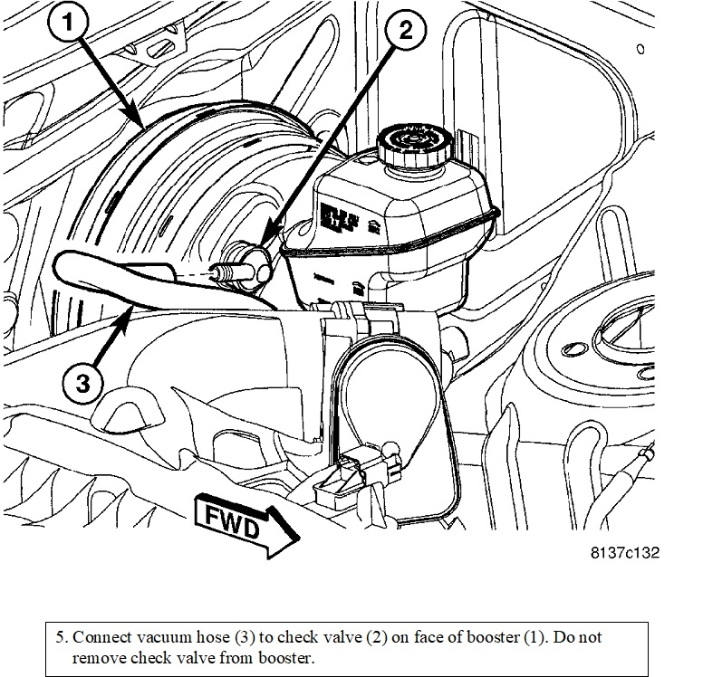

My next question has to do with your comment on the brake pedal pushing back. That is not a characteristic of a vacuum-operated power brake booster. That is a characteristic of a few brake systems that get their power assist from the anti-lock brakes. For example, my '93 Dynasty does not have a vacuum-operated power brake system. It has the Bendix-10 ABS that pumps and stores brake fluid in an accumulator at over 2000 psi. That fluid is used to pulse the brakes up to 30 times per second and to supply the power assist. That system will provide over 40 power-assisted stops after the ignition switch is turned off, or unlimited power-assisted stops until the battery runs down. A scaled-down version of that system was used on Caprice Classic police cars. Neither of those pushed back on the brake pedal, but a few other systems do. I would be hesitant to use that as a clue.
Before you replace the power booster, look at the vacuum supply hose and the check valve. I don't see any reference to a charcoal filter inline with that hose, but if there is one, that could cause a restriction. Consider checking the vacuum supply first. A potential clue here is you will have good power assist after idling the engine for half a minute, but less and less assist with each subsequent pedal application very soon after. It should not take long for that stored vacuum to build back up. That vacuum supply can also be tested with a vacuum gauge. On older models, the check valve had a second port to run the cruise control servo. You could attach the vacuum gauge to that. Yours is electronic, so you either have to tap into the hose or temporarily install an older check valve with that second port. You should see a good 18" Hg, (vacuum) during idling. It may drop a little when you press the brake pedal, but it should recover almost instantly. If it drops significantly, and even more if you pump the pedal repeatedly, there's a restriction in that vacuum hose.
I did see a reference to this booster having two diaphragms which is what made the Olds Alero's design so unusual. This isn't something we normally look into, so I don't know how common this is, but it does make me wonder if there is something that happened inside yours. If you pursue this, here's the instruction for replacing the power booster.

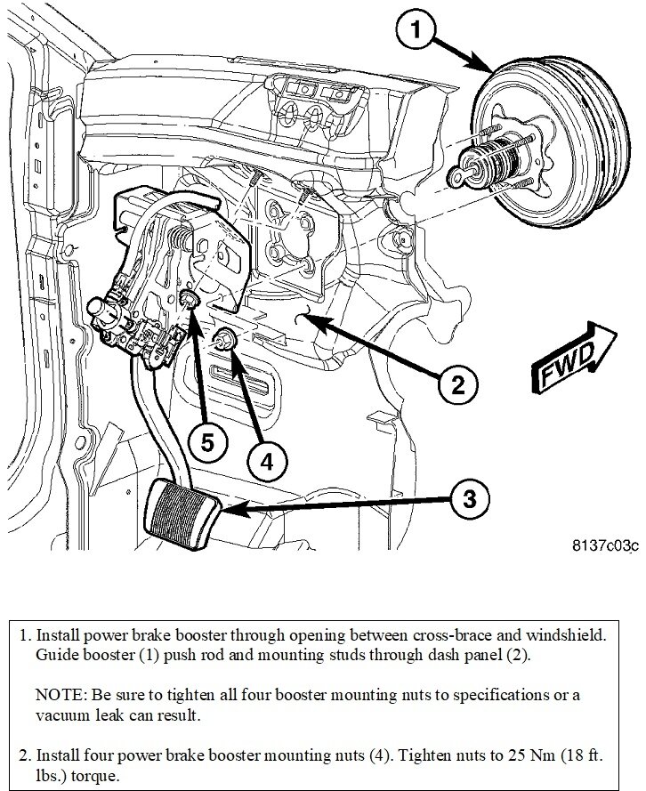

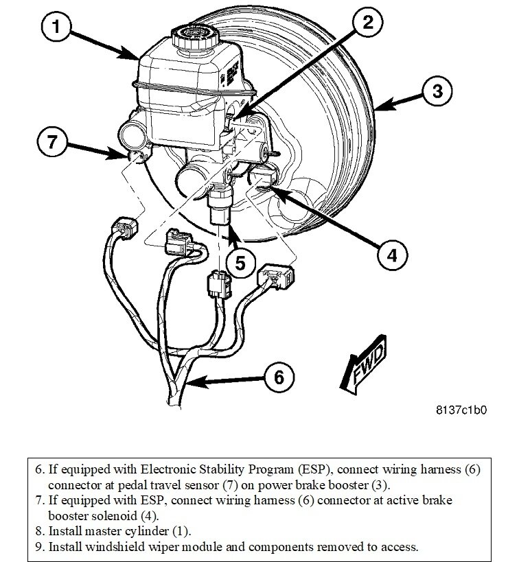

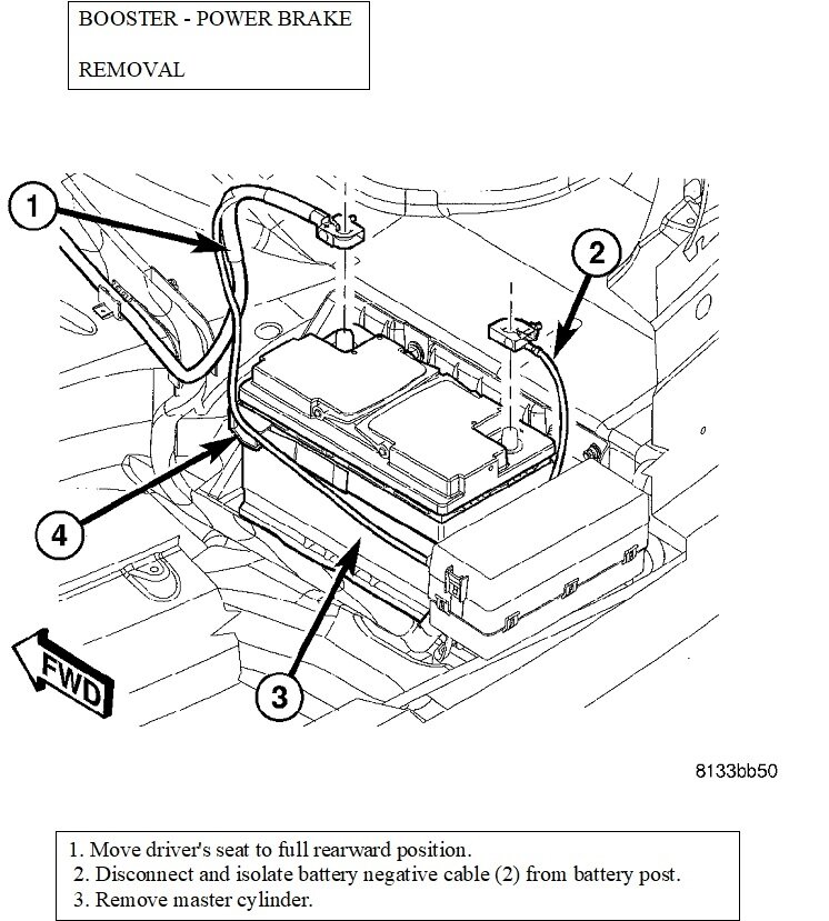

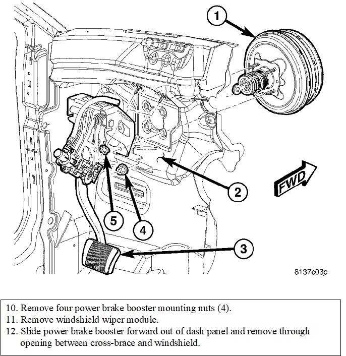

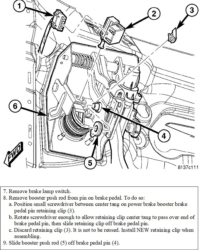

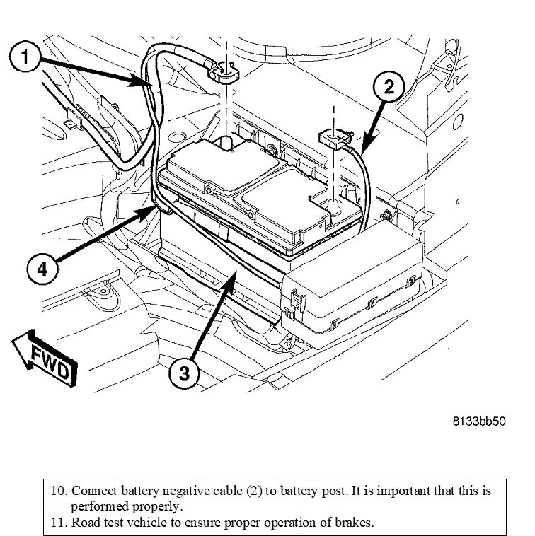

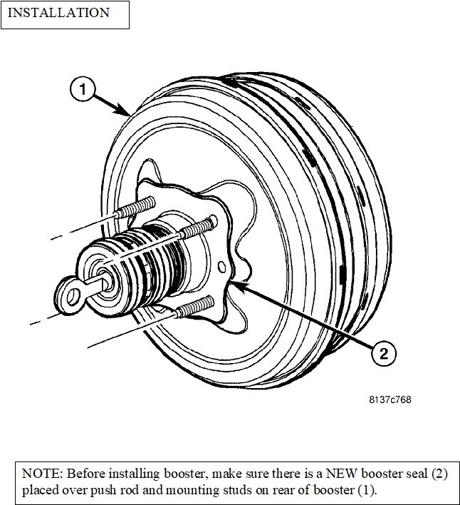

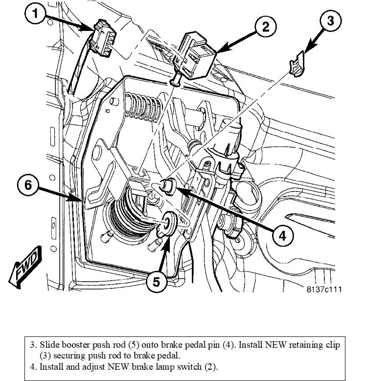

Okay, I successfully replaced the brake booster, it wasn't too hard, the brake pedal isn't hard to push anymore but I'm back at square one with the brakes not wanting to bleed, I'm guessing because the master cylinder had to be removed there's more air in the abs module, I have a very weak flow of fluid from the front calipers and none coming from the rear at all, my thing is that there should be some pressure at least a little but there's none, so I have to bleed the abs module again could I try a trick were since it's already secured off the ground with all 4 wheels off I could just put it in drive and get the speed up a little and hit the brake pedal hard enough to activate the module maybe about 2 or 3 times? Thanks again for all your help.
Sunday, April 30th, 2023 AT 7:18 AM
CARADIODOC
  • 34,489 POSTS
You're the second person this week to ask that. Running the wheels off the ground won't work. We do this to listen to noisy wheel bearings with a stethoscope. As soon as one or two wheels start to rotate, the ABS Computer will see the difference in the four wheel speeds. It will set fault codes related to "wheel speed sensor performance", and turn the system off. The only way to have all four wheels running at the same speed is by driving the car on the road. That's when you have to put it into a skid and open one of two bleeder screws. Not easy to do when you're running alongside the car. Plus, most ABS systems cut out below 9 or 15 mph, so you have to be running sideways that fast with the wrench in your hand.
If the hydraulic controller has been bled already with a scanner, that part of the job is done. There's no need to bleed after replacing the power booster. Doing that doesn't introduce any air into the brake fluid.
As a point of interest, if something were to happen to let air in, if it's very little or if you catch it right away, you still don't have to bleed it out at the wheels, which again, would require another scanner bleeding. Instead, fill the reservoir, then drive the car like normal. That air isn't going to float down to the hydraulic controller. When you press the brake pedal, fluid will go down, and air bubbles will float back up, especially when you factor in the vibration from the engine and from the road. When you release the brake pedal, the fluid rushing back into the reservoir will wash those air bubbles up there with it.
I ran into this every spring with my '72 Challenger. Rear drum brakes have a "residual check valve" in the port of the master cylinder to keep ten pounds of pressure on the wheel cylinders at all times. That prevents air from sneaking past the rubber lip seals in the wheel cylinders when barometric pressure goes up overnight, and it holds the lip tightly sealed to the wheel cylinder's bore. When sitting all winter, that ten pounds gradually bleeds off, then, due to no pressure holding the seals, brake fluid seeps out and I have puddles inside of each rear wheel, on the floor. All I do is refill the reservoir, stroke the brake pedal 1/4 way to the floor a couple of times, then go out for a normal drive. If you have a helper work the brake pedal, you'll see a couple of air bubbles pop up when the pedal is pressed, and some more when the pedal is released. Any more bubbles will work their way out the same way while you're driving. Air always goes up. It only goes down when you push it there with the brake pedal.
I just realized I might have missed something. You said the master cylinder had to be removed to replace the booster. If you mean you removed the two steel lines, then set the master cylinder on the workbench, you only need to do what I just described. Other than that first two inches of line that sit parallel to the ground, no fluid is going to run out and no air will get in. Bleeding at the wheels now must be avoided at all cost because that is when you're going to push air down to the hydraulic controller where it will get trapped again.
If you just pulled the master cylinder forward without removing the steel lines, no air got in and there's no need for any bleeding.

Unfortunately, I had to remove the master cylinder to get the old brake booster out and the new one in, I also had to remove the wiper blade motor and arms and the whole assembly along with the strut bar, none of it was hard at all, just extra work. Bleeding them right now is seemingly a waste of time so I have a buddy at a very reputable shop that will loan me the hand pump canister where you can pump fluid through the master cylinder, I've never used one before so I don't exactly know how to properly use it, I've never had this much of a problem with brakes before either, I almost want to suspect I may have gotten a faulty master cylinder but it was working before I replaced the booster so if it was faulty I wouldn't have brakes then, I was able to stop the car it just took a lot of extra effort, so that's where I currently am at the moment, how do you use a canister bleeder exactly? I just want to make sure I use it correctly, thanks Caradiodoc!
