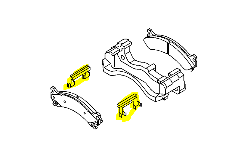

I think something may be trapped between disc and the pads. Check the pads metal holder if installed properly. Check picture.

Thanks. There is a fair amount of stuff wrong with my van. But it has low miles for its age.

There is nothing stuck in there.

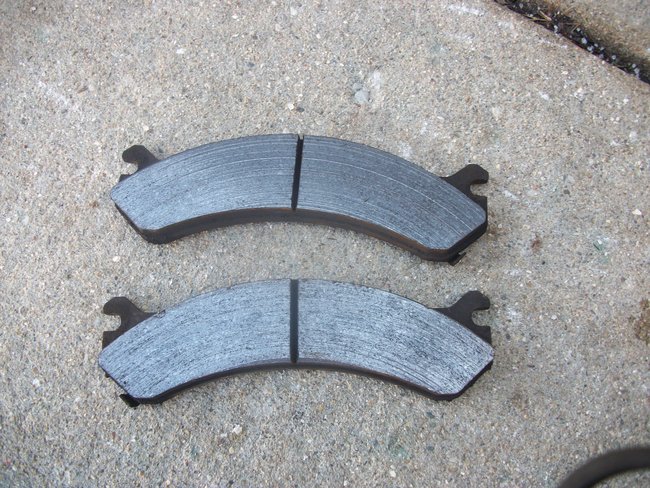

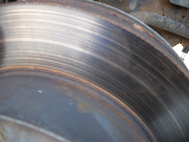

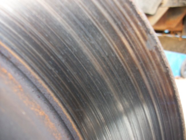

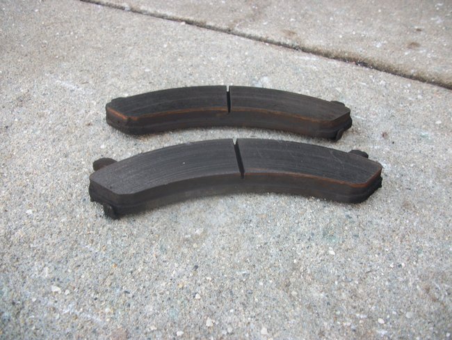

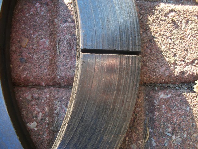

Here are the pictures:
Saturday, February 16th, 2019 AT 12:50 PM

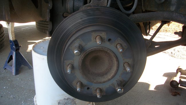

CONRADISH006
  • 53 POSTS

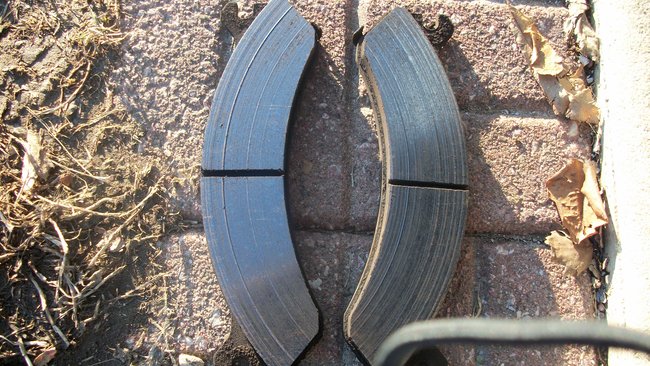

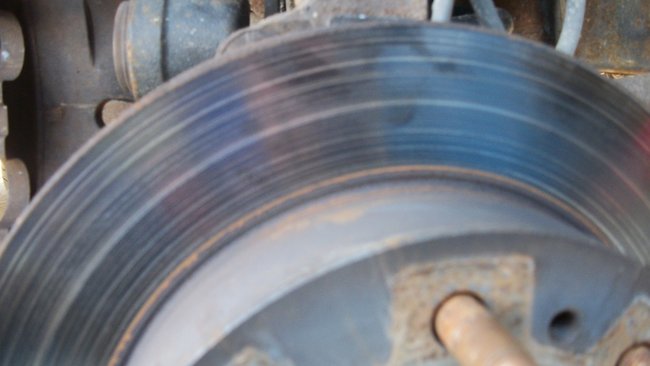

Here is the other side.
Monday, February 18th, 2019 AT 8:21 AM

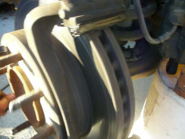

CONRADISH006
  • 53 POSTS

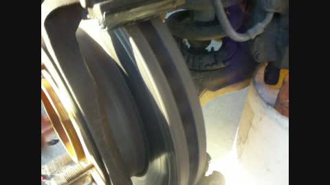

Also, this sound when turning the rotor is weird.
Monday, February 18th, 2019 AT 8:22 AM
SEVAG P
  • 406 POSTS
Hello
It seems the noise heard from the wheel hub bearing when turning the brake disc's.
Also brake disc's are badly scored that can be from bad brake pads quality.

I got Carquest Wherever Platinum Professional pads and rotors.
Wednesday, February 20th, 2019 AT 3:50 PM
KEN L
  • MASTER CERTIFIED MECHANIC
  • 55,512 POSTS
This is typical of ceramic brake pads I would change over to semi metallic. Ceramic pads last a long time but are sometimes squeaky grumbly. Here is a guide to help you get the job done correctly:
thanks for the pics and video. Please let us know what happens..
