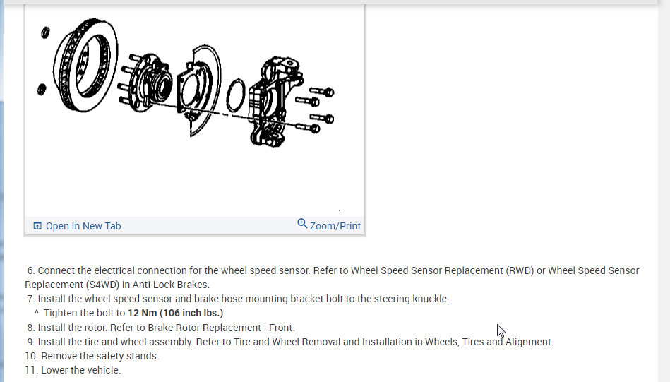

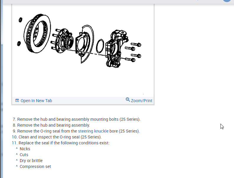

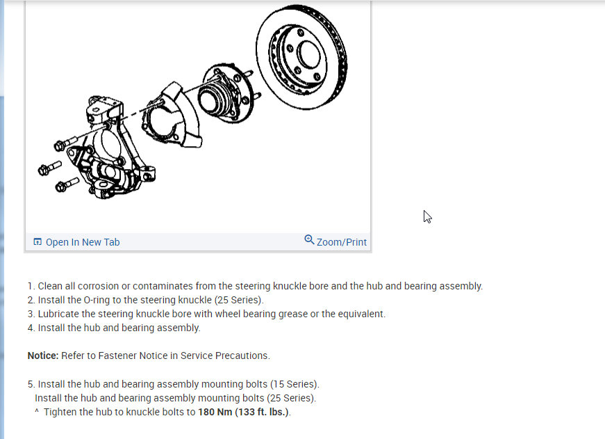

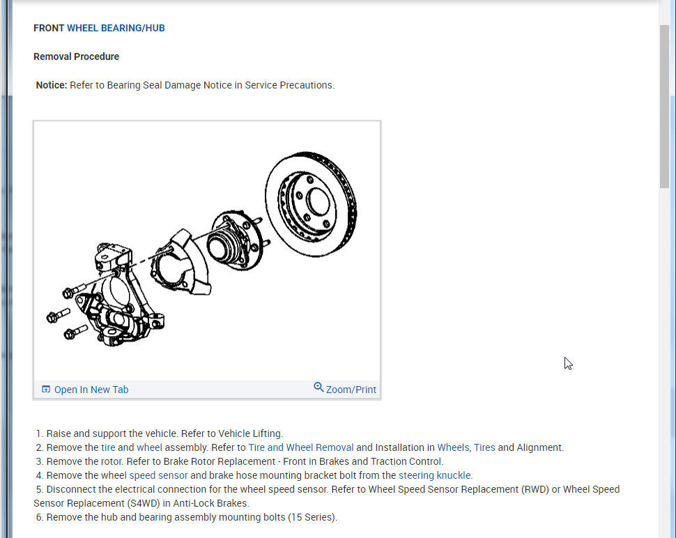

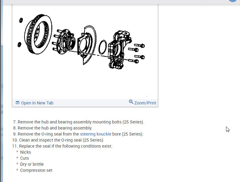

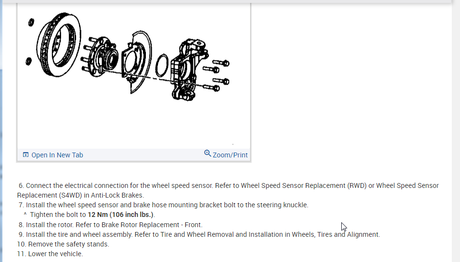

Lastly below is the process from the manual on how to replace these. Please let us know if you have questions. Thanks
