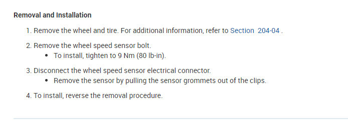

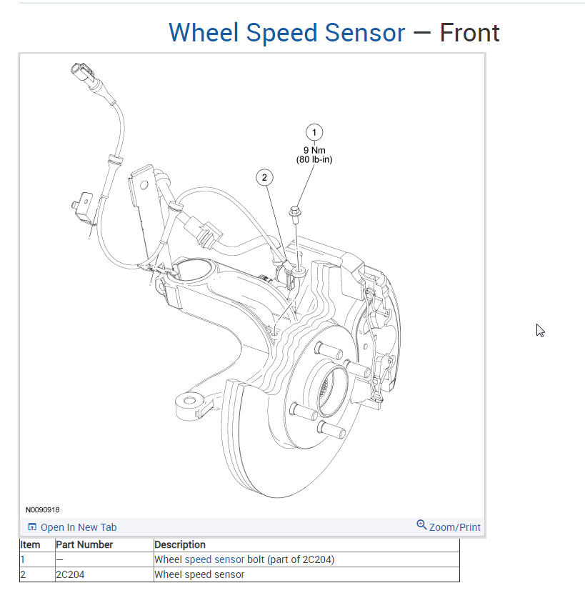

ABS Brake warning light is on telling me I need the front wheel speed sensor replaced.
Saturday, December 14th, 2019 AT 7:49 AM
2 Replies
MECHANIC
18,907 POSTS
If the wheel speed sensor has failed we need to make sure it is the sensor itself so here are some guides that will help with this:
https://www.2carpros.com/articles/abs-wheel-speed-sensor-test
If the sensor is the issue then here is a guide that will help with us:
https://www.2carpros.com/articles/how-to-replace-an-abs-wheel-speed-sensor
Below you will find the process from the manual on how to replace the speed sensor. Please let us know if you other questions. Thanks
