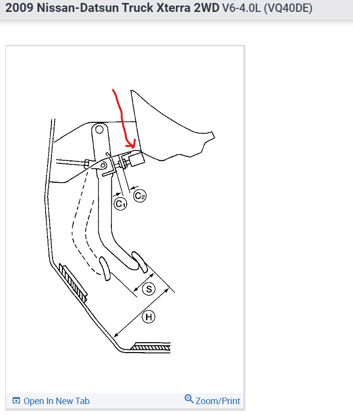

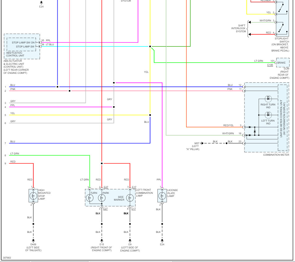

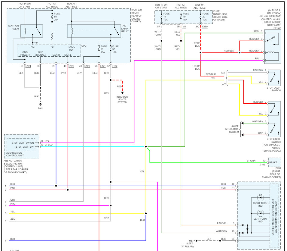

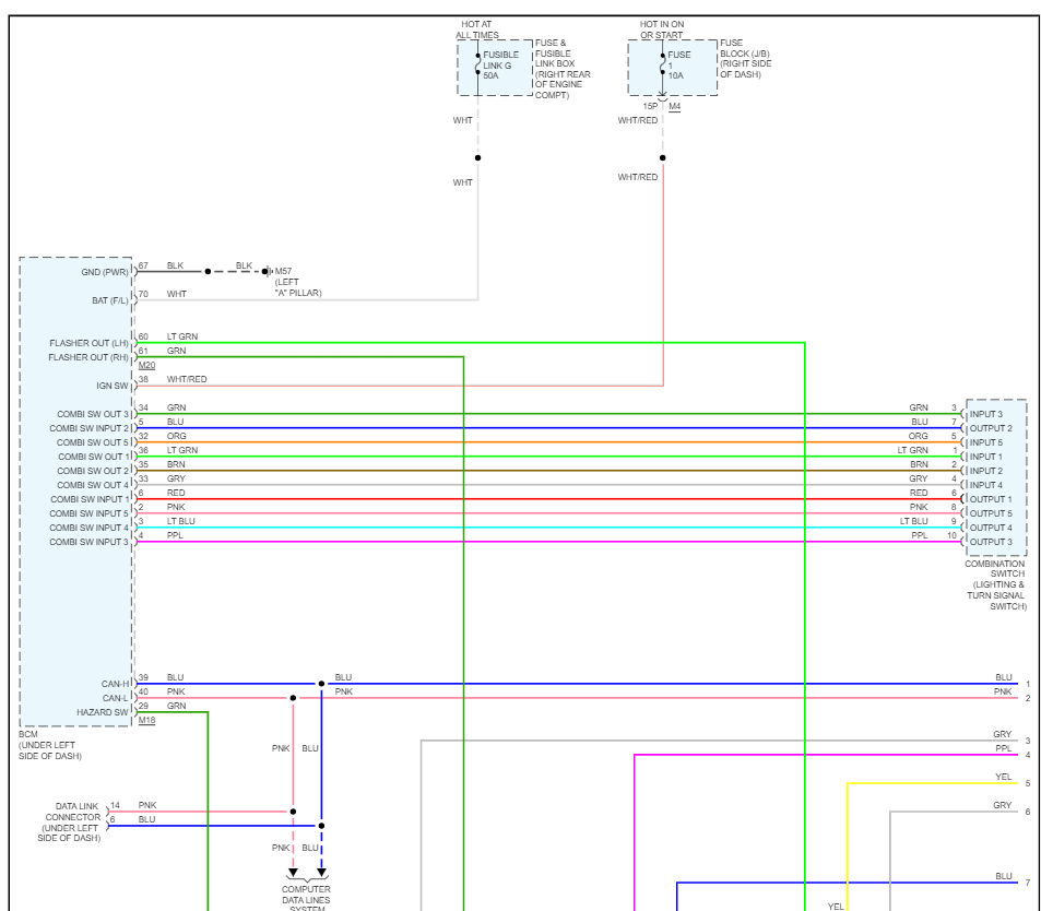

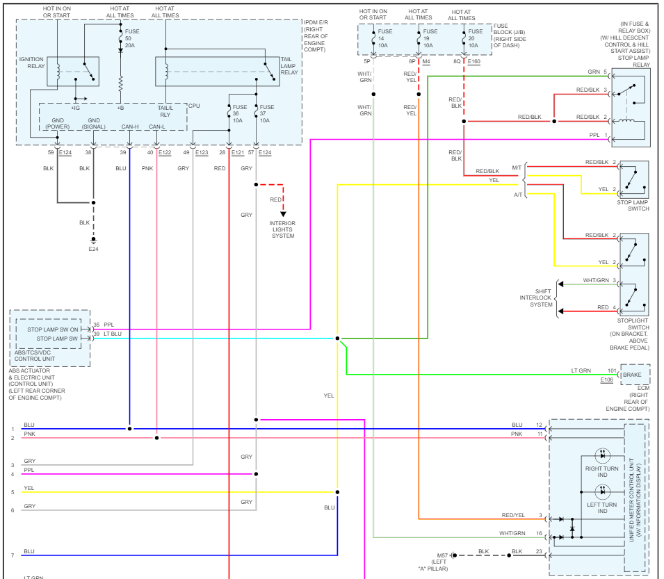

Do you have power at the fuse # 20 on the right side of the fuse panel?
This guide can help:
If so, please test through the brake light switch, here is the location in the images below, also please go over this guide as well:
https://www.2carpros.com/articles/brake-lights-not-working
Here are the brake light wiring diagrams so you can see how the system works. Check out the images (below). Please let us know what happens.

I haven’t tested the brake switch, and I believe that may be where the problem lies. Worst case scenario I will be replacing it as soon as possible.

On the brake light switch do you have power at the red/blk wire?
Test with the key on.
Tuesday, August 15th, 2023 AT 8:40 AM

Is fuse #20 good?
Wednesday, August 16th, 2023 AT 10:54 AM
SEAN D. ELDER
  • 12 POSTS
Yes, I've tested all of the fuses for continuity, and they are all giving tone.

With the key on and the brake pedal depressed do you have power at the yellow wire from the brake light switch?
Friday, August 18th, 2023 AT 9:46 AM
SEAN D. ELDER
  • 12 POSTS
Yes, I tested both fuse and cable with the key set to on. There is tone on both.

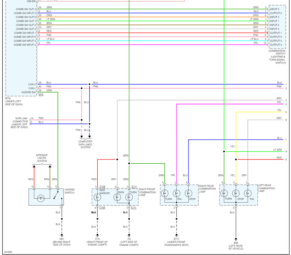

Okay, now with the brake pedal depressed check the yellow and blue wires back at the brake lights bulbs, are the bulbs good?
Monday, August 21st, 2023 AT 9:19 AM
SEAN D. ELDER
  • 12 POSTS
With the key set to on, and the brake depressed, the socket is giving tone. The wires are black and green to the brake light socket.

Okay, it sounds like the bulb ground is bad (black wire). I would use this guide to help check the bulb ground.
You will need to extend the lead on the tester or use a voltmeter.
Please go over these guides and get back to us.
Thursday, August 24th, 2023 AT 10:51 AM
SEAN D. ELDER
  • 12 POSTS
Okay, so something interesting has happened. I was testing the ground for the taillights and noticed that one of the lights on the back of the vehicle switched to functioning as a brake light when the brake is depressed. So now the top bar and the passenger side bottom light is functioning as a brake light. The actual brake lights are still only functional as turn and hazard lights. Does this mean I need to change the connectors?
