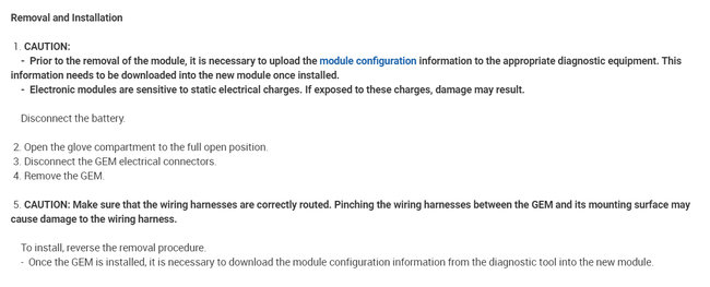

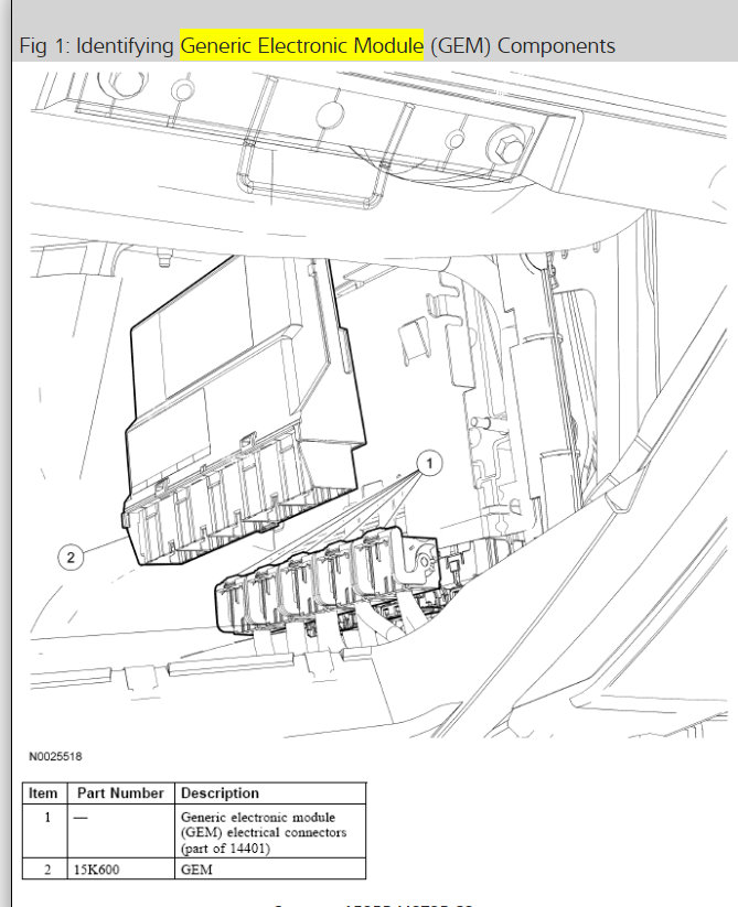

If the fuses are good it sounds like the GEM is out and needs to be replace. Here is the location and instructions on how to replace it below. Check out the diagrams (below). Please let us know what you find. We are interested to see what it is.

Looks like the hardest thing to do is to figure out how to afford a GEM change. I need to find someone that can remove the data and put it in the new one. Ford dealerships charge a ridiculous amount. If anyone has any suggestions, is this something I can do with the right software?

Not really, you must be able to transfer data. I have heard of some success trying a used unit but I cannot confirm if it will work 100% Try calling around to different independents to see what they can do and let me know.

What is that and where is it located?
+2
Wednesday, June 26th, 2019 AT 11:20 AM (Merged)
KHLOW2008
  • 41,814 POSTS
It is a small box for controlling a few functions and is located at right side A pillar.

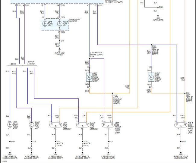

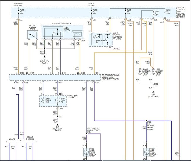

Heres a guide on turn signal problems, it will help
https://www.2carpros.com/articles/turn-signals-not-working-blinker
Attached below is the wiring diagrams for your turn signals

Do you have a diagram for the location of the relays in this. I cant find one anywhere. I have moved around the relays that are same and still nothing. Is there a seperate relay for hazards and turn signals

There is not a relay in the GEm for the turn signals or hazard flasher. There is only a fuse and it is good. Also have changed the turn signal switch on the column still no turn signals or flashers. Any help?

The GEM is a control unit by itself and do not have any relays that are detachable. You need to perform wiring and power supply checks. You mentioned getting the vehicle back from the shop. Waht was done at the shop and was problem there before sending it in?
Are you able to perform checks with a DVOM or test light?
