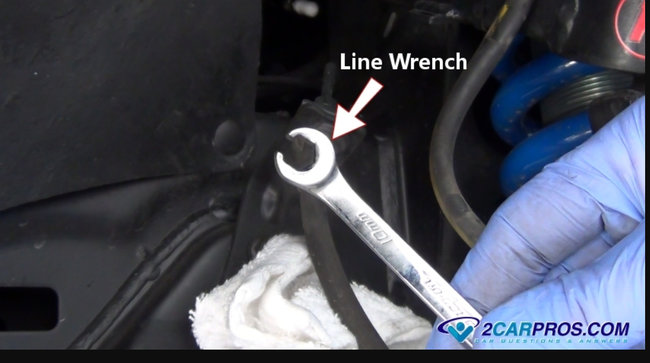

Try this. Safely lift the front of the vehicle. Have a helper apply the brakes. Once released, is the wheel still locked? If it is, open the bleeder on the brake caliper and see if the wheel can then be turned. I attached a pic below of the bleeder I am referring to.
If the wheel is locked and releases when you open the bleeder, the rubber hoses are bad and need replaced. If the wheel remains locked, then you have a caliper issue.

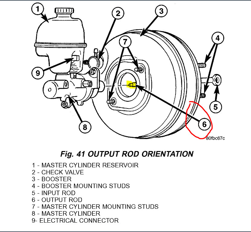

Interesting. If they released when you opened the bleeder, then we know the calipers aren't the issue. Go all the way back to the master cylinder and do the same thing to see if they release. If they do, the problem is between the pedal and MC.
If that is the case, I suspect that when you installed the new master cylinder, the push rod wasn't aligned properly into the rear of the master cylinder. If the brakes drag even slightly, they will heat up. When that happens, brake fluid expands and will cause them to get tighter and tighter until they lock.
I attached a pic of the rod I'm referring to. Take a look through these directions for MC replacement. See if you did what is explained. I circled the part I'm referring to in the second pic. I have a feeling this is what is wrong. However, if you try the last test I suggested, we will know if it is between the pedal and MC. I can't think of anywhere other it could be, but better to check.

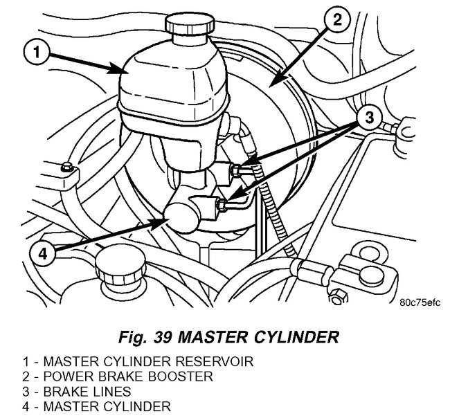

Vehicle Brakes and Traction Control Hydraulic System Brake Master Cylinder Service and Repair Procedures Master Cylinder Removal and Installation All Except Hydroboost
ALL EXCEPT HYDROBOOST
REMOVAL - ALL EXCEPT HYDROBOOST
pic 1
1. Remove the brake lines from the master cylinder.
2. Disconnect the electrical connector for the low fluid level.
3. Remove the mounting nuts from the master cylinder.
4. Remove the master cylinder.
NOTE: Using care remove the master cylinder directly forward in order not to dislodge the output rod from its seat inside the booster.

NOTE: Make sure the output rod of the brake booster is in position before mounting of the master cylinder "This position will enable the output rod to enter inside of the master cylinder plunger sleeve during installation". Proper position is obtained when the output rod is centered perpendicular to the master cylinder mounting hole.

Before you replace that caliper too, (they should always be replaced in pairs), crack the steel line nuts at the master cylinder to see if the brake releases. If it does not, open the left front bleeder screw. If it still doesn't release, the piston is sticking in the caliper. If it releases only at the bleeder screw, look for a metal anchor bracket in the middle of the rubber hose. It's very common for rust to build up inside the area that is crimped around the hose. That will constrict it and prevent fluid from returning to the master cylinder. Open that crimp up a little with a channel lock pliers.

Next time they lock up, park on a slight incline, shift to neutral, and crack open the steel lines at the master cylinder. If that lets them release, suspect contaminated brake fluid. If they do not release, open the bleeder screws. If that lets them release, suspect the rubber flex hoses are restricted.
