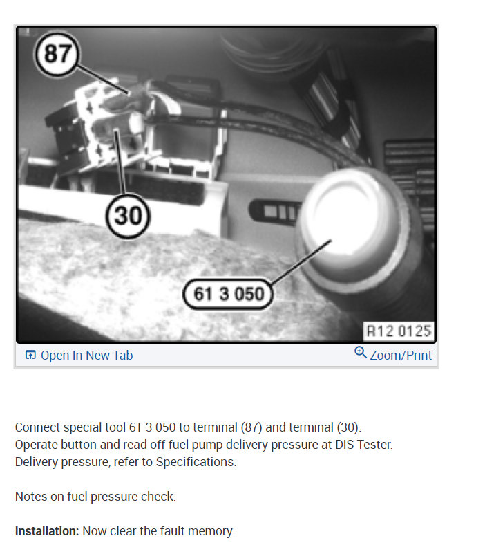

How much fuel pressure should build up on the fuel line when you turn the switch on for a 3.0i engine in a bmw x5 2005
Saturday, January 23rd, 2010 AT 3:13 AM
MECHANIC
75,992 POSTS

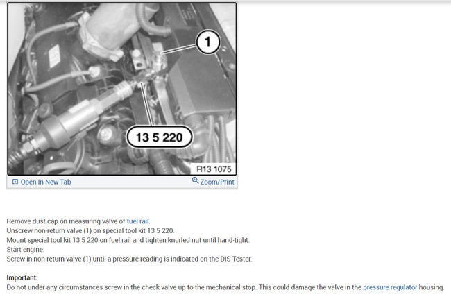

Here is a guide to help you check the fuel pressure with instructions in the diagrams below to show you how on your car.
Fuel Pump E53 / M54 / M62 / N62
Operating pressure .................... 3.5 bar
